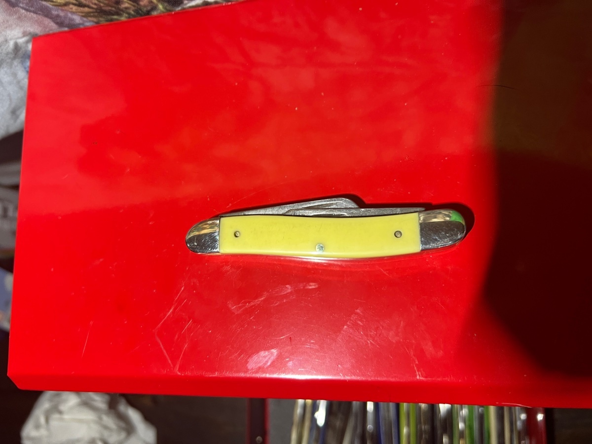

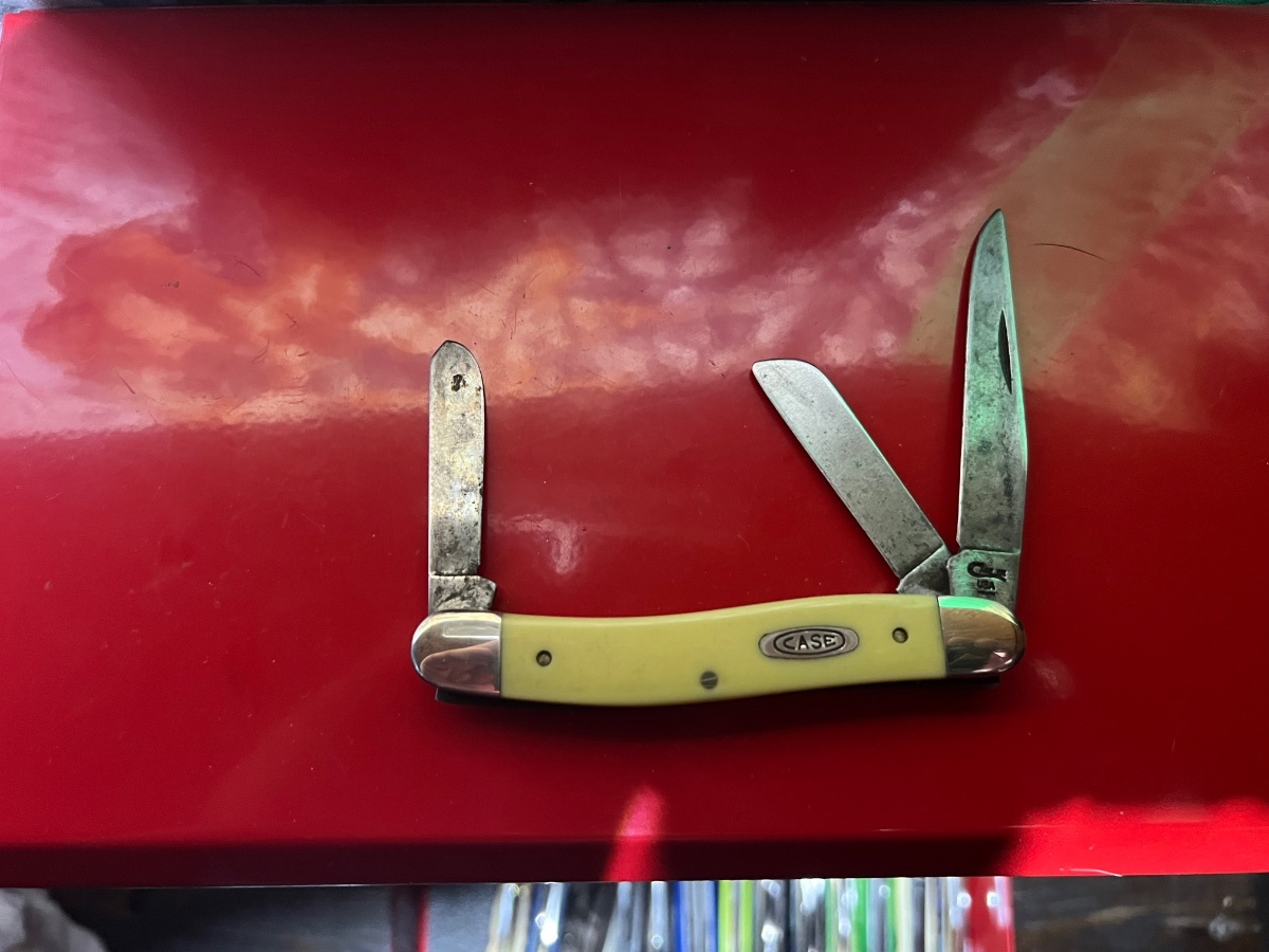

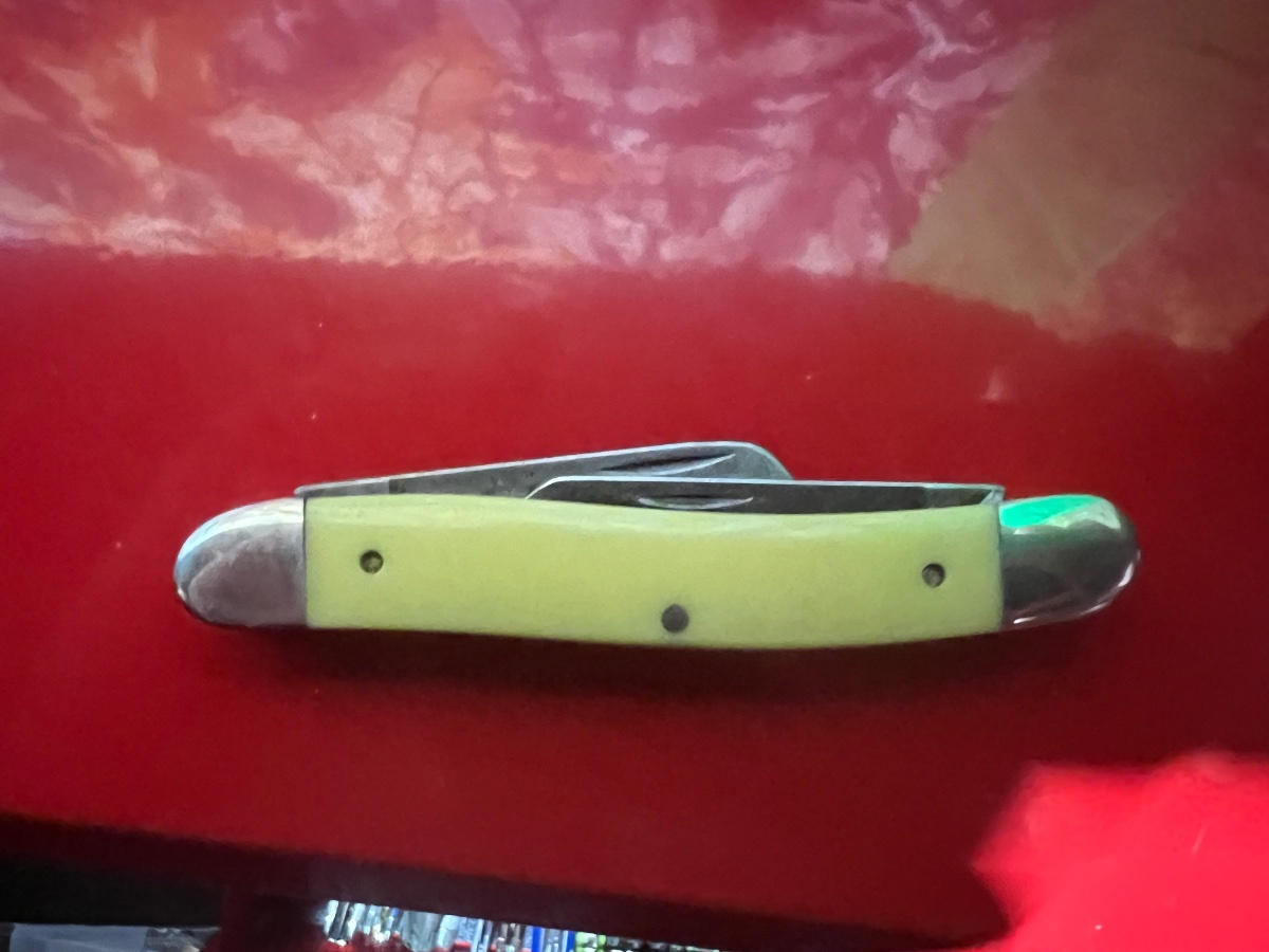

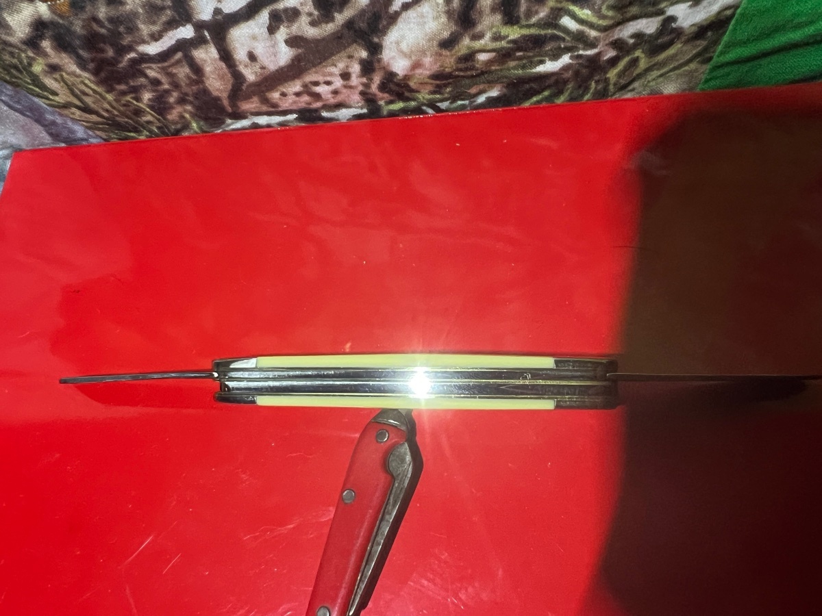

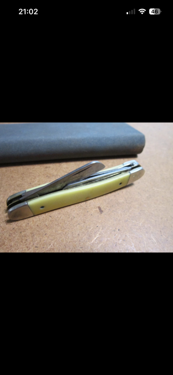

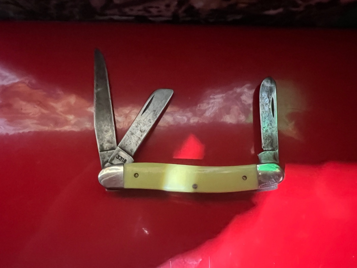

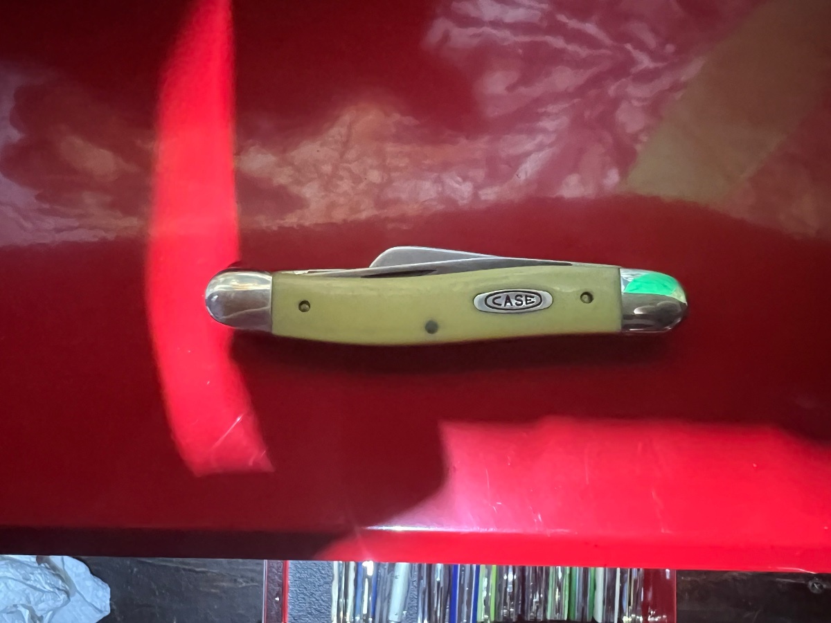

Hemmed and hawed about buying this knife off TripleF on here. Went in first of the week to buy it and it was gone. So i emailedTripleF and he said is was listed on eBay, he’d gotten a bid, so he removed it from here. Won it in eBay and spent my Friday night tuning it. It had blade rub on Sheepsfoot/Spey blades. So i adjust the angle slightly of both blades and noticed the main blade did t follow the liner in the middle. Didn't really have to adjust that one and it sits true in center of the blade well. So after i got the rub removed from blades, i cleaned springs, bladewell and decided to clean up the exterior, but leave the beautiful 30 year old patina on the blades. Wet sanded exterior of knife from 1,000- 4,000 grit, then 8,000&15,000, as thats what i had for sandpaper. First 3 photos was from listing, last photos are after tune up. Filed the Sheepsfoot kick as well, to lower nail nick to top of Spey blade. All 3 blades have great snap again.
