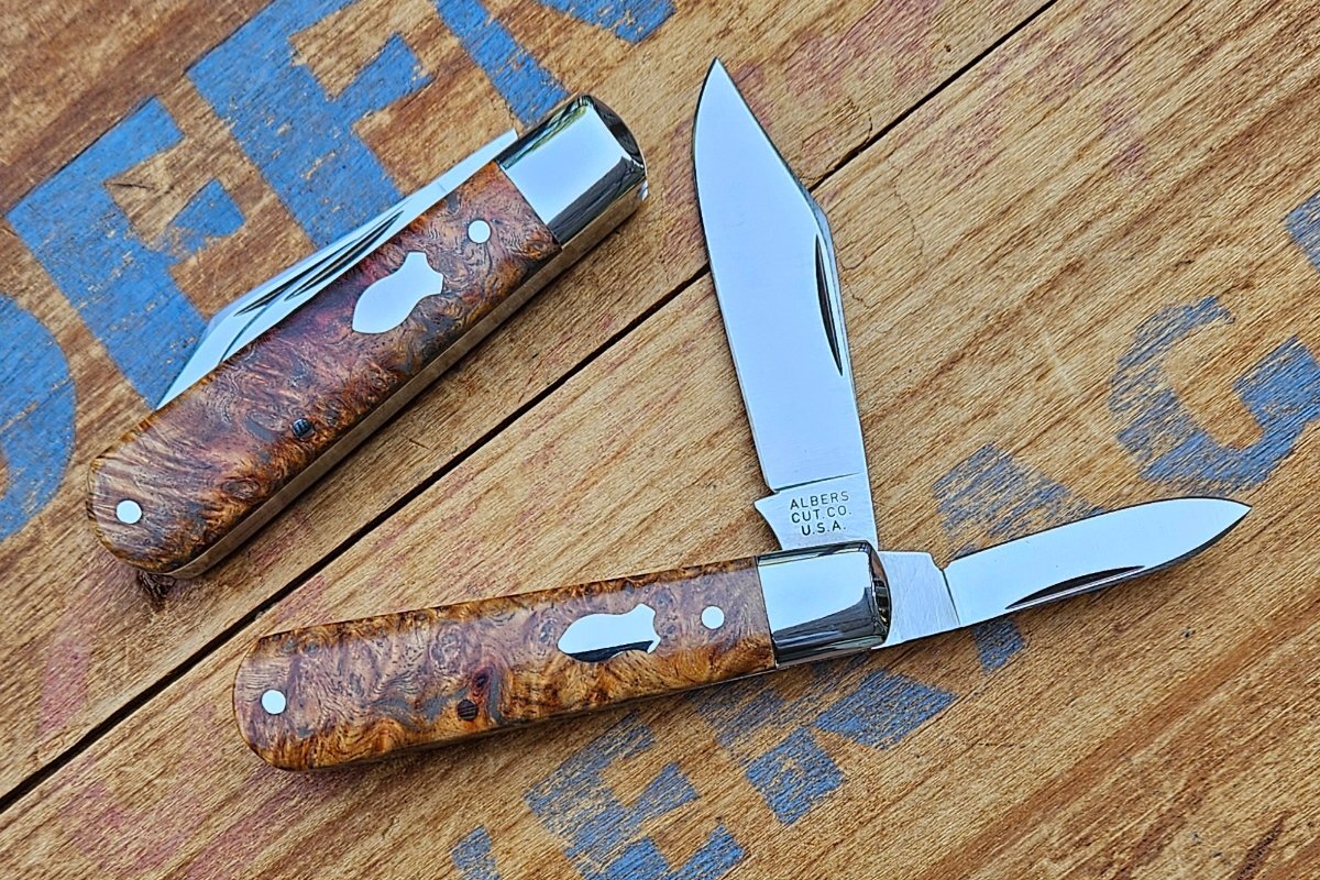

I'd 100% disagree with that as far as stainless steel. Carbon steel not so much but the subject here is stainless. I use 416 and 304. 304 is better for welding so I tend to use that more often. I spot weld, no solder but I should think solder would work fine, just need to prep the surface and remove any scale.

He refers to stainless steel as "ss" in the initial post. 410 is a martensitic stainless steel.
