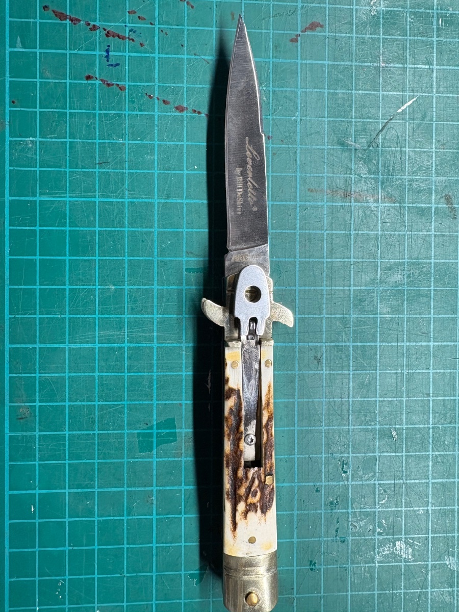

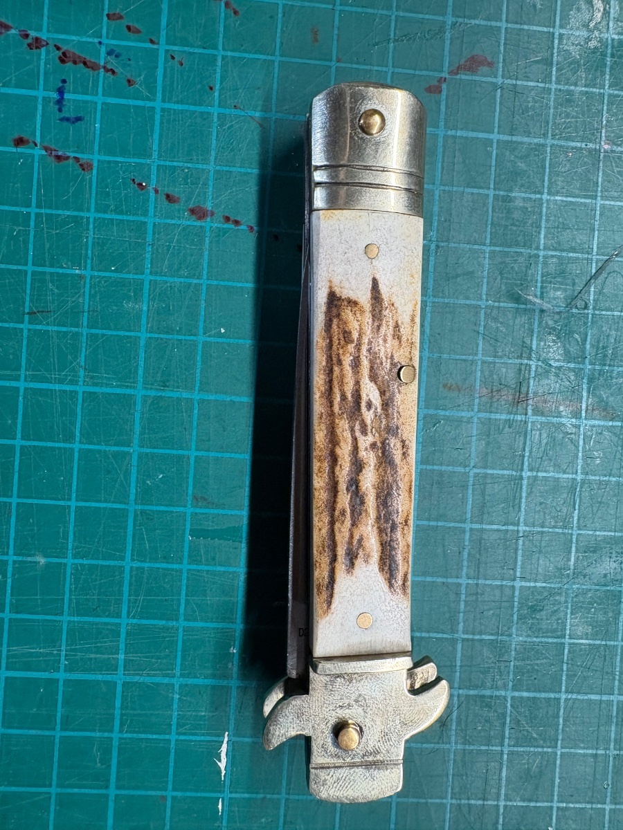

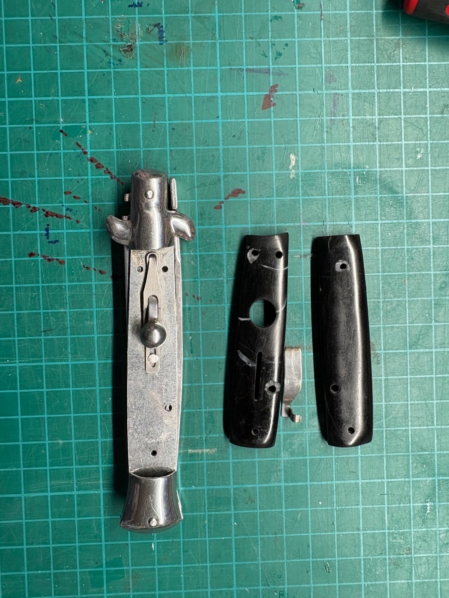

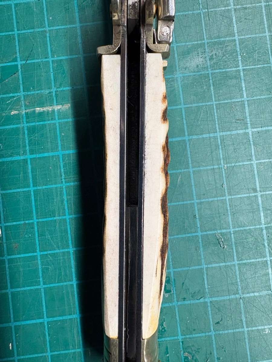

I have here a fake Chinese Bill DeShivs leverletto clone
I bought this off a friend who had it when he was younger and it has always been broken for as long as i have owned it
I’d like to kinda make it not a clone if that makes sense
I have a new blade for it that i made to remove the name and logo and trademarks
And I plan to make a new spring for it as that is the issue is the cheap Chinese spring
I also have new stag for the handles from a buck I got few years back
The stag on it is real believe it or not and has held up over the last 5-6 years I’ve owned it and it’s sat in my toolbox
But I’ve never actually had one of these apart minus kits
How would I go about removing the brass pins?
And what steel would be good for a new main spring?

Bill DeShivs is the guy to really answer such questions. But until he gets here, here's how I do it-
When I want to de-pin a knife, and I want to preserve the parts, I place a piece of masking tape with a little hole in it over the bolster, with the head of the pin in the hole in the tape. Then I carefully file down the head of the pin flush with the bolster/tape, then I use a pin punch and hammer to punch the pin through the other side, placing the knife across two pieces of wood with a cloth over them so that when I punch the pin down through one side the other end of the pin has room to exit (in the gap between the pieces of wood).
For switchblade spring steel I used 1095, as recommended by Bill DeShivs.

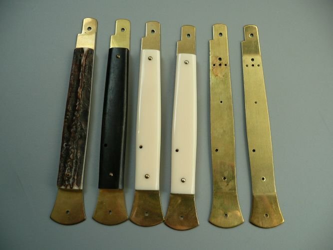

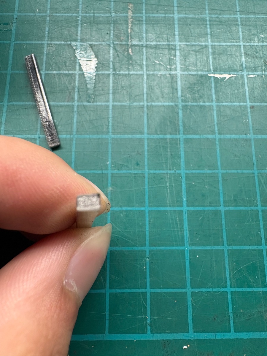

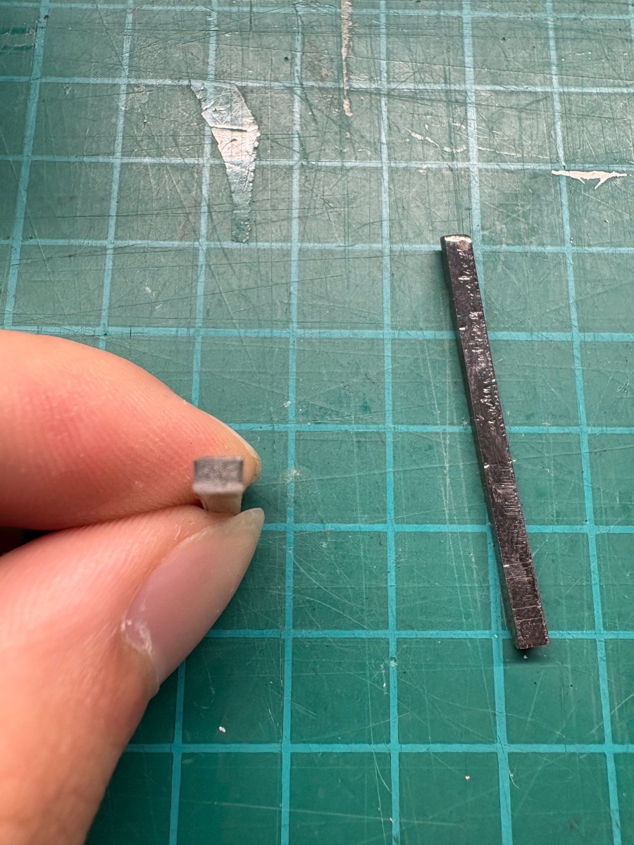

I've taken apart several pinned knives. Here are just a sample of some of the results-

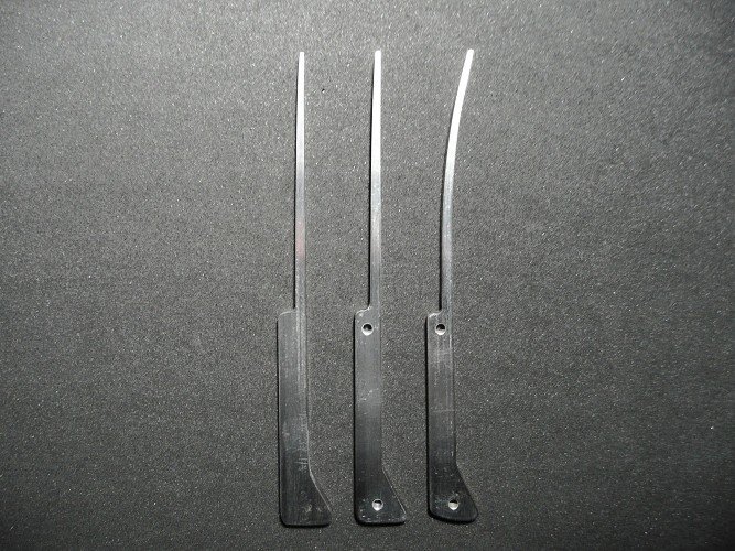

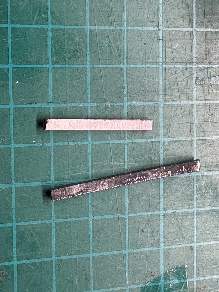

And I've made several springs, following the instructions of Bill DeShivs. Just a few here in a pic of work in progress-

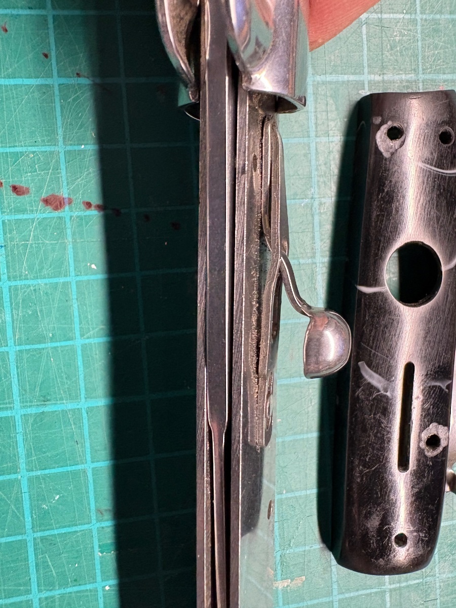

Here is a really cheap Chinese stiletto I bought ( I don’t own just Chinese junk) I just work with these because I don’t care if I ruin them you can see I used a Dremel because I don’t care about the crap resin and the reason I took this apart for was because I put a new safety in it and put new handles on it some nice oak wood ones sadly I didn’t take photos of that the knife I no longer own but I also did a blade swap on it too.

Re: How to Remove Brass Pins From Leverletto?
To make a new blade, you would have had to remove the pivot pin.
I file the heads off, drive the pins out and then polish the file marks out.
I also use a thin, sharp knife blade that I drive between the liners to sever the pins.

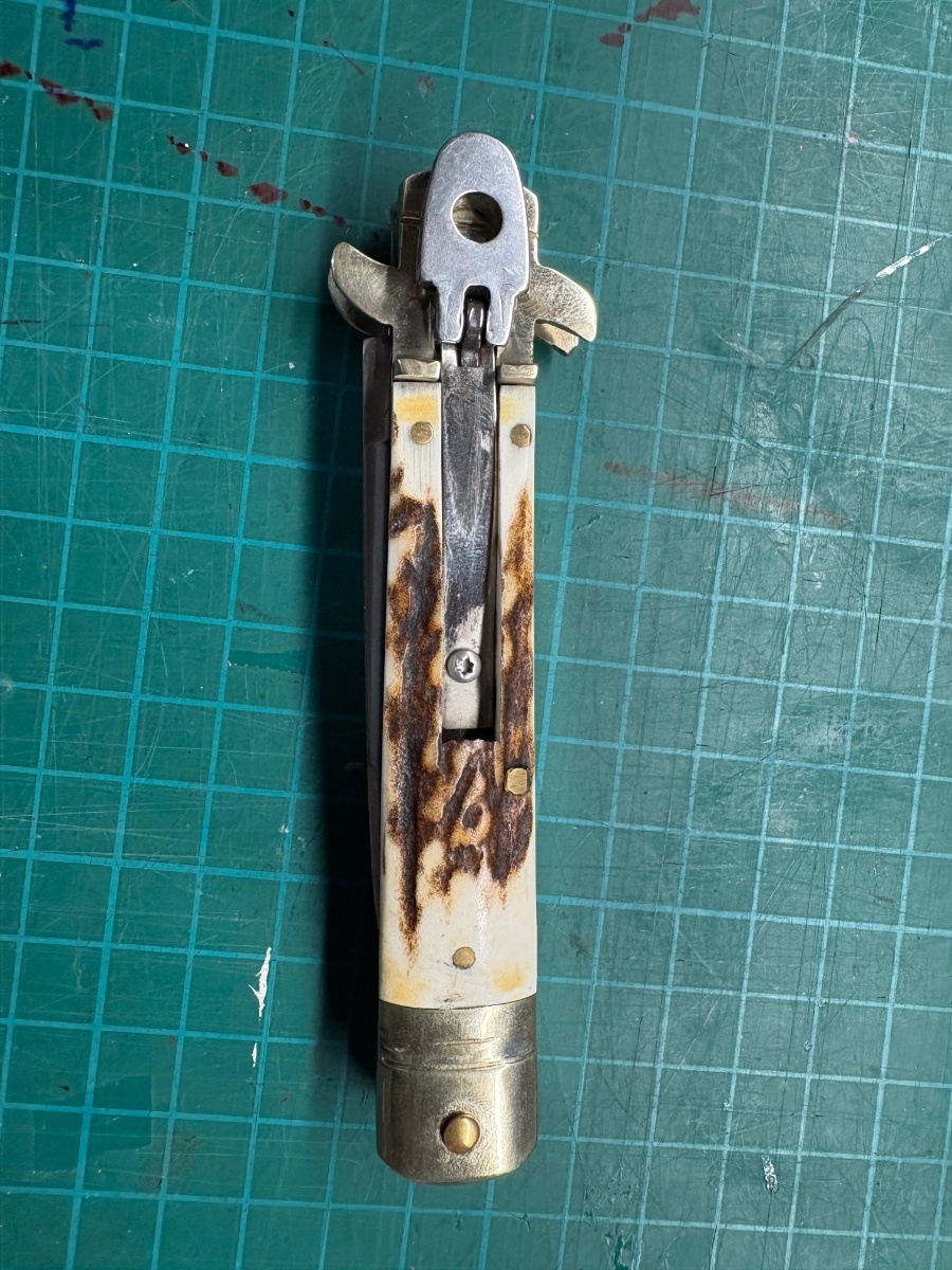

Thank you for the info the blade I made was completely from scratch via copying one from a parts knife the photos I posted are also before the blade swap. I have lots of cheap Chinese parts knives I use for templates and I make them out of better quality materials depending what I am doing if that makes sense

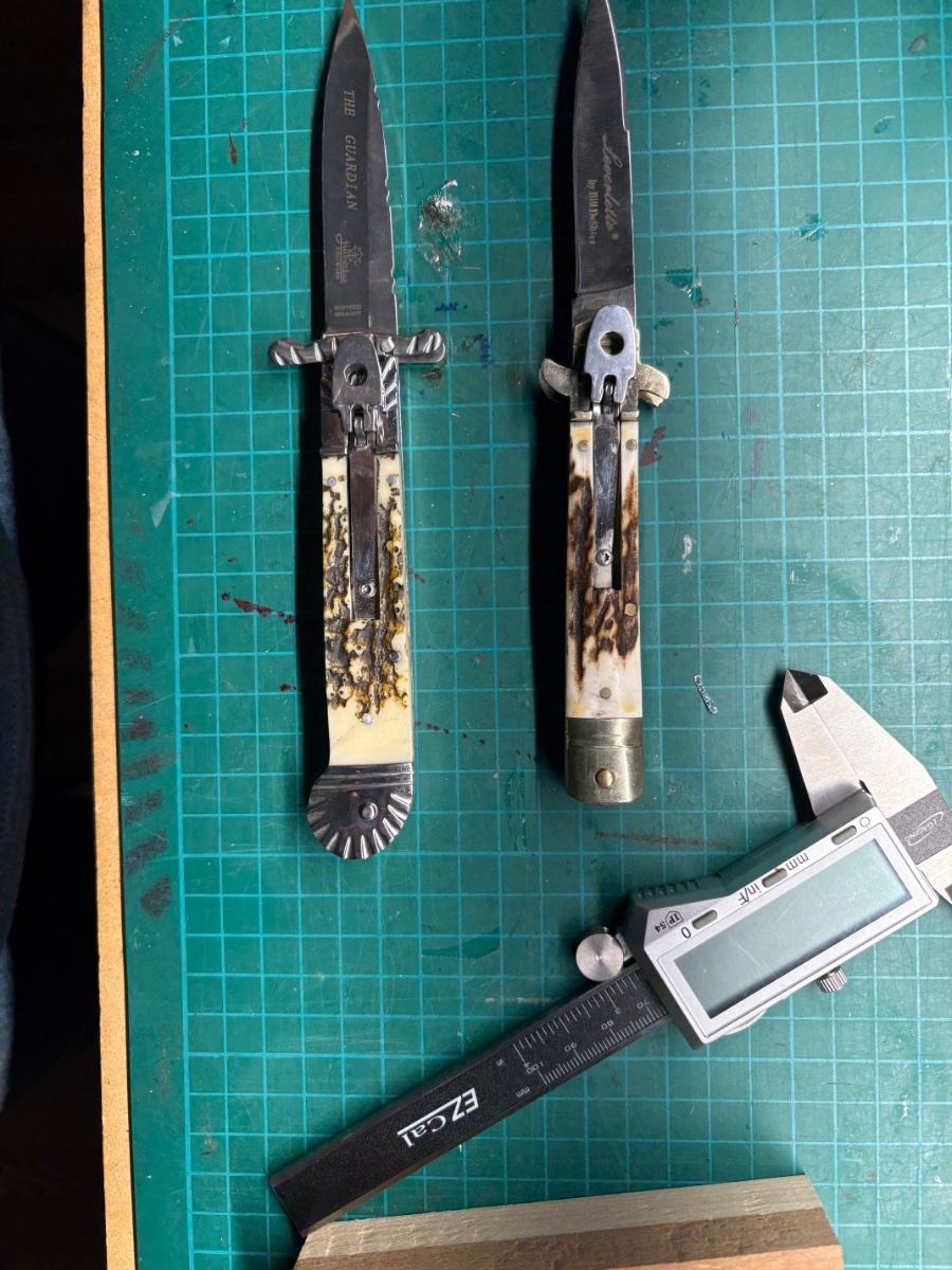

Thank you I plan to post photos soon I’m making handles out of cherry wood right now for another Chinese stiletto and than I’m gonna make some new springs for 2 Chinese leverlettos both are clones of expensive knives I plan to declone both of them and add my own twist too them
They are both getting new handles 1 is getting a new blade which I have made but not with me (top knife) the bottom one I’m gonna polish the blade up to get rid of the text it’s getting a wood handle the top knife is getting stag but from a buck I got the stag on it I plan to try to keep and reuse later.
My overall goal is to start making my own automatics or at least restore some despite limitations because of where I live

See I’ve always wondered if that’s what happened with the one knife I got off my friend I do still have the broken spring parts from them both and honestly these springs were horrible quality just looking at them
Pardon the photo quality
I’ve got this spring from another Chinese stiletto I switched out the spring on it wasn’t broken or anything but it was out of a stiletto I had for many years and I just felt it was time as I had already started doing handles and the buggered up safety on it and the Chinese spring held up for the years of abuse I put the thing through I never bent it never did any of that just played with it over the years.
I’ve never had bad luck with Chinese stiletto springs myself specifically with the rounded ones the only problems I have had are ones that are too short and fire really weak and sometimes they don’t engage and the blade snaps back on the top of my fingers. But I’ve never had issues with them breaking but the Chinese square springs I’ve had nothing but problems with in the ones I’ve been given and owned myself.
