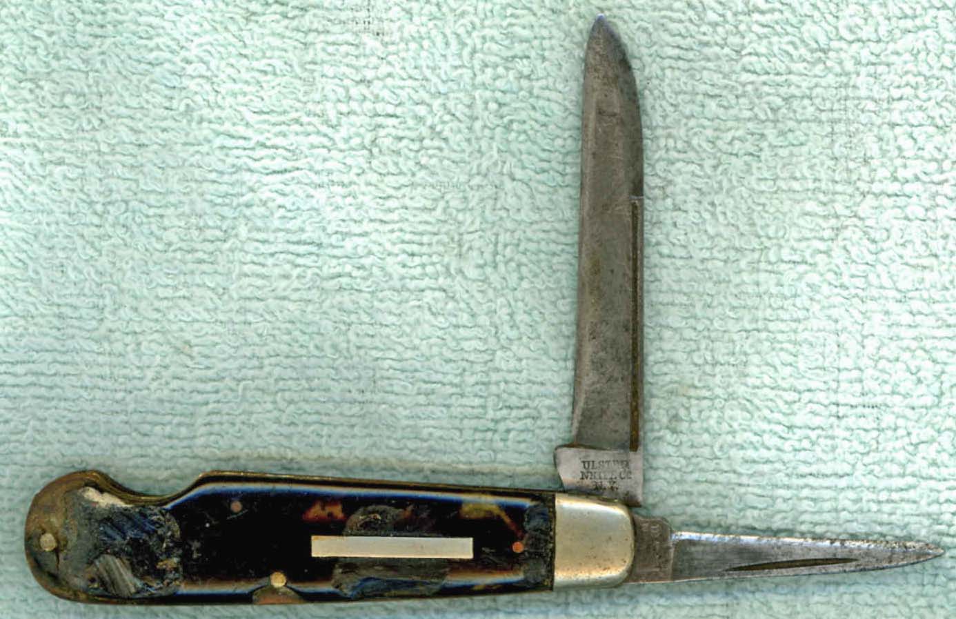

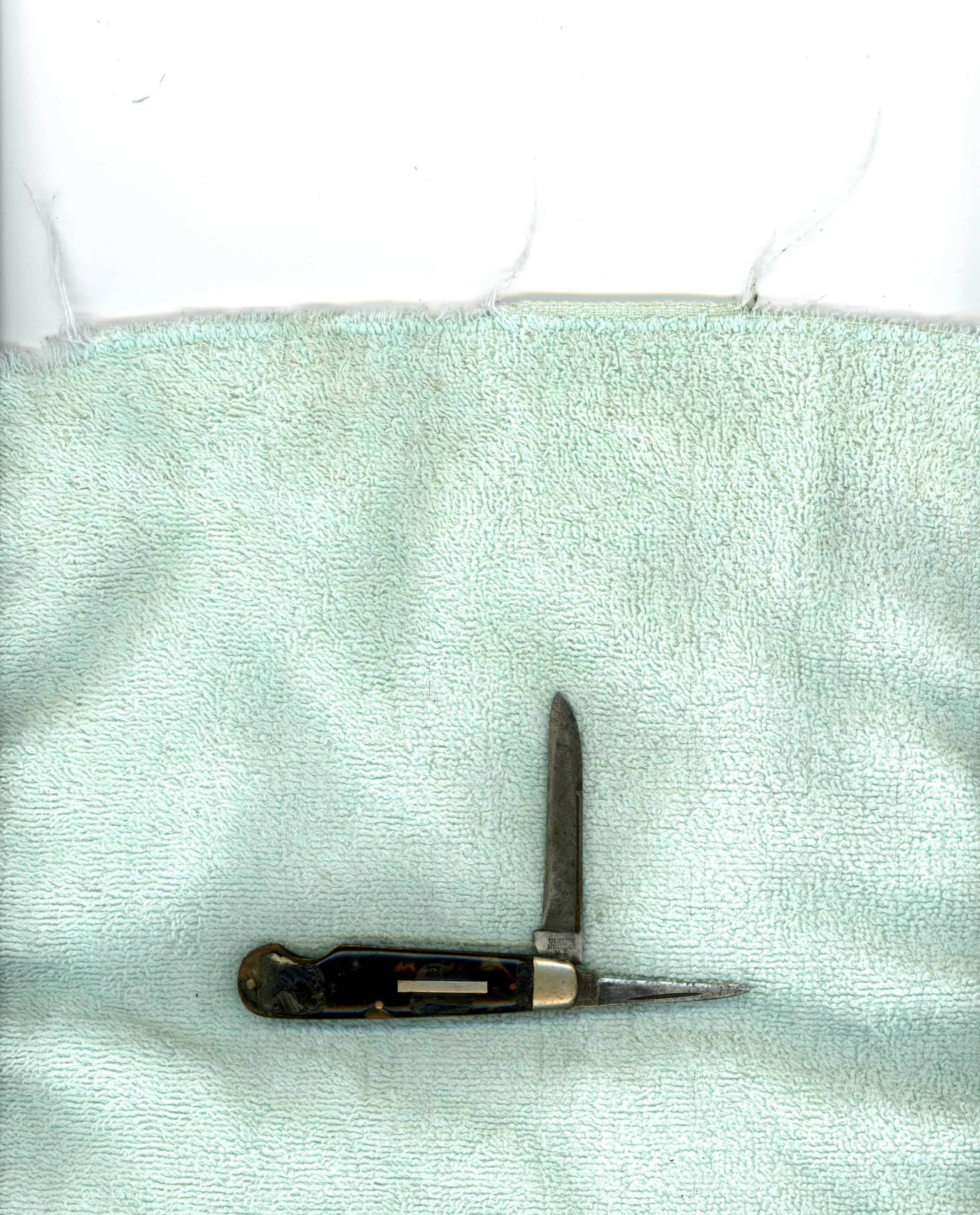

I have found it can be the way you lay your knife on the glass and the picture software you use.
I may have example on machine, If so I will add a photo/image or two asap.
You will have to experiment.
Lay your item in there with a towel over it, scan, crop on the blade or etch only, adjust resolution to at least 600, tang stamp 1200, then re-scan that area.
Try it two or three different positions, then make your scans, with an ink pen mark where you find that sweet spot on scanner. Be sure to crop the area you want.
If you can compress the images also, that would help folks like me on dial-up, load pictures faster.
I paid $49 for mine (HP 2400) and use the software that came with it. After rebate $0
9ball
Are you confused yet?

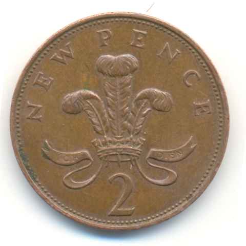

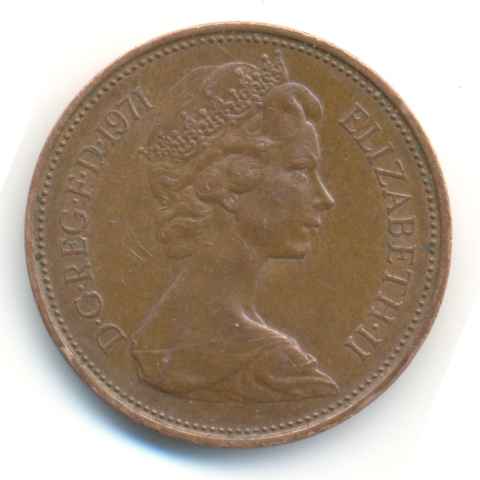

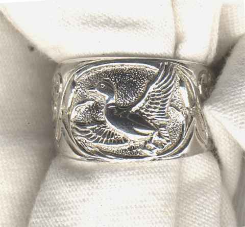

Here is a Winchester etch I scanned awhile back, a silver band, and coin also, much better that camera IMO.
9ball
- Attachments
- winchester3.jpg (5.47 KiB) Viewed 4683 times
- qq1.jpg (21.8 KiB) Viewed 4681 times
- 6b.jpg (14.5 KiB) Viewed 4672 times

Scanning cutlery handles of natural material is not problem, you will always have the problem with the etch or tang stamp and some man-made materials.
You will not have to worry about the resolution for the first scan, could be set at a 100 or even less. Just be sure to crop/adjust size when you make that second pass. At 600, it may sound like a deep hum on a blade etch.
After you do it a couple of times and moving it around, when the etch starts looking clear that will be the image you want to work with. You will have to do it a couple of times. Post the results or PM them to me when you get in the ball park, if you need help.
I have found that if I use the Sharpness control too high, it makes the etch or tang stamp look fake or maybe just too good. That is where your software comes in.
Those folks over on eBay will tell you to get PhotoPro/PhotoShop or some high end thing with lots of gizmos. Just more stuff too confuse you. MS "Picture It" will work just fine if you feel you need to spend some extra money, I mean Pence. Some times I hold the item up next to the screen to get it just right.
I have been taking close-up pictures long before EduKated TeeVee's and Hi Tech Pitcher boxes, still use my 35mm SLR for portaits and landscapes.
I can always scan those and adjust if needed and have prints made for pennies.
9ball
9ball
- Attachments
- 6a.jpg (13.41 KiB) Viewed 4644 times
My Oath as an American Army Soldier did not come with an expiration date.

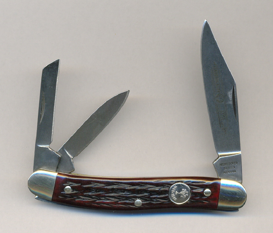

- orvet
- Posts: 19901
I use an Epson 3710 Photo scanner. For software I use Adobe Photoshop CS2 (the full professional version) or Photoshop Elements 4.0. CS2 will do a lot more things, but I haven't used it too much yet. Elements 4.0 will usually do everything I need.
Here are two scans, before Photoshop Elements & after. As you can see the software can bring out a lot more color in the handle. You can also adjust it to see the etching on a blade better, though sometimes it throws the color off.
- Attachments
- File0470.jpg (766.29 KiB) Viewed 4453 times
- ULSTER NKIFE.jpg (158.47 KiB) Viewed 4453 times
