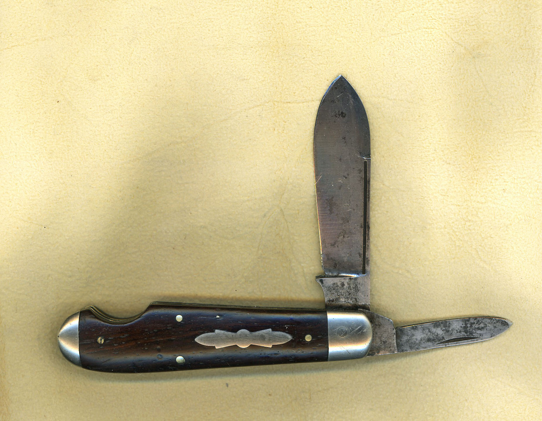

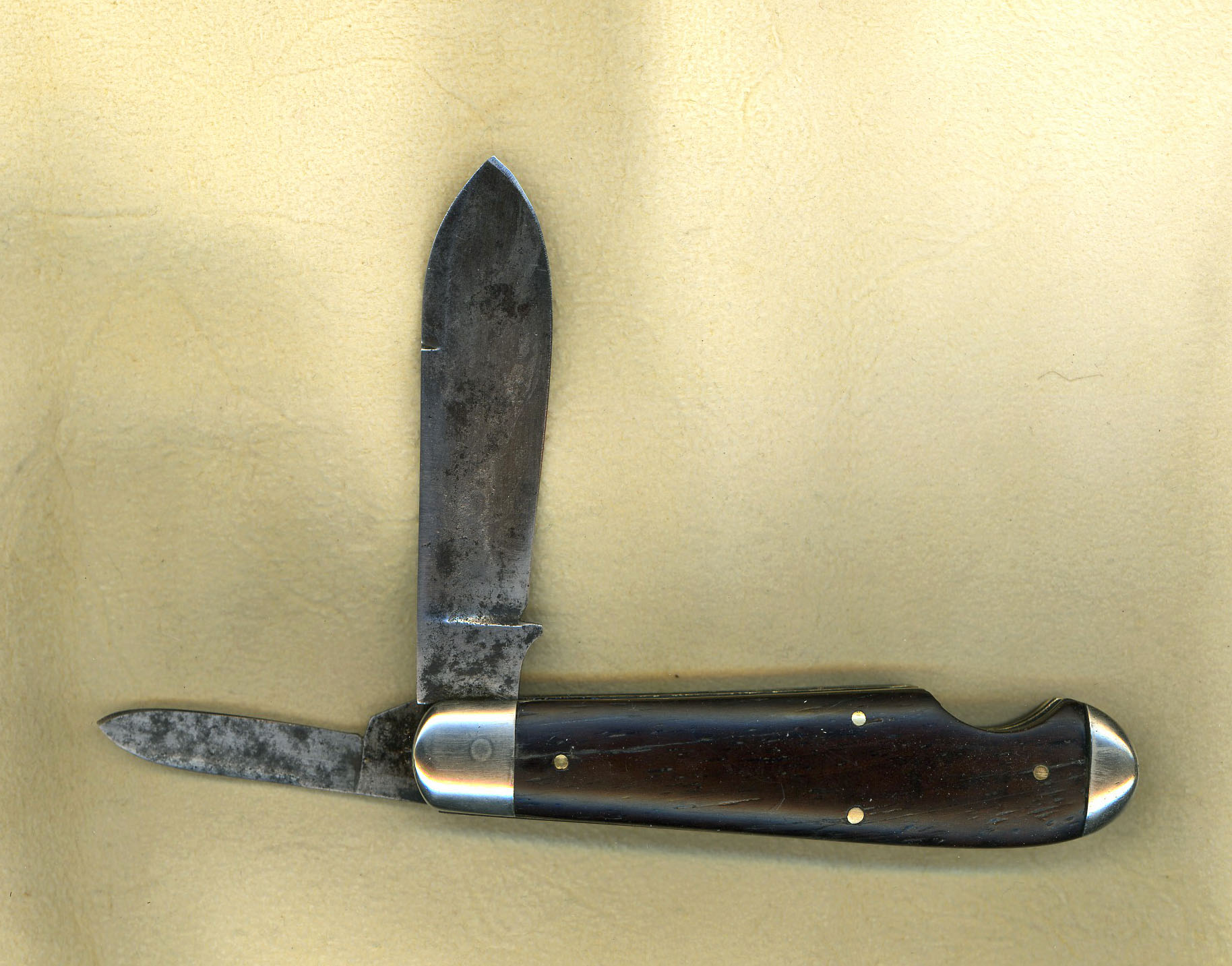

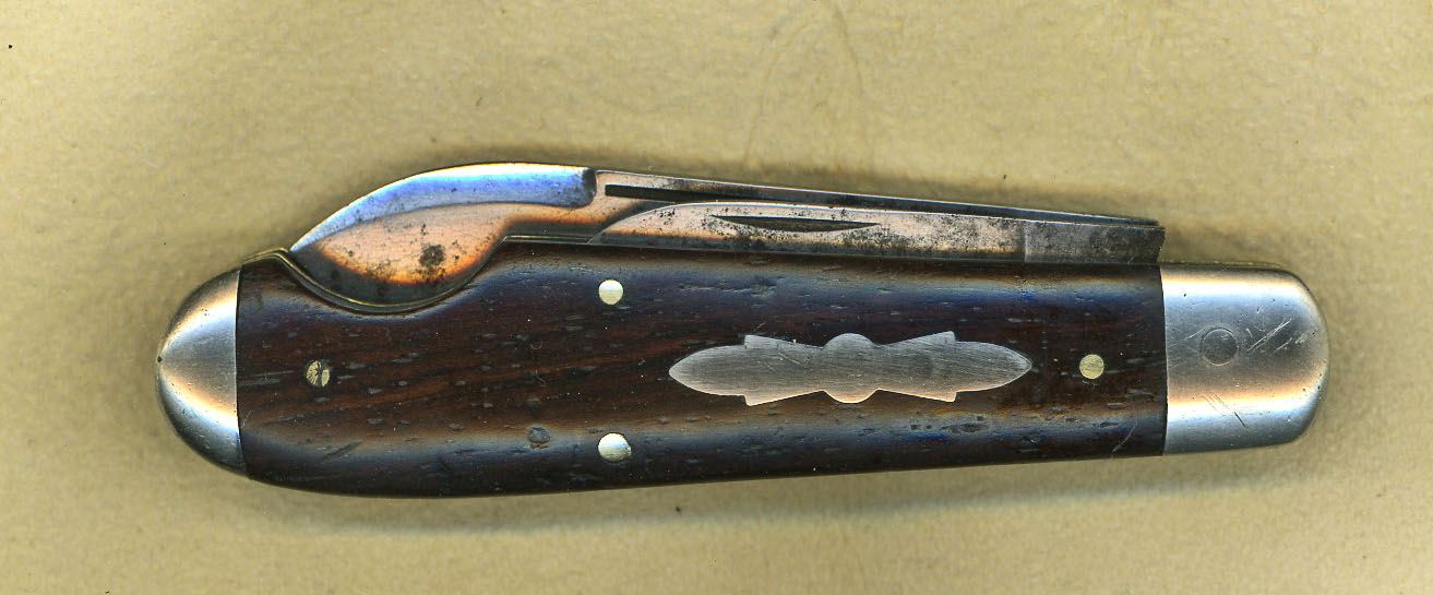

Here is a Schrade Cut Co I repaired for a customer in Australia.
It is such a beautiful example I decided I would post it here where the Schrade crazies (like me) hang out! :mrgreen:
I didn't take a before pic, but the pen blade was broken off and there were chips out of the main blade.
There was also a crack in the pile side scale.
I epoxied the crack, reprofiled the pen blade and cleaned up the main blade.
I cleaned the rust & gunk off the blades and polished the scales with carnauba wax.
I have a soft spot in my heart for these old easy openers, especially the ones with ebony handles.
I hope you enjoy it.

The chips were about about 1/8" to 3/16" deep.
I was a bit concerned about keeping the shape and taking so much metal off the blade.
But that old knife had a PHAT spear blade. I think the blade was pretty much full, except for the chips.
With a bit of care I was able to retain the shape & still get the chips out.
