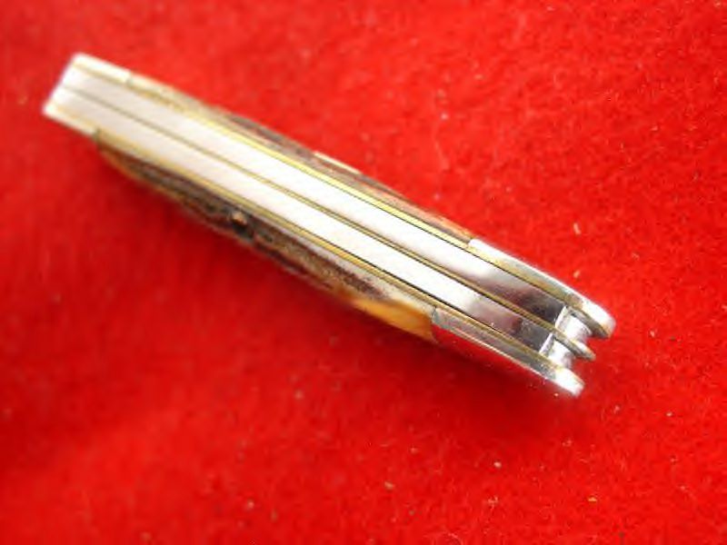

Seller lists the knife at 3.75". It's listed in Sargents as 3 5/8".

To me the whole knife just looks too "new"...except for the CASE shield which looks worn. I would have to examine the pics more closely. But a lot of things about it scream either "fake" or "rework". The tang stamps for one thing do not look authentic to me but I would be hard pressed to explain exactly why. Pics are poor anyway with that red background.

The blades and backsprings look like stainless steel ::nod::

If you look closely at the pivot pin on the front handle you will see that handle shows where a previous pin has been spun and the alignment didn't match up with the current pin . I agree that the blades look like stainless steel and we must also consider this sellers track record . Someone went to great lengths to perpetrate this fraud , however , if they are successful and get about one half of the book value I guess that they will feel that their time was well spent !

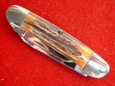

::shrug:: click on pic should enlarge
Is this the pin
Is this the pin

You can see a gap around this center pin also , but it is much more obvious on the front handle where the spinner cut away some of the stag on the original pinning operation . This pic also makes it easier to see a gap on one edge where the handle butts up against the bolster .
