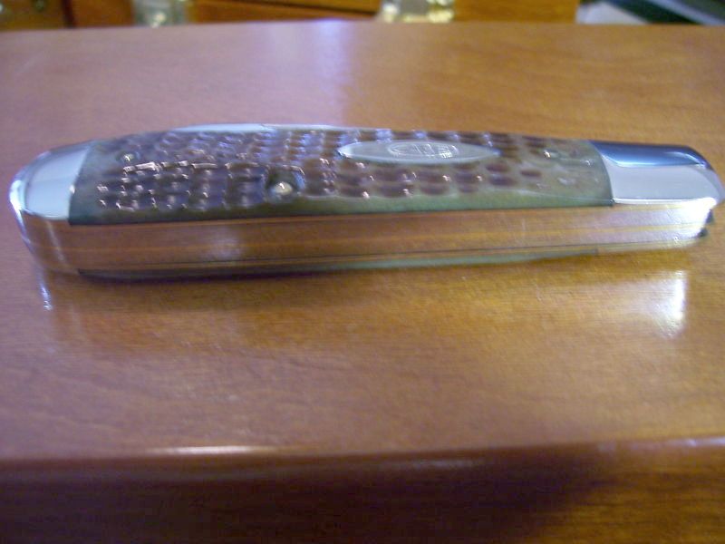

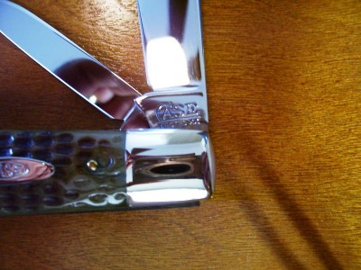

The tang has not been shaved.
The blades fit nicely between the liners, see the overhead shot.
It has been heavily buffed. Just look at this picture of the front bolsters.
They are paper thin on the edge
