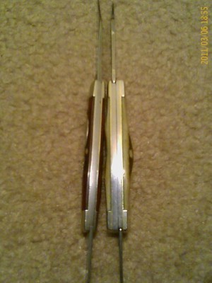

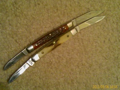

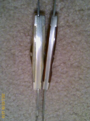

knifemaker3 wrote:When I enlarged the bottom pic of your knife I see the very same thing as what I'm describing on my Case knives. From the pic you post it looks like the very top edges of the runup have been rounded over, probably from polishing. This makes the fit at the runup to the spring have a rounded look instead of the square edges it should have. A very simple fix. I have looked at all of the different knives I have in my display case at the store and the American made Bucks, Queen, GEC, all fit perfect in the runup area.
I know Case can do much better if they just would. All the shine in the world can't hide the fact that this is poor workmanship on their part.
I thought I was mistaken on the 1 Crandell series Case I have in a saddlehorn pattern, but alas, 1 blade met perfect but the other was the typical rounded Case runup. ::dang::
I will admit that I am seeing a little improvement in what Case has been turning out lately. Just wish they could finally get it right for a change.
After looking at 2 different '33 pattern Case knives that are years apart, I understand what knifemaker3 is saying and I hope these pictures will help illustrate. Look at how the "run up" is rounded off in the 2000 Case 5233 as opposed to the Case XX 6233.
Does it hurt functionality? Probably not. Does it look good? You be the judge.
Case XX 6233 & 2000 Case 5233
Case XX 6233 & Case 2000 5233 with rounded Run Up
2000 Case 5233 with rounded Run Up and Case XX 6233
