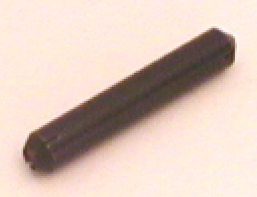

here is a pin spinner. each end is a different size to fit small and large pins. the bottom of the pivot pin rests in a small fixed cup that just fits the pin. the spinner is chucked in and pressure is applied with the drill press to round, compress and set the pin.

adrian a. harris' book covers spinning and has a good pic and how to section. better than kelley's. copyrights prevent showing these pics. i consider both of these books to be invaluable to the novice cutler(me). the trick is to put resistance on the pin equal to the cutting tool(spinner). compression closes the gaps just as peening does. care must be taken, not to put so much pressure from the spinner as to dig in to the scales. the spinner works on ns but takes a little longer. anybody else know of anything i've missed or am doing incorrectly, jump in. i am willing to learn. especially from my own mistakes. also, if this interests you jump in. not a bad skill to practice.
