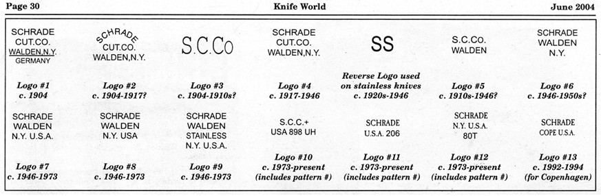

For those that know (not me) there is more to dating a knife than just the tang stamp. Pictures please.
This chart may give you a ballpark idea.

Without seeing a picture the only thing I can say for sure is the Schrade Walden tang stamp was used from 1947-1973.
That is as close as I would feel comfortable in dating it without seeing pictures of the knife, handles and the tang stamp.

Re: Schrade marlin spike model
Thanks, don't know if it matters but the word stainless is under N.Y. U.S.A. on the knife blade.Just a different stamp as the old one wore out.
