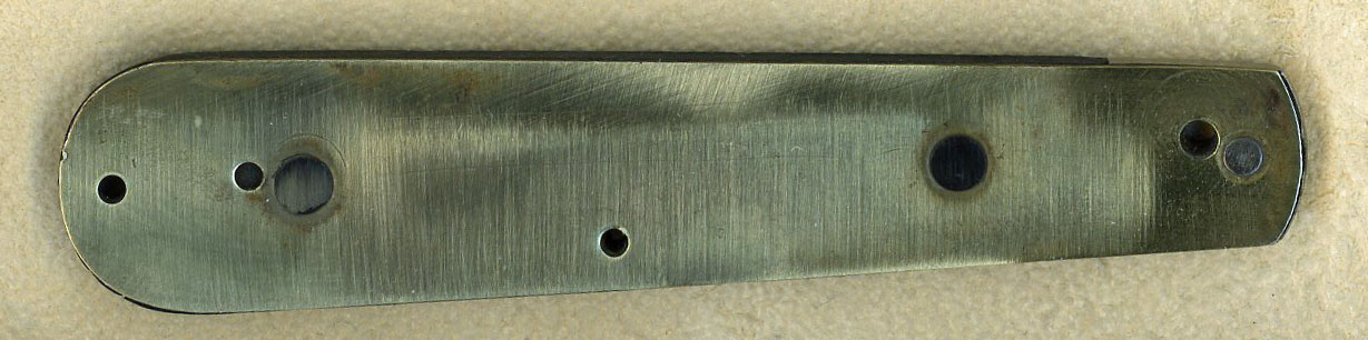

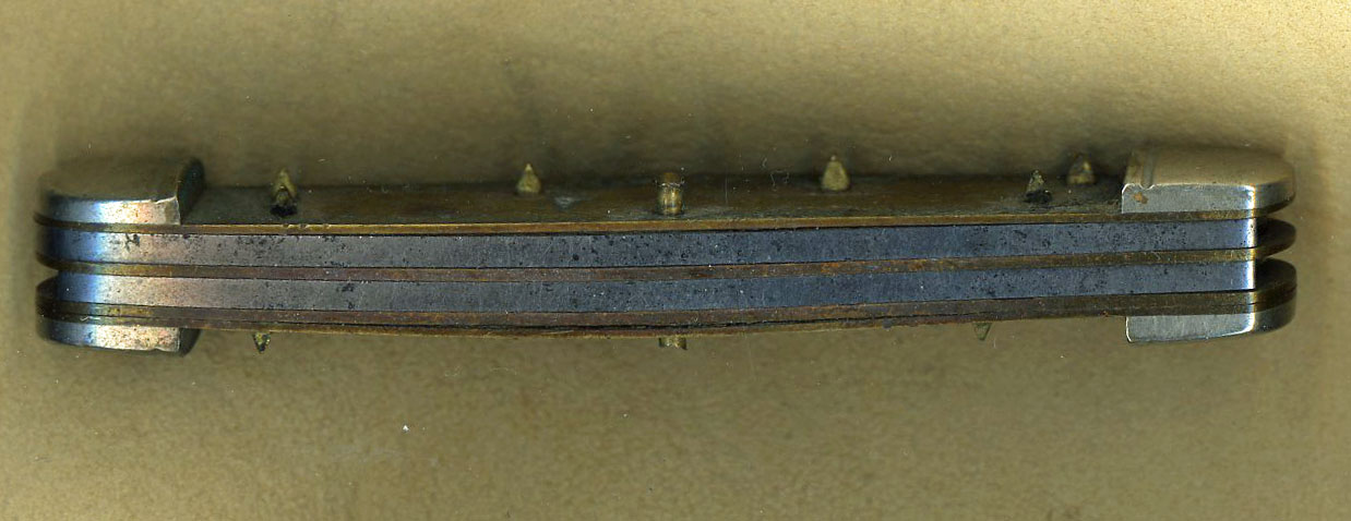

I just figured out an easy way to tell the difference between delrin and bone. Thanks to the fact that Case uses a "6" to denote both, I've found it hard at times to tell the difference. I recall a few members telling about their methods in a post a few months back but I think this is fool-proof. The key to differentiating the two lies not on the outside but on the inside of the liners.
I took 2 pictures using my camera and a flashlight to capture what I'm talking about. The first picture shows a pinned bone handle and you can see the inside of the pin (to right of the blades) where it comes through the brass liner. The second picture shows how the delrin is melt-pinned (to the left of the blades) to the brass liner.
I only have 2 delrin handled Case knives and they both have the delrin melt-pinned to the inside of the liners. Let me know if you find any exceptions and remember I'm somewhat of a newbie so this is like inventing the wheel to me! :lol: :shock:
pinned bone handle
pinned bone handle
melt-pinned delrin handle

1967redrider wrote:I just figured out an easy way to tell the difference between delrin and bone. Thanks to the fact that Case uses a "6" to denote both, I've found it hard at times to tell the difference. I recall a few members telling about their methods in a post a few months back but I think this is fool-proof. The key to differentiating the two lies not on the outside but on the inside of the liners.
I have never seen a Case pocket knife that had delrin handles melt-pinned to the liners. Can you elaborate and also show a picture of the entire knife that has melt-pinned handles - including the tang stamp? Much appreciated. My guess is that it was an 048 pattern made by Camillus for Case.
I have seen Camillus and other knives made that way but not Case. And I can say that I have looked at ...a few...Case knives in my life.

knifeaholic wrote:I have never seen a Case pocket knife that had delrin handles melt-pinned to the liners. Can you elaborate and also show a picture of the entire knife that has melt-pinned handles - including the tang stamp? Much appreciated. My guess is that it was an 048 pattern made by Camillus for Case.
Steve,
They are a 7 Dot 62048 and a 4 Dot 640045 R, both from the 1970's. They are the only 2 Case delrins I have, thought maybe I was on to something? ::shrug::
Steve,
-John
John;
You are on to something and thank you for pointing these out. Now I recall that I have seen some 048 patterns with the melt-pinned construction. These were made by Camillus for Case. In the 70's Camillus made some percentage of the 048s and Case made some in house. Camillus also made all of the 640045R scouts for Case. So those are the only two patterns that you will find with the melt-pinned delrin handles, but not all of the Camillus made versions of those knives were made that way, some (maybe most) had conventional pinned handles.
All delrin handled knives made in the Case factory (that means all other patterns) will have conventional pinned handles.
Thank you for reminding me of this oddball Camillus variation though!!!

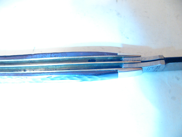

Camillus called this method of attaching the Delrin handles the “prong” method.
Prongs of the liner metal were stamped out to hold the handles on.
The method works pretty good. If you have ever have to remove a set of handles attached that way you will know. Often they come off in pieces with considerable effort.
Here are two quick scans of a Camillus stockman built with “prong” construction to show the prongs.
Hope this helps.

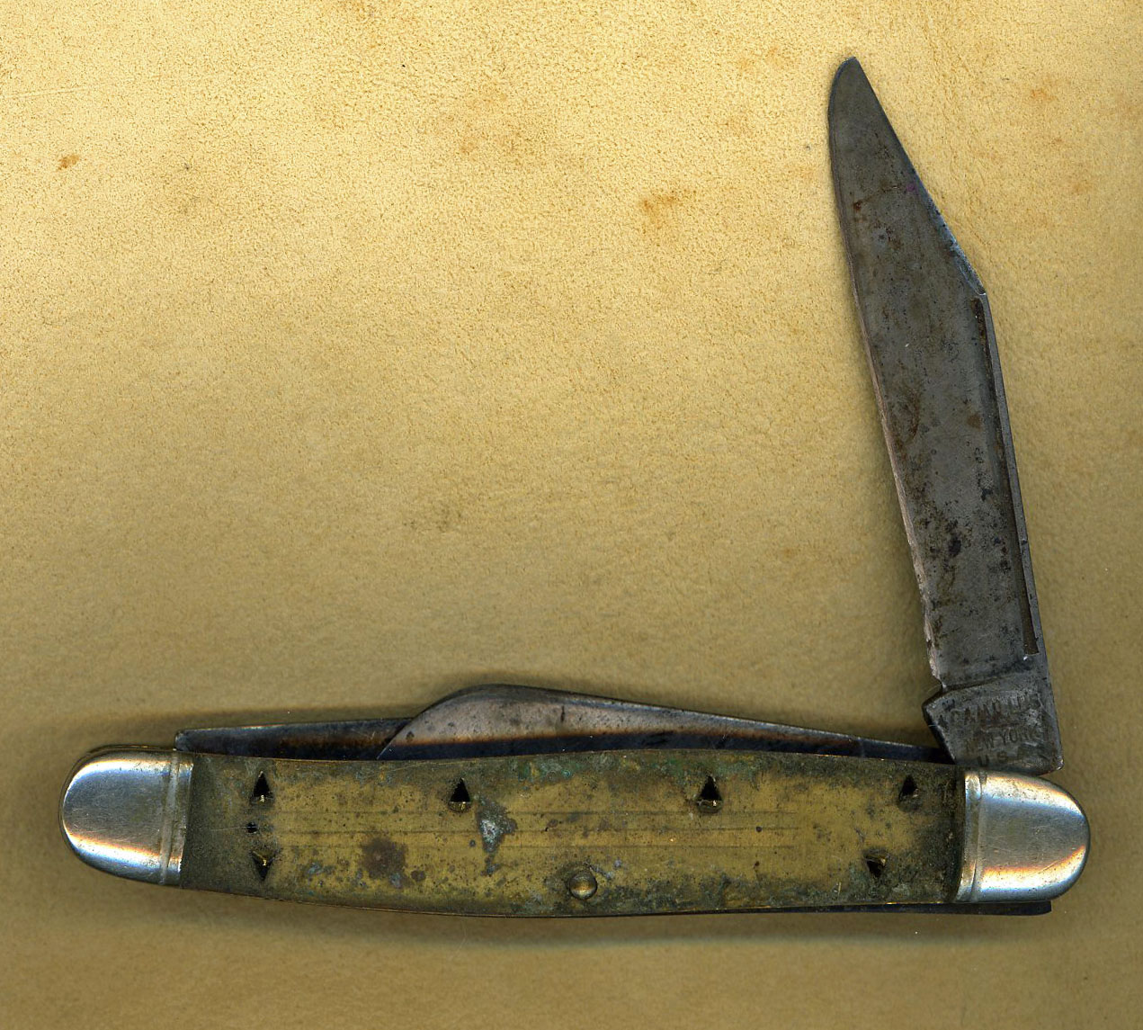

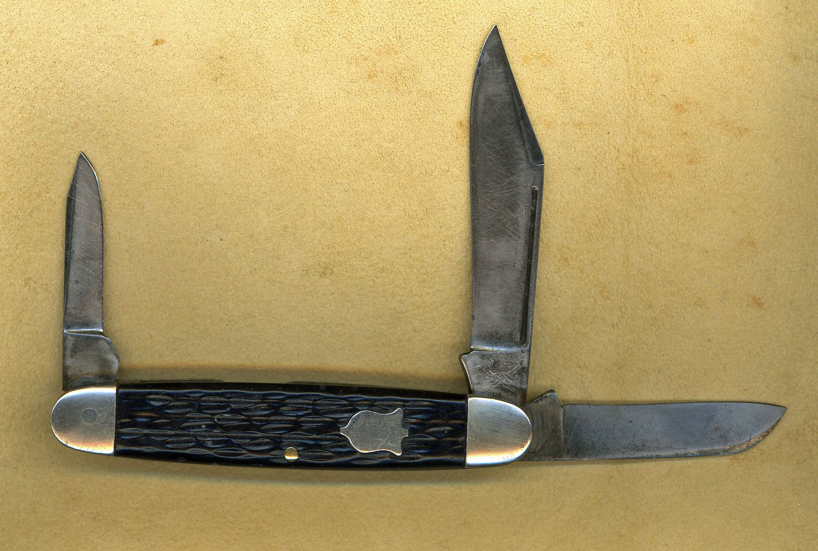

This is the knife I can't be sure of the handle material.

orvet wrote:This is the knife I can't be sure of the handle material.
It`s black plastic, has to be, bone would not press into the spurs and hold very well.
This method was in use as far back as 1913.
orvet
Posts: 19920
Re: Delrin vs Bone Handle Material
Post by orvet »
Duuh! ::doh::
I was looking at the material, not at how it was mounted.
No external pins. ::facepalm::
I checked inside and viola, I can see where the prongs are!
:oops: :oops:
