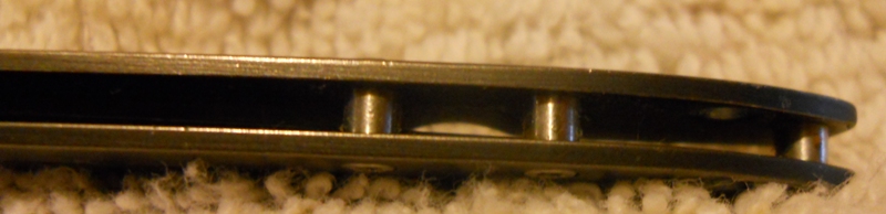

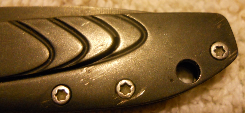

What is the correct name of the screws used to hold a knife together like these? I am looking in the books I have and can find Chicago Screws, pivot pins, cap crews, etc.

Bob,
I have seen these called socket head cap screws. (torx drive)

Bob,
that is aTORX screw.

I was thinking about ordering some and just playing with them to see how they worked. The insert that goes inside the knife could only be about 1/8 or less to work on a folding knife and the ones I see are much bigger. I assume these come in 3 pcs? There would be a screw for each side and an insert for the middle. I knew these were torx head screws but didn't know the correct name of the entire unit.

The inserts that hold the sides of the knives apart a called standoffs, at least by some companies.
I have seen them threaded and I have seen them with male & female screws that go insode the standoffs.

Torx with threadlock. Be careful with the threadlock.

McMaster-Carr sells a huge selection of threaded standoffs with various types of screws. They're often used in assembling electronics components. I've seen them as small a #2.
