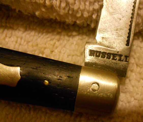

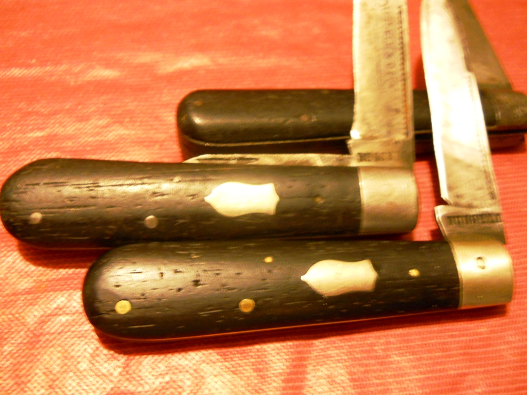

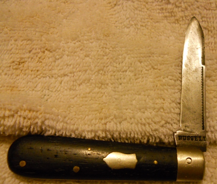

Here is a knife from my collection that I really like. The handles are great and the blade has excellent snap. As you can see in the pics maybe this has been repinned and maybe this isn't even the original blade, but I still love the knife and wouldn't part with it. So do you leave it as is or attempt to repair the pin on the maker side? On the back side of the knife the pin is flush with the bolster and matches well. If you repair this do you break the knife apart to repin it and take a chance on damaging the scales? Could you put solder on the pin and buff the area out? I don't think it can be peened as it is because the pin already is slightly below the bolster. Or there other options? Comments are appreciated.

howdy,
is the blade loose? if not, why bother...are you going to use it?
repair can be done without dismantling the entire knife.
several of the best mechanics on AAPK have placed tutorials on the how to's...complete with photos...

Bob, Nice looking old Russell. I picked one up identical to yours at an estate sale. But your blade is cleaner than mine. Unless there was excessive blade play, were it me, I'd leave it just as is. Again though, great looking knife

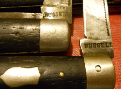

The tang stamp on your knife looks somewhat suspicious.
I never saw a J Russell knife stamped just "Russell" with that type of font before.
But I could be wrong.
The original blade could have been broke and replaced with a corroded one, poorly cleaned up and re~stamped.
If you like the knife that’s all that matters.
But formost it should be safe to use.
If the blade is loose, the pin can be tapped to tighten the blade with a small hammer then the bolsters can be sanded and polished smooth. If the blade is tight and the knife operates well then just sand the bolsters being careful not to remove too much material.
If you do it right you shouldn't see the pin at all.

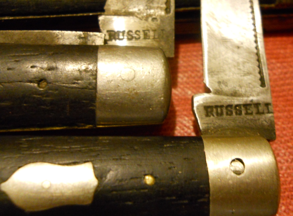

knives-are-quiet
Re: Bolster/Pin Repair
I am by far no Russell expert and have just this one 2 blade jack left in my collection.
After doing some searching around I did see that stamp on other Russell knives.
From what I read your knives are probably a couple of decades "late 1800's" older than the one I own. But I am not 100% positive.
If anyone else out there could give there 2 cents about these knives it would be appreciated.
As for your repair.
I would just sand that bolster down till it is flush with the pin.
I'd also touchup the other side to match.
You won't even notice the small amount of bolster material that you will sand away and the bolsters will look brand new. I use a belt sander with fine grit. It can also be done by hand sanding. You can also polish to a mirror finish but if the knife is going to be a user I'd go with a matte as the mirror finish will scratch up almost immediately.
I do this all the time with my cheap heavily used pocket knives when the blades become loose from say "a lot of heavy whittling". I tap the pins till the blades are just tight and sand out the scars left on the bolsters.
The only other way would be to replace the hinge pin with a new one.
I have a few knives that need tightening.
Probably have a chance to do it tomorrow.
I will post the procedure here to give you an idea of how it is done.

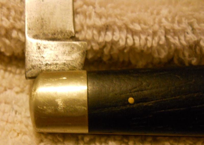

As I was reading through the posts, getting caught up, that was my guess. That Bob's knife was just an older tang stamp, but it was still just a guess until you looked it up JW. If the bolsters are steel, I'd go with what JW is telling you Bob. If they are nickel-silver, you can clean the area good, use some Stay-Clean flux and a drop of silver solder to fill that small hole and sand it down to meet the rest of the bolster. Since the knife is tight and works well, on nickel-silver, I've had this work on old knives that really didn't need taken apart otherwise. You've got good advice. I just thought I'd throw you another option.
knives-are-quiet
From Bob's pictures the bolsters look to be nickel silver to me.Elvis wrote:As I was reading through the posts, getting caught up, that was my guess. That Bob's knife was just an older tang stamp, but it was still just a guess until you looked it up JW. If the bolsters are steel, I'd go with what JW is telling you Bob. If they are nickel-silver, you can clean the area good, use some Stay-Clean flux and a drop of silver solder to fill that small hole and sand it down to meet the rest of the bolster. Since the knife is tight and works well, on nickel-silver, I've had this work on old knives that really didn't need taken apart otherwise. You've got good advice. I just thought I'd throw you another option.
I see no signs of pitting or rust. But then again they could be steel and the pin is nickel. That could be the reason the pin is recessed. Nickel silver is softer than steel.
Your procedure is a good idea Elvis so you don't loose any bolster material.
Any other idea's why that pin on Bob's knife is recessed without the blade having any wobble?
Taking it apart might just show enough build-up to compensate for the space left from a minor separation and the pin is probably wedged in tight by now. On a knife that old, that would be my first guess. You could very well be right about the NS pin and the steel bolsters. A magnet will tell the tale on that one real quick. If it's steel, silver solder may not stick and may not match that well either. Got a magnet Bob?
