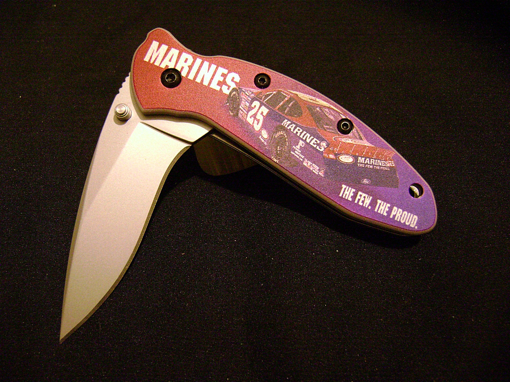

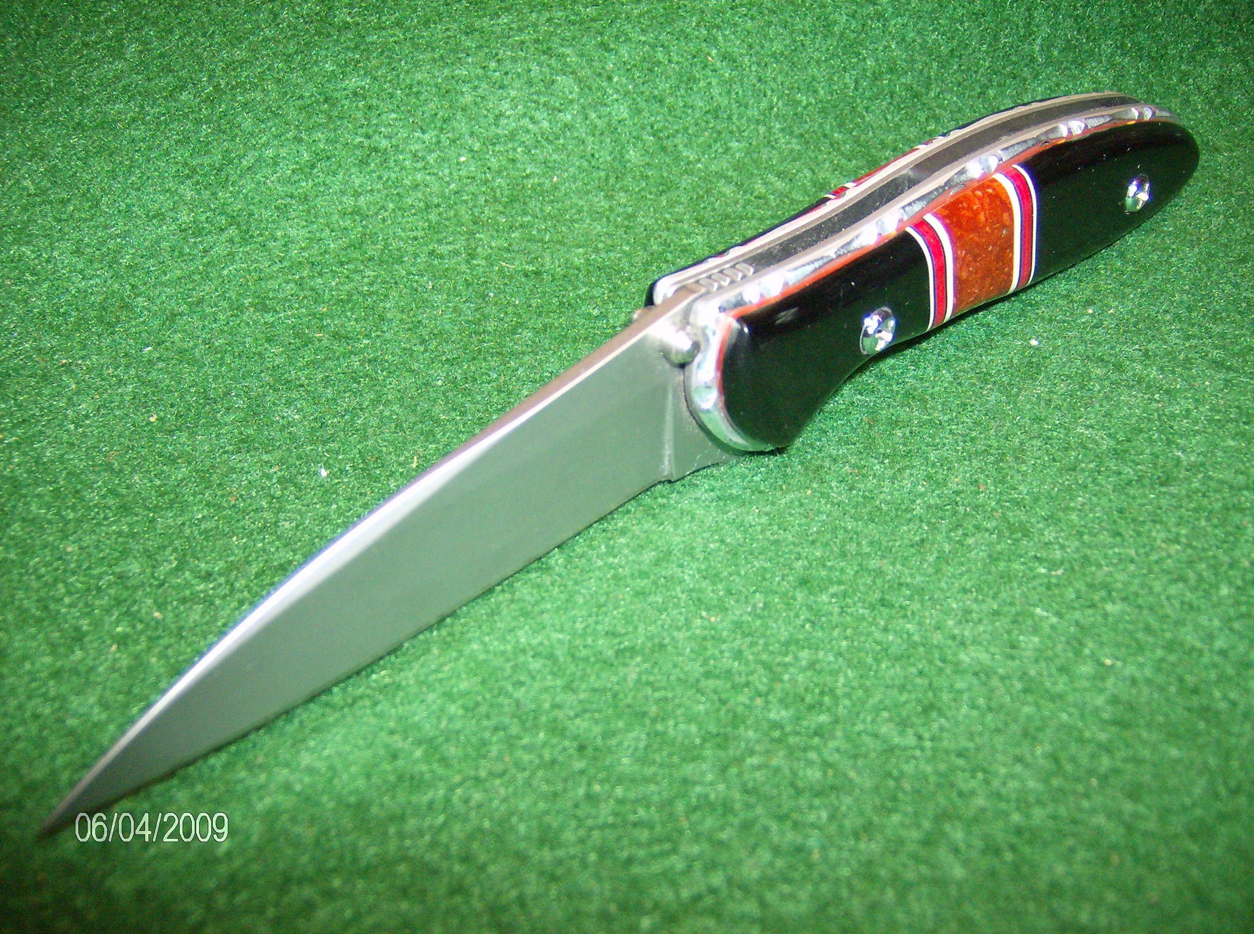

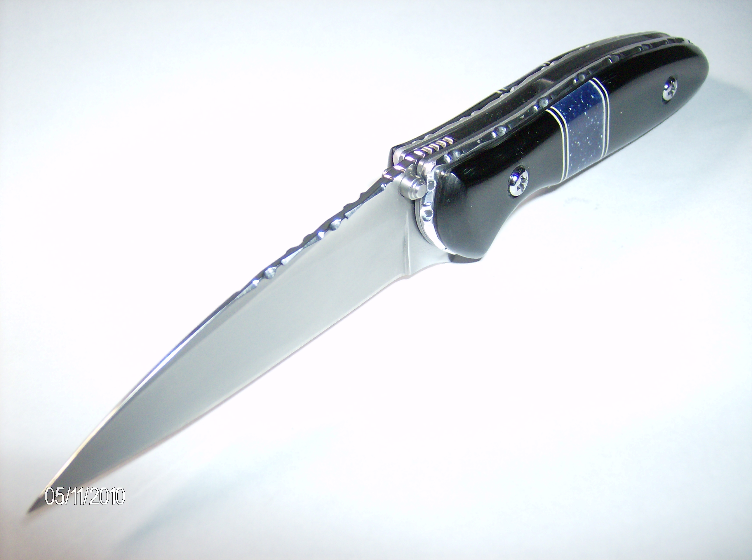

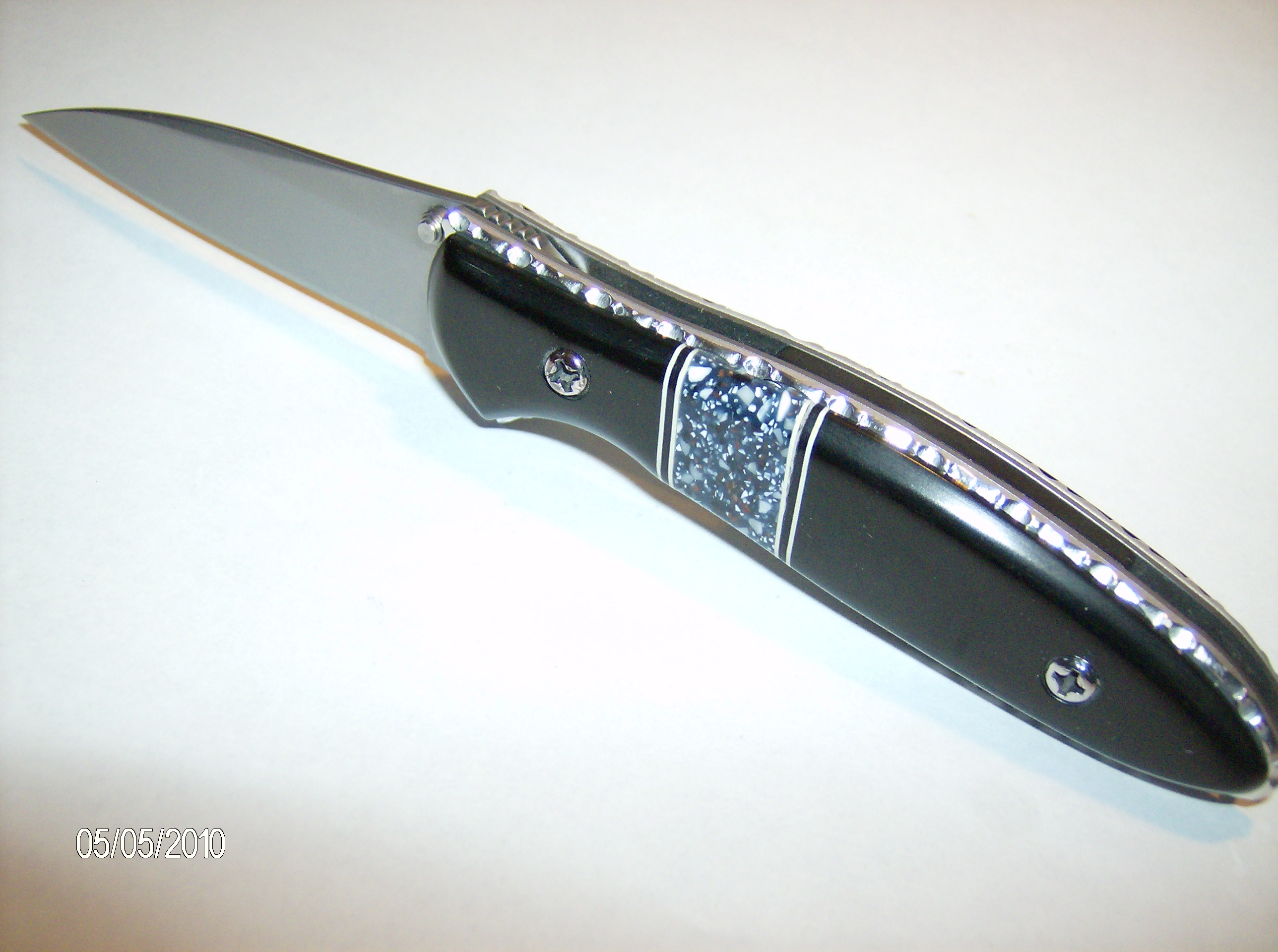

Kershaw Leeks.
Fileworked original handles and blades. Bolt on overlay handles, so the knife can still be taken apart for cleaning. I've got pics of about 4 or 5 more if I can find them.

Yah, I swung a deal on 12 Leeks awhile back and customized all but a couple. (kept the Rainbows original) Thicker handles are a big improvement. They feel really good in the hand, but still thin enough for comfortable pocket carry. I did away with the clip in order to add the handles to both sides.
I made a poster board pattern by tracing the handle, then scribed an 1/8" off all the way around to allow for the fileworked edges. Built, cut and shaped the handles. Then drilled, polished and attached by drilling and tapping #4 screws holes through the original handles. Location of the holes are the biggest trick, as one screw will fall in the channel that the thrust spring rides in. By simulating the motion of the spring, you'll see the area to drill and tap that's out of it's range of motion. The aluminum is soft and easy to file, drill and tap. Just be careful not too overtighten the screws. They'll tighten down sufficiently, just don't over do it. Don't forget to notch out the back handle for the safety lock.
Since these are an overlay handle, that may need to be removed occasionally. I created the channel inlay look by building them onto vulcanized spacer material to create a more solid slab. I think you can see the red one, but I used black on the other two, so it blends in and disappears.
