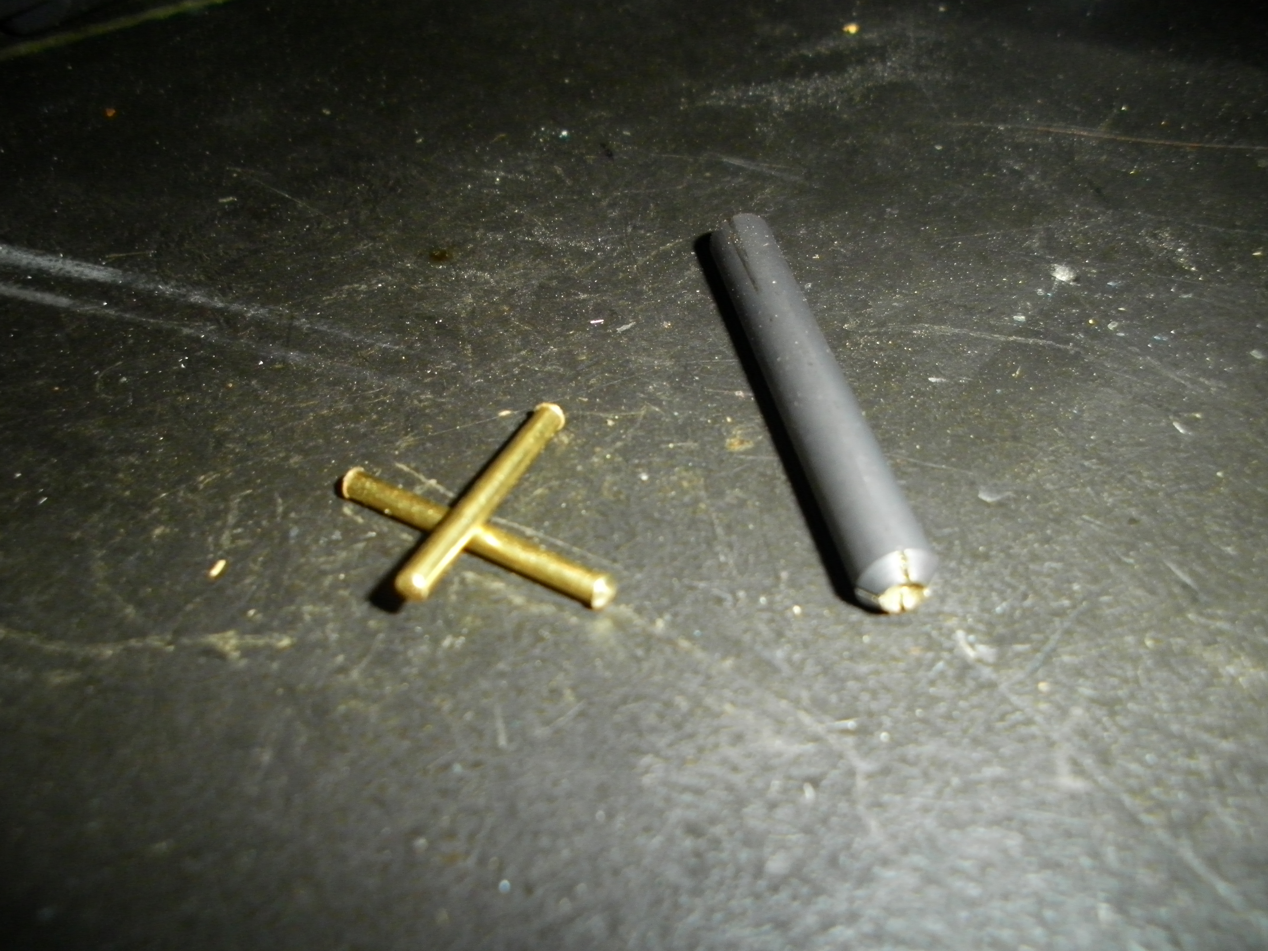

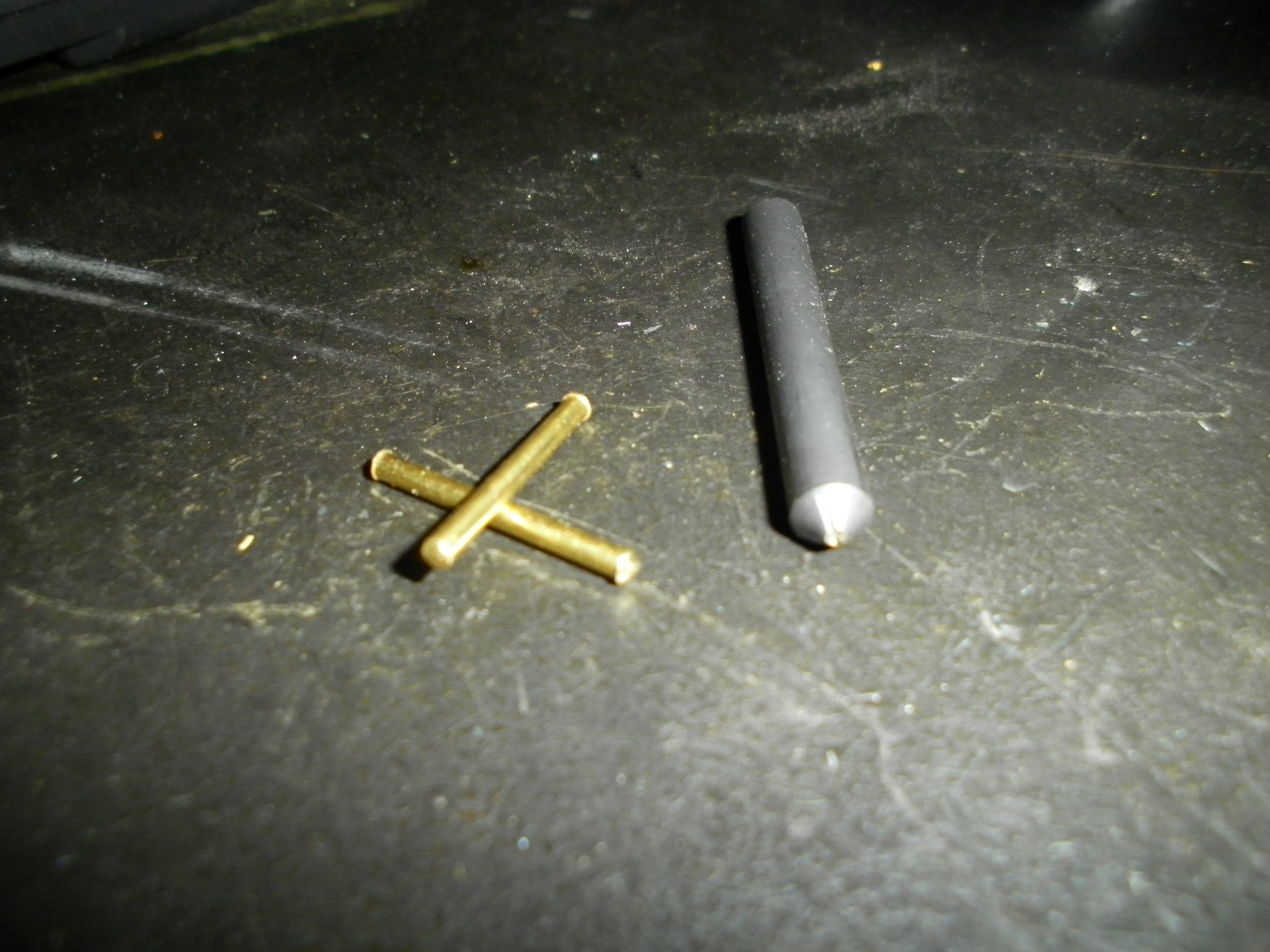

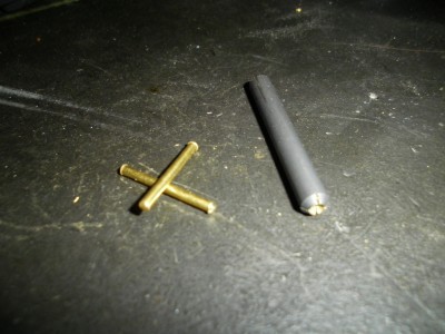

Yep, that's what I was afraid of MM. Here's the one I got from Jantz and a couple of pins that are the best I could get out of it. I filled up an old medicine bottle with thread cutting oil and used it to dip the spinner ever so often. It helped alot and these are much better then my first attempts. Still not quite what I was hopin' for though. When this spinner bottoms out, that's it. No matter what you do, it'll roll the head to this point and it's done. I guess I was under the assumption that it would just keep rolling it until I said when. But that's not how this one works. I think what will work, is to hand peen to swell the ends snug. Then top it off with the spinner to dress 'em out. Otherwise, you'd have to be deadly accurate on just how much pin to leave sticking out before spinning.
This is the smaller end.
WB

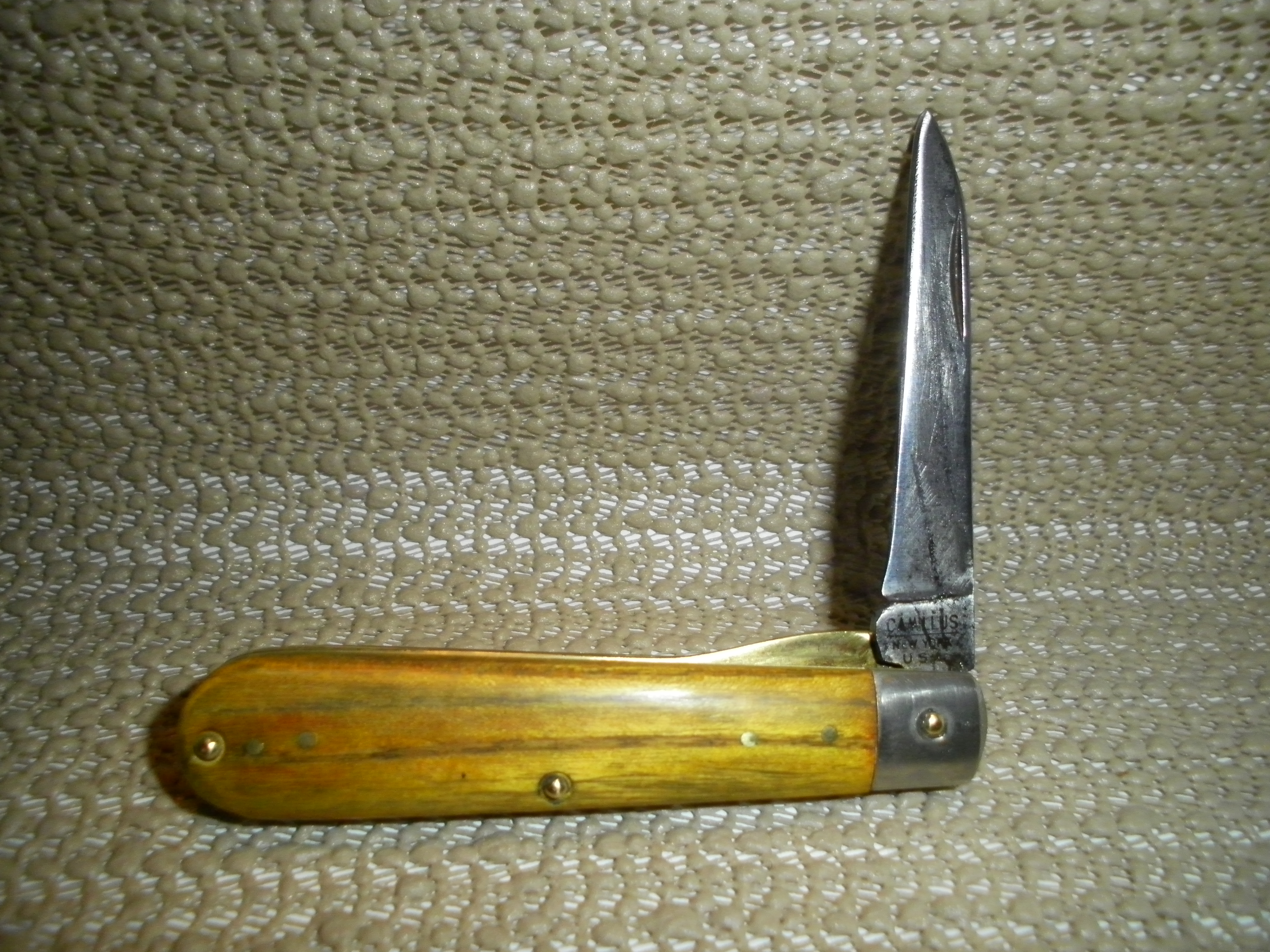

This was the only spinner I found available through Jantz. Here's my first attempt at using it on a knife.
This old Camillus was my first go at rebuilding an electricians knife. With this much wear to the spear blade, I probably wouldn't have bothered. But, figured it would make a good candidate to try spinning pins on, too. (killing 2 birds with one stone?) Electricians knives are good ones to work on. I even incorporated the liner lock over to the spear blade.
Anyway, the spinner worked better then I thought it was going to. Length of the exposed ends of the pins is crucial! I don't mind too much, the "cut-in" around the pins, but don't like that it's just a given with using this spinner on 3/32" pins. (not always a desireable effect)
Something i'm thinking about, is chucking the spinner up in a drill and belt grinding the large end down to a smaller size. (I can't imagine i'll be spinning to many 1/8" pins) If I can taper it down specifically for 5/64"-3/32" pins, I think it would pretty much illiminate the cut-in. Or, does anyone know where you can buy spinners in various sizes? Is there a set of them available?
I ended up sanding the heads off the smaller 1/16" handle pins, (don't ask why there are so many ::facepalm:: ) but the smaller end on the spinner worked fine. No cut-in, but I concluded that, it's because the small end is specific to 1/16" pins. It probably would cut-in on 1/32" pins.
Overall, I think i've got a decent grasp on what to expect from spinners. They aren't all I expected, but with time and practice, I think it'll be a good tool to have around.
