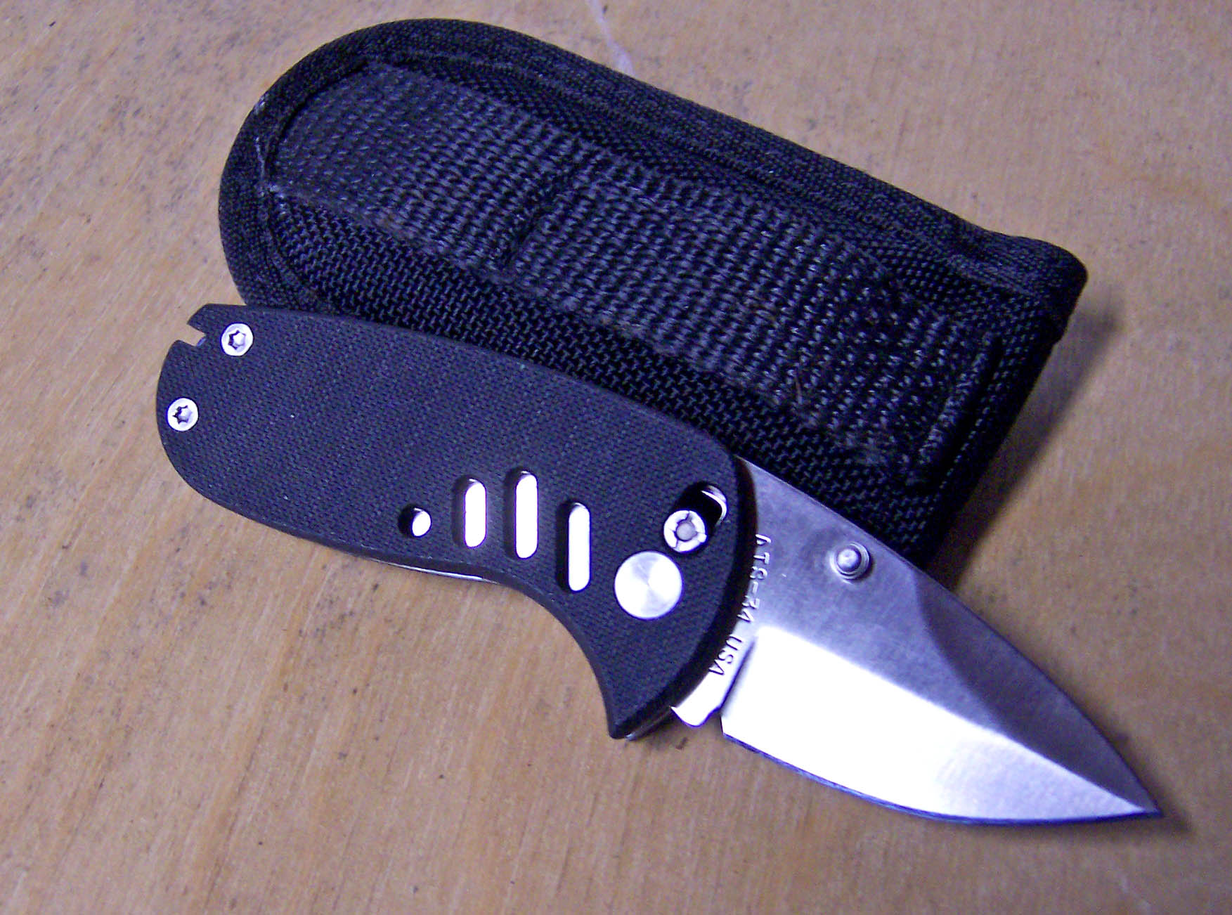

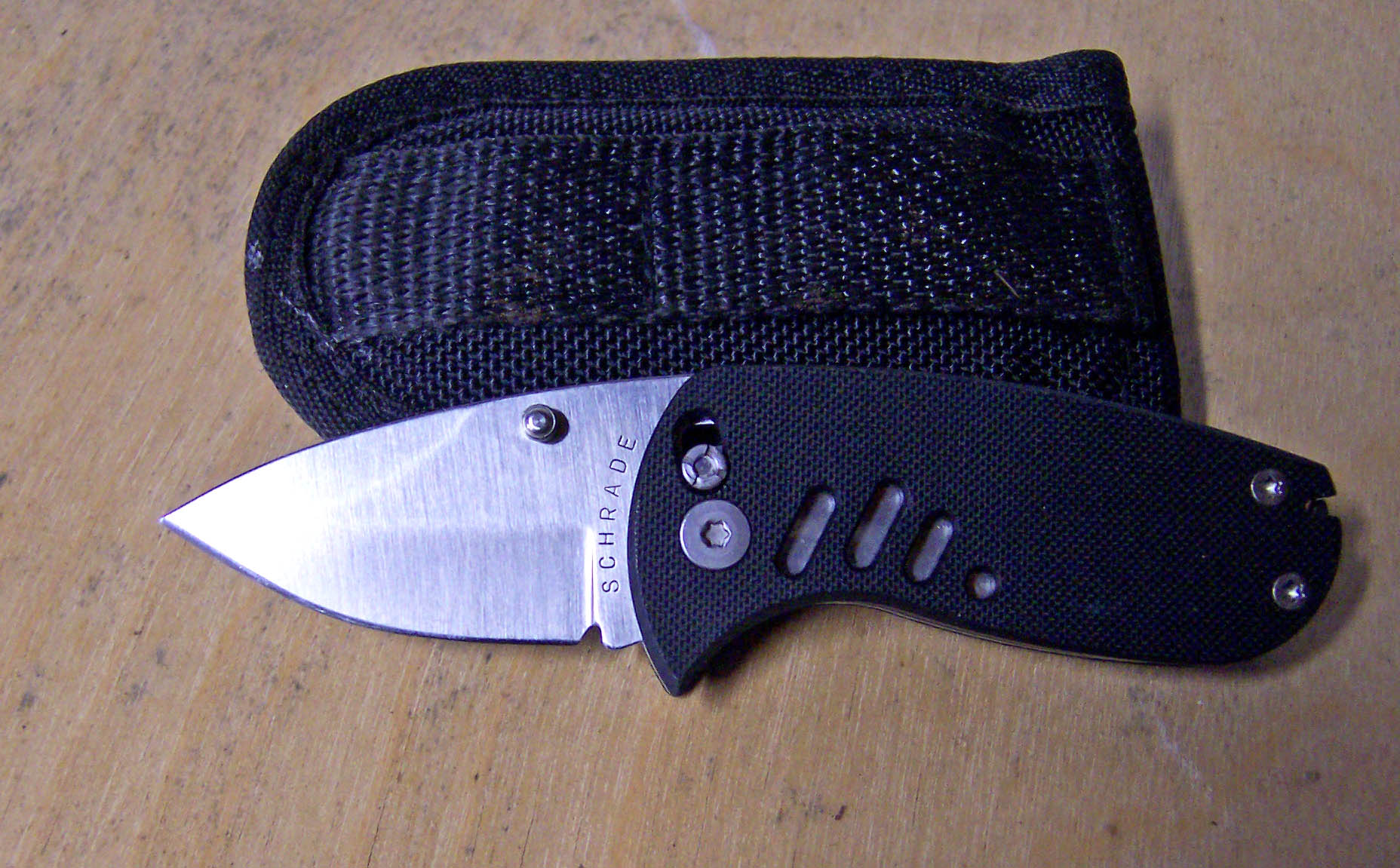

The only Schrade catalog item I can think of, off the top of my head, with ATS-34 steel was the Spitfire, 2003-2004.
- ColtCobra
- Posts: 4
- Joined: Tue Jan 17, 2012 8:09 pm
Re: Schrade+ Old timer Golden bear blade steel question?
I believe your right.It would be nice if had they used ATS-34 on my golden bear,but no such luck.Although 440C is a good steel if the heat treating is done properly. By the way,nice spitfire you have.orvet wrote:The only Schrade catalog item I can think of, off the top of my head, with ATS-34 steel was the Spitfire, 2003-2004.
