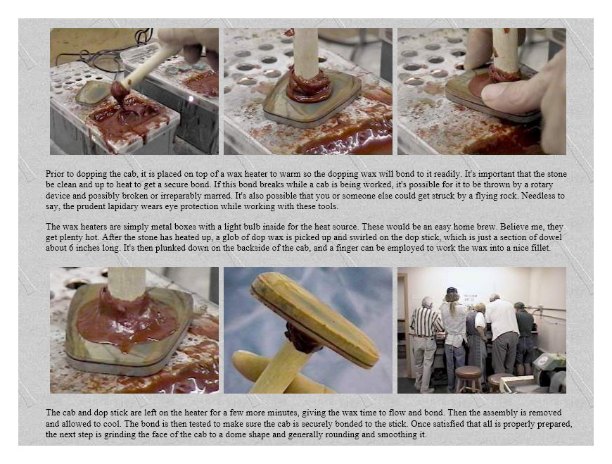

Jewelers "dob sticks" would be a good way to save your fingerprints.
There nothing more than a wooden dowel used with a hard setting jewelers wax.
Just use a Bunsen burner (alcohol burner) to heat the wax.
http://www.inlandlapidary.com/singlepro ... =&source=1
