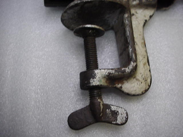

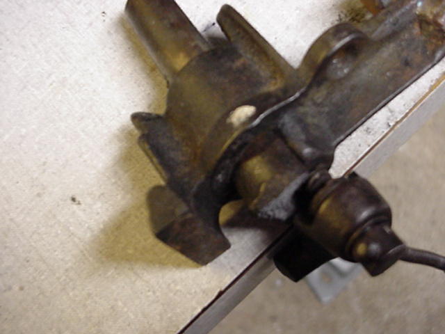

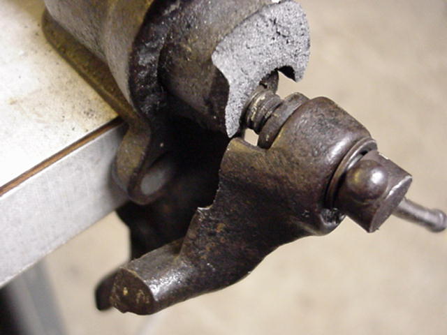

my favorite little bench vise snapped in two this morning! :o :shock: :(
It is only about 4" long, probably a jewelers vise, I have had it for years. I bought a knife that someone had put a steel bail on and I was trying to remove the bail, it kept slipping in the vise so I tightened it a little more and then it snapped :evil:
I have a bunch of full size vises but this is the only little one I had ::teary_eyes:: ::teary_eyes::

That is a shame. ::teary_eyes:: Those are hard to find. It's cast so you'll need to find someone that is good at brazing to weld it back up for you.

Thanks, I don`t know what I am going to do with it now ::undecided::

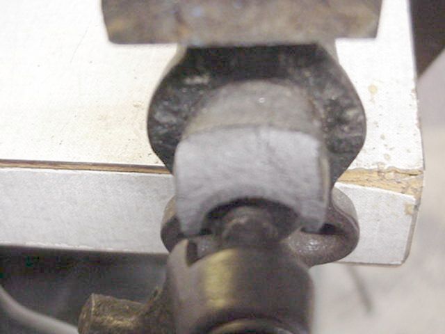

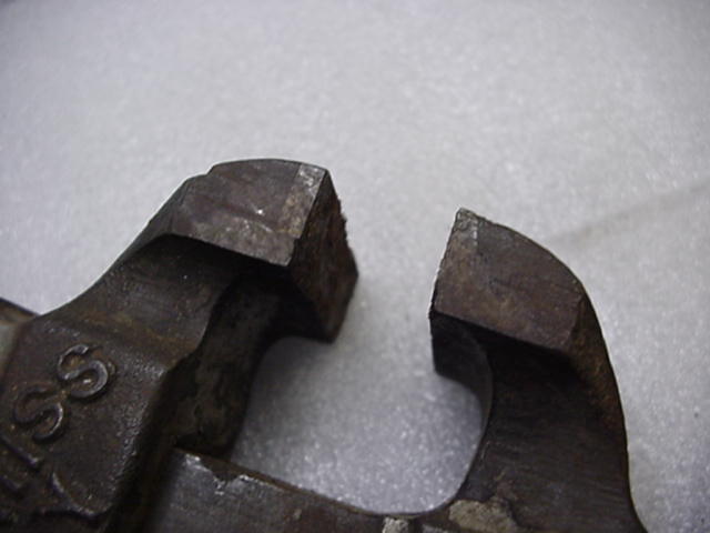

Wow! looking at the pictures I just posted I see there is some writing cast into the back jaw, I am going to clean this up and see what it says, never seen that before ::suspense::

I just cleaned off the vise and it is marked " Patented June 15, 18...? H & B
Could this have been made by Humason & Beckley of pocket knife fame??
Now I am even sicker than I was earlier when I thought it was unmarked ::doh:: Image

If you know a good welder, that vice can be "V'ed" and welded with nickle rods. I have a brother that welded for over 30 some years. He's certified in every kind of welding there is. I traded for an old car once and never checked to see if it had antifreeze in it or not. It didn't, it had water in it. It froze and cracked the motor block with about a 4 or 5 inch crack and didn't pushing a single freeze plug out. I thought I was going to have to change the motor out and really hated the loss of the motor because it ran great. My brother told he could weld the block up with nickle rods and guaranty me it wouldn't leak. I figured it was worth a try so I let him. It worked! I drove that car with that motor block welded for 5 or 6 years and it never leaked a drop. It was still going strong when I traded the car off. I'd give welding the vice a try before I chunked it in the garbage.

your vice could be a Humason and Beckley. Not to rub salt in the wound. I checked them out in Goins and it says they made all types of small hardware items. Too bad about the vice. Did it mount by a screw from underneath?

FRJ wrote:I checked them out in Goins and it says they made all types of small hardware items. Too bad about the vice. Did it mount by a screw from underneath?
That was what I was afraid of Joe :( Yes, it does have a screw underneath to clamp it to the bench, which ironically had been broken a long time ago before I ever got it, it was brazed, but held up pretty good ::nod::

MB, it can be fixed. Brazing or Ni rod would be ok, but show a visible repair. If it was me, I would gas weld it with a cast iron rod. Probably in the gas grill, to preheat, and cool down gradually over a couple hours.

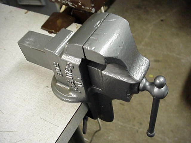

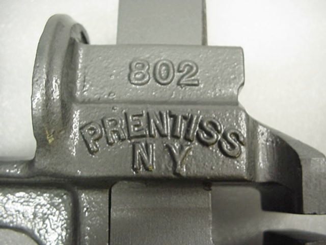

WOW! what a nice surprise I got today...................

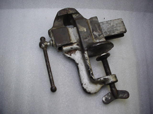

This rather large box arrived at the Post Office with my name on it and I was puzzled at what could be inside.

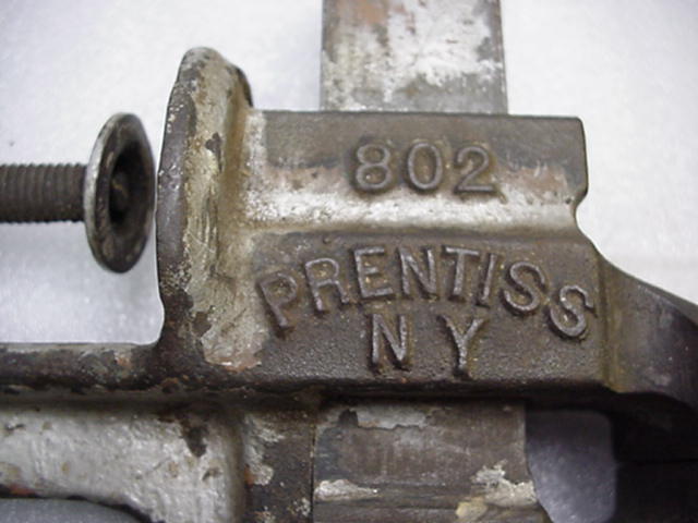

I proceeded to open it up and to my surprise it was a nice old #802 Prentiss bench vise! :o :D
It was given to me by Charlie Noyes aka RobesonsRme. Charlie, thank you so much! I really appreciate it ::ds:: ::handshake::
I have put it in it`s proper place on my work bench and it will be used this weekend on some small projects I have to do. What I like about it is it is a bit larger than the one I had which will come in handy for the bigger jobs and I seriously doubt this one will break! It is very well built yet small enough for what I need it for ::tu:: ::tu:: 8)

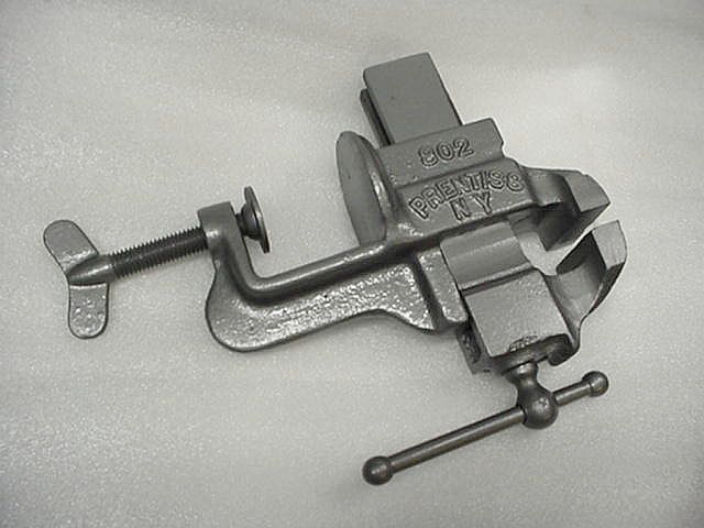

RobesonsRme.com wrote:I hope he repaints it, though. ::facepalm::

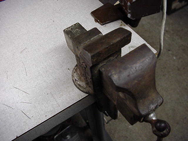

I took Charlie`s advice this week, I had some time and re-painted the old vise.
Took it apart and soaked it in a chemical solution to remove all the dirt, grease and old paint, it had 3 different colors!, and I sprayed it with a machine grey hammer-tone paint.
Here are the results, it is now back on the bench and should last for the rest of my lifetime ::pray::

Dimitri, that looks really good. ::tu::
