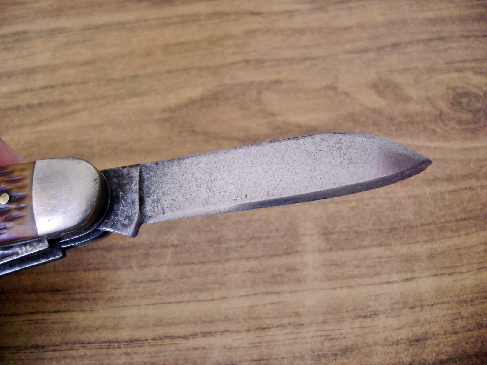

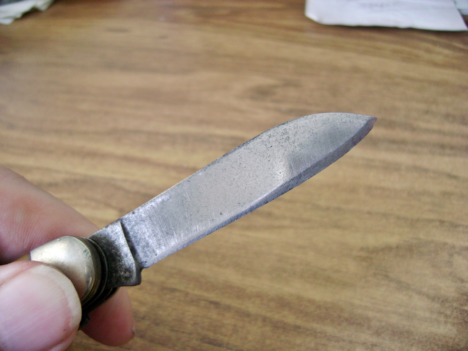

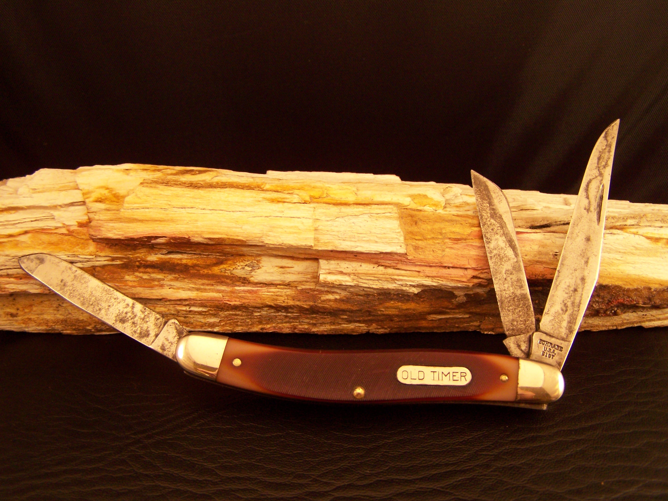

Here's the knife that I have the question about. I have already used 0000 lightly and flitz with a buffing wheel. I was hoping to clean it up a bit. I guess that with use the patina will even out? I am not trying to clean it up to sell. It's a keeper for EDC. I just wanted to make the blades more even.
I have already posted the knife on another thread, sorry for the over exposure.

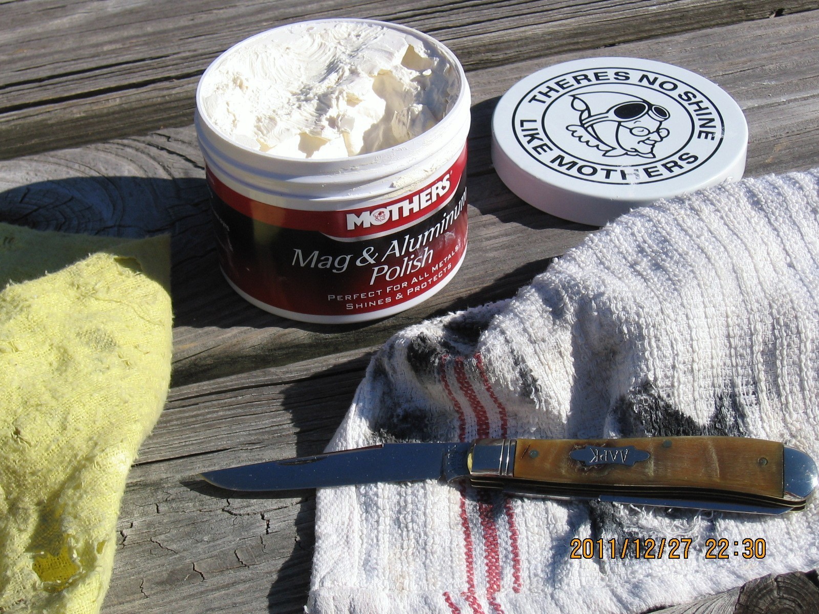

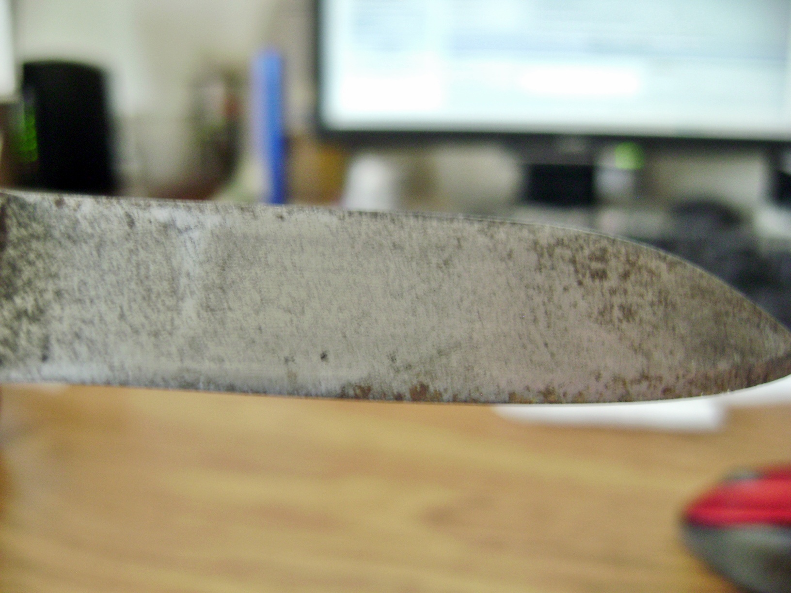

I'm sold on Mother's Mag & Aluminum Polish.
Here's some before and after pictures of the main blade on an old Ulster.
Before Mothers
After Mothers
Before Mothers
After Mothers

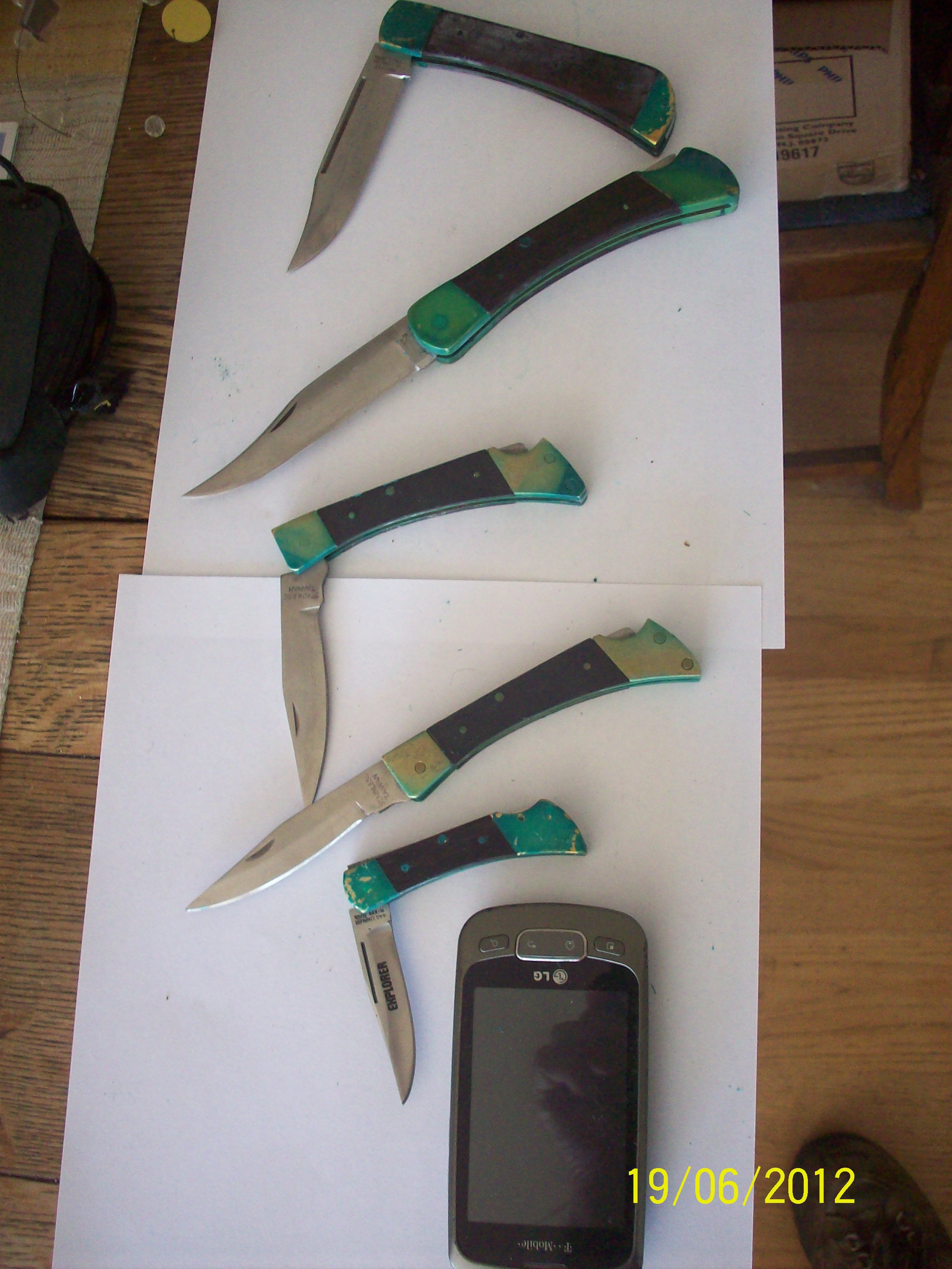

any help on tarnish on the metal and brass parts, they are greening?

Where are you storing these knives? That is ALOT of Verdi Gris. Most of the time, that will just wipe off. For more stubborn tarnish, maybe Flitz or Brasso.shugy wrote:any help on tarnish on the metal and brass parts, they are greening?
Do not store knives in leather for long periods of time. The acids in the leather will react with those metals.

Thanks for the info .These are part of an inheritance and they were in an old ammo box in a garage. I will take better care I think!

on the folders in the lower photo..i would use "Never Dull".
it is a form of gun cotton, will whipe that green off the brass quicktime...
get it at the local auto parts stores.

Try Hoppe's #9 gun cleaning solvent. It is supposed to work very quickly.
Dennis Ellingsen wrote a good article on verdigris in the OKCA (Oregon Knife Collectors Association) news letter.
You can read the whole article here: http://www.oregonknifeclub.org/Verdigris.pdf
The article discusses the cause of verdigris, how to remove it & how to prevent it from forming on your knives or guns.
