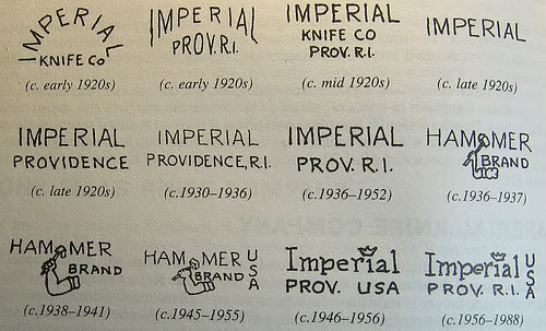

First, about the Imperial, they were first produced with the "shell handle" in 1936 under there Jack-Master line of affordable knives.
Here is a pic with the different dates the numerous different stamps were used. The handle is made from an alloy they called "Nuloy."
A magnet WILL stick to it - that tells you it isn't made of Nickle Silver as some people think. I'm not sure what the alloy really is, but it WILL rust if
exposed to harsh conditions. Other than that, it will shine-up and is durable other than the fact it IS hollow.
