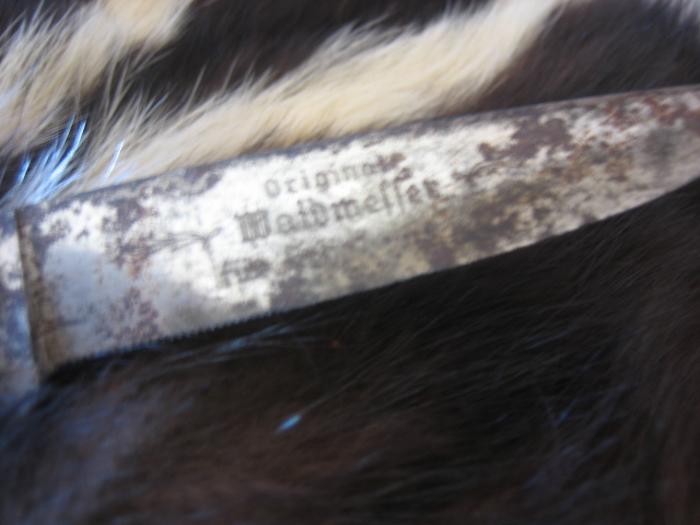

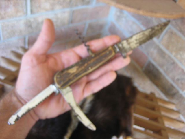

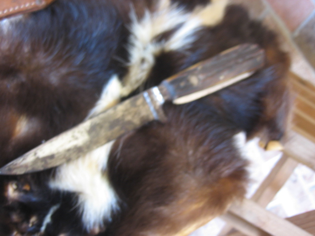

Hello, I was just wanting to get some different opinions on the best way to remove rust from a fixed/folding knife with stag handles and an etched blade…both sides of the fixed blade have lots of etching…maybe I am posting in the wrong forum…I tried a search for this topic and came up empty…I'm thinking an oil bath and see how it comes off before thinking about using 0000 steel wool (gently) on it. It's an old knife and I want to try and save the blade etching…If I'm right with the oil bath what type of oil is recommended? What oil is NOT recommended…I can't afford mineral oil but I have plenty of peanut oil is that good? Also, I know wood handles can't be soaked in oil but how about Celluloid, Delrin, Micarta or any other type of plastic or any other handle material for that matter…Thanks for any input anyone might have… maybe I'm in the right forum this time or maybe somebody cares over here….sorry about all the ??? Q's ???

Thanks for the replies guys I guess I'm not as hated as I might have thought I was
and joe I'm with you on the work my way down to 0000 steel wool I had already both thought about and been warned TO use something like cotton cloth and rub rub rub…my Pa said the 0000 steel wool shouldn't hurt the etching but I'm leary…and he's on medication…I figure the peanut oil should be safe but your right about needing a more penetrable oil…it would work faster anyway..peanut oil for pine sap huh? Who would have ever thought of that? I would think gasoline.And yes it Is the black etching……..okay I went and took a few pics but the sun wasn't cooperating

pencil here too......Is that a puma?

For now I put some turbine oil on it just to slow down the rust until I can afford proper stuff….yeah it's a Puma…..Pretty old one

Ended up breaking out the Rem-oil, poor lil bottle, A little scraping with a softer metal and wipe,rub,oil,scrub. rinsed and repeated many times got through the surface rust and saw the pitting situation which I knew was there. Poor edge, gonna need a lil tip n shape. I haven't made it to sanding but the etch is still there so far. The pencil technique is almost magical (thanks to whoever thought that one up) and thanks for the tip guys.
I will use that one from here on out, I used a carpenters pencil and after that, I couldn't see using a regular pencil except for tight areas.I couldn't resist breaking out the Flitz and it helped a bit but I'm back to working it with oil for now…. Oh, by chance Does anyone have a sheath for this knife???
…………..it's worth trying
