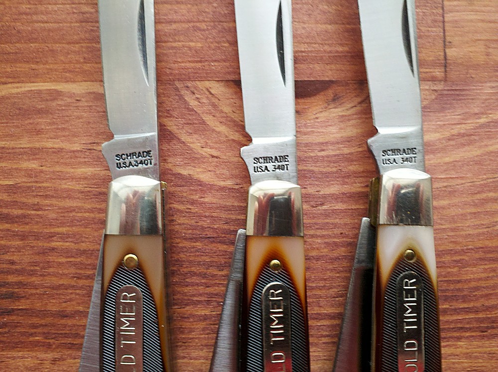

I just took this picture of three different Schrade 34OT Middleman's that I own - I noticed that two had serifs on the lettering and one doesn't. The sans-serif version (on the left) also has a "redder" tint in the Delrin (which I can clearly see in person, but doesn't show in the picture) and larger handle pins - in the case of my three I think the sans-serif is the latest one made of the group.
Ps Didn't realize how fuzzy the picture was once enlarged - I have replaced it with a sharpened version.
Posts: 39458
Re: Delrin Coloration
Post by jerryd6818 »
Old Hunter wrote: I noticed that two had serifs on the lettering and one doesn't. The sans-serif version (on the left).
Sooo thaaats what that means. Once again I've learned something from AAPK and in this case, the lesson was unintended. Thanks Colonel.

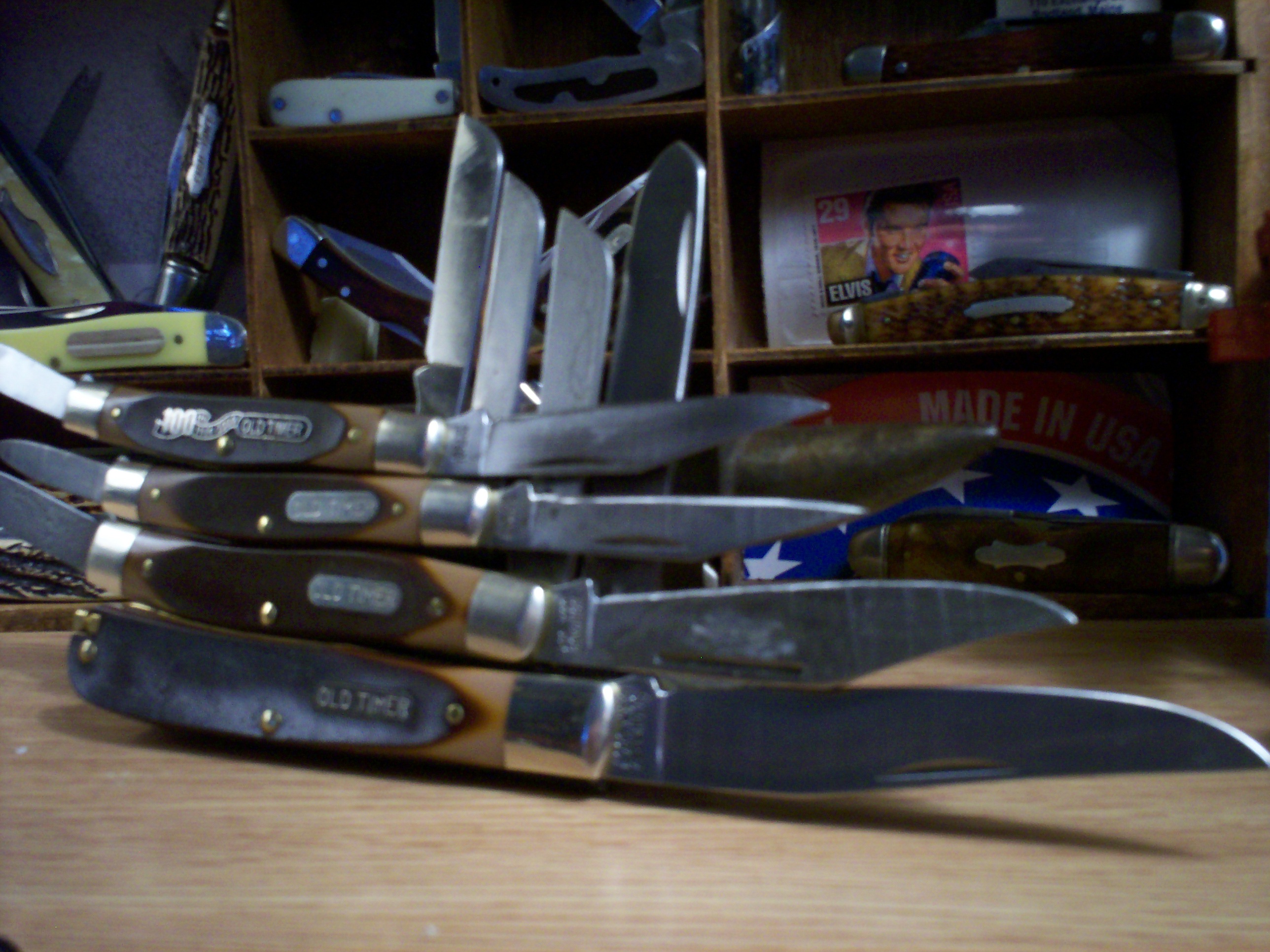

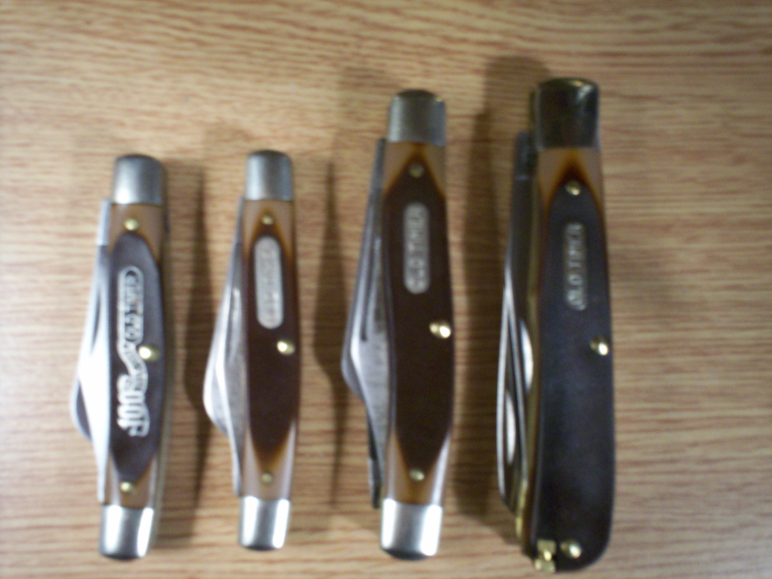

Here's an earlier, I believe, tang stamp of my 34OT Middleman; you can see how, without good glasses, my old eyes read "84OT"...
-Bill
Note the 3 has a round top, unlike your flat top 3s. Also, the "U.S.A." stamp is so tightly set, the letters and periods are on top of one another and, of course, "Schrade" is serified.

Nice display of Old Timers Bill ::tu::two34ot,8ot+96ot

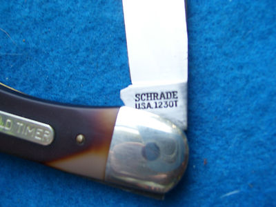

OH, can you see the bolsters on the Old Timers well enough to see if any of them have pins in the bolsters and are not the Swinden Key system? The reason I ask is could one have been made by Camillus and the others made by Schrade, or vice versa? I've seen N.I.B. Old Timers with factory pinned bolsters that were said to have been made by Camillus for Schrade. Maybe Dale can jump in on this and give some information or opinion about the subject.

I noticed the 123OT Old Timer has pins through the blade .They also must have been made by Camillus

Shearer wrote:I noticed the 123OT Old Timer has pins through the blade .They also must have been made by Camillus

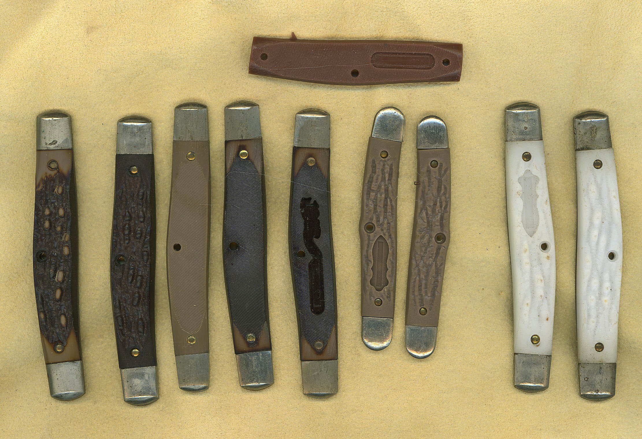

Here are some handles from the Schrade factory.
As you can see they are different colors before they are dyed, hafted and polished.

Ah, that explains the difference in coloration: various lots of dye's and Delrin from a production span of many years - thanks Dale.
