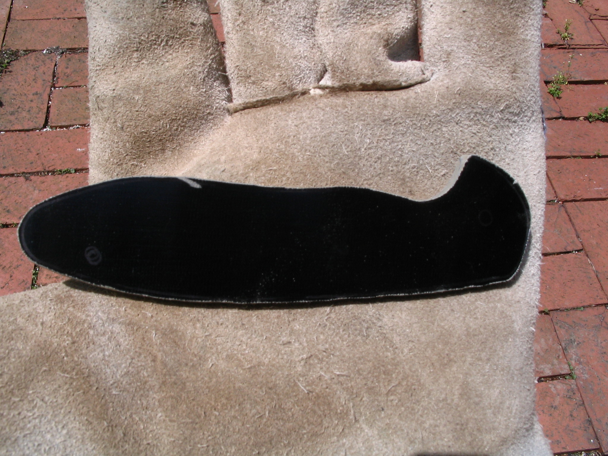

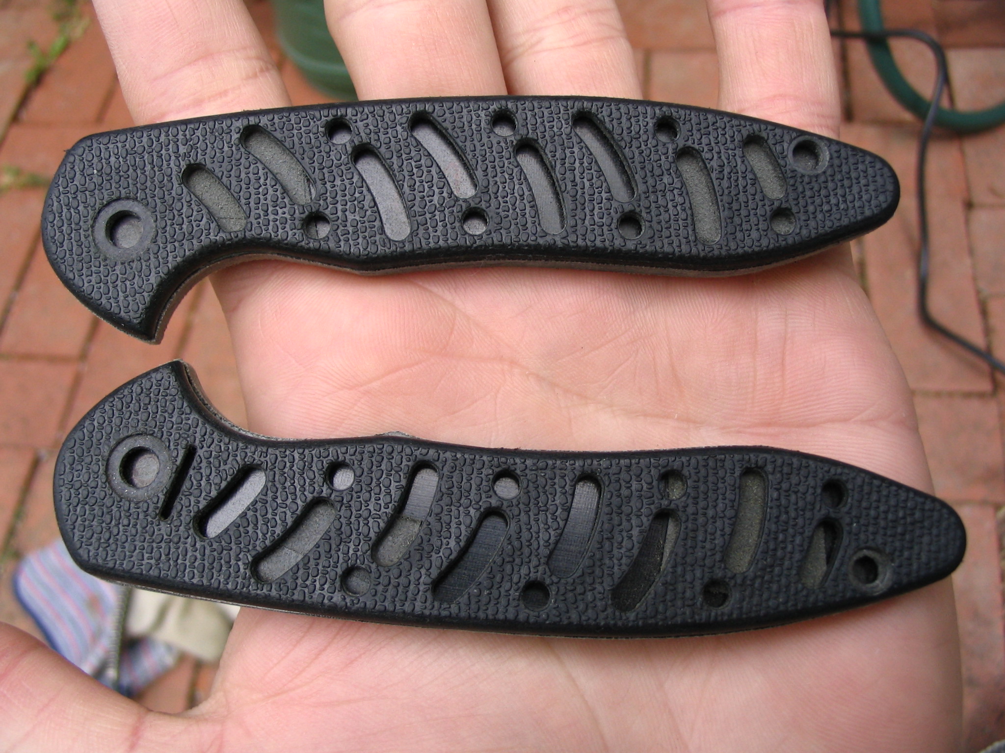

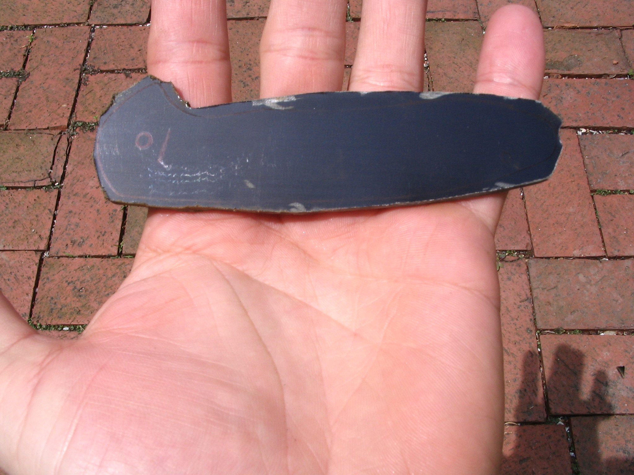

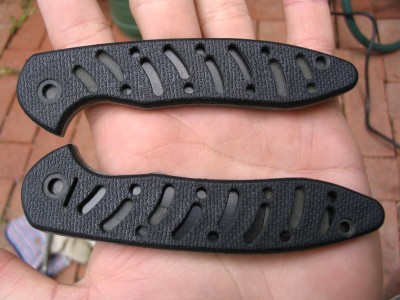

Thanks for the tips guys. I have started my handles and will try and keep photos coming as I go. I started by using the stock scales as a template to trace onto the micarta slab. Using a reinforced cutting wheel I cut out the rough shape for the handles. Next I used a sanding drum on the dremel to shape them up. And of course I used a mask and gloves while I did the Dremel work. As you can see I worked outside. I taped the original scales over the micarta and tried to sand them as close to the originals as possible.
More to come when I get some more free time...
Nick
