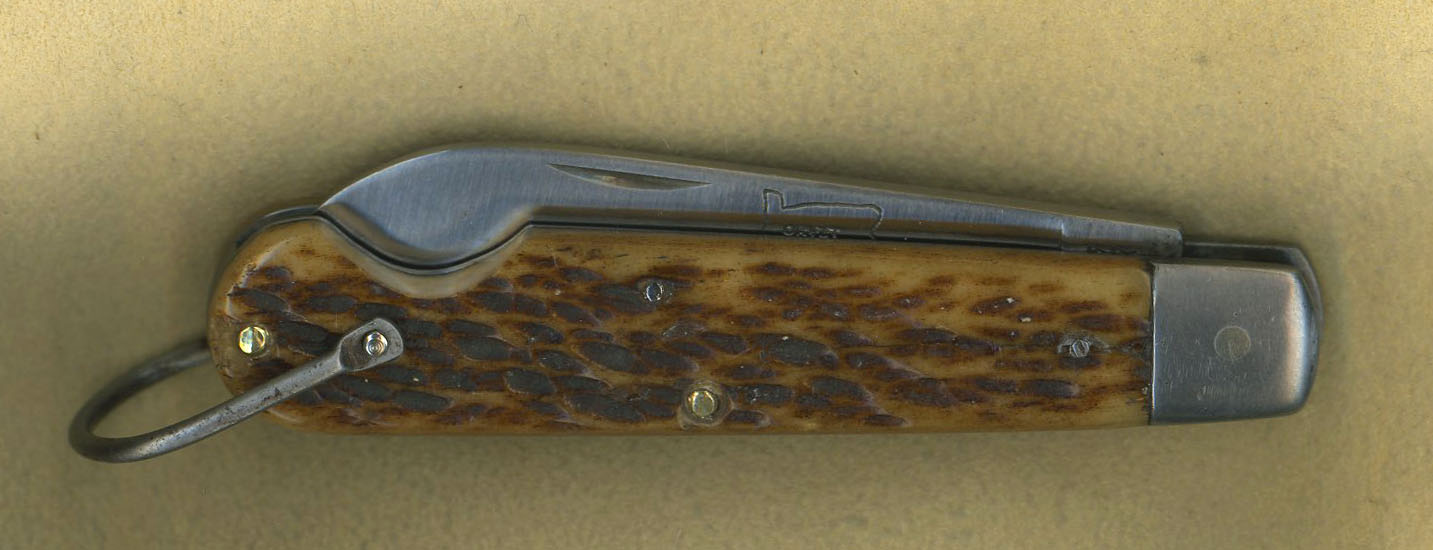

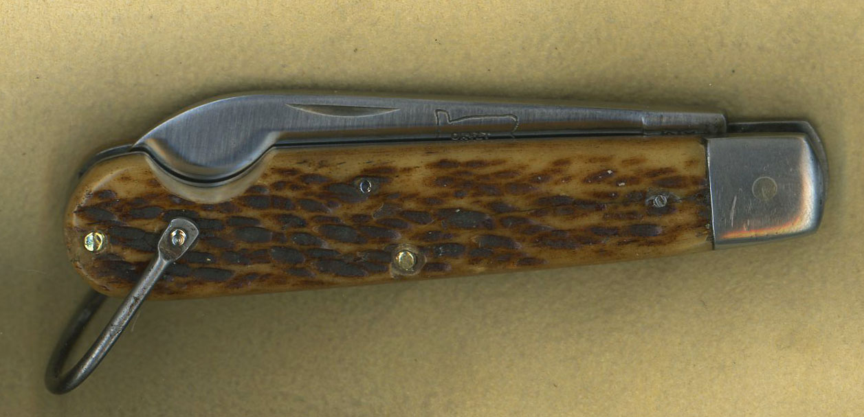

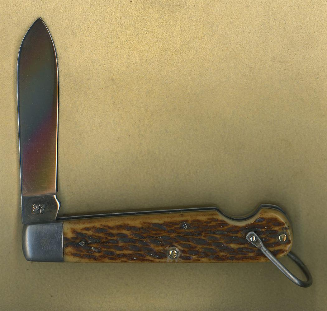

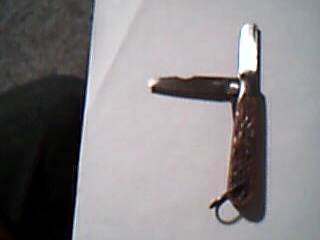

Recently on ebay I saw the knife in the picture below:
From the description & bad pics I was able to determine it was a Camillus 4 Line TL-29 with bone handles.
Since I am such a fan of Rogers bone I decided to make a single blade jack.
I looked for a 4 line TL-29 blade but I didn't have one without tearing up a good knife, and I had a #27 blade.
I got it put together & decided it needed to be an easy opener.
Here are the results:

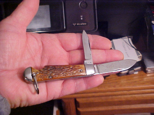

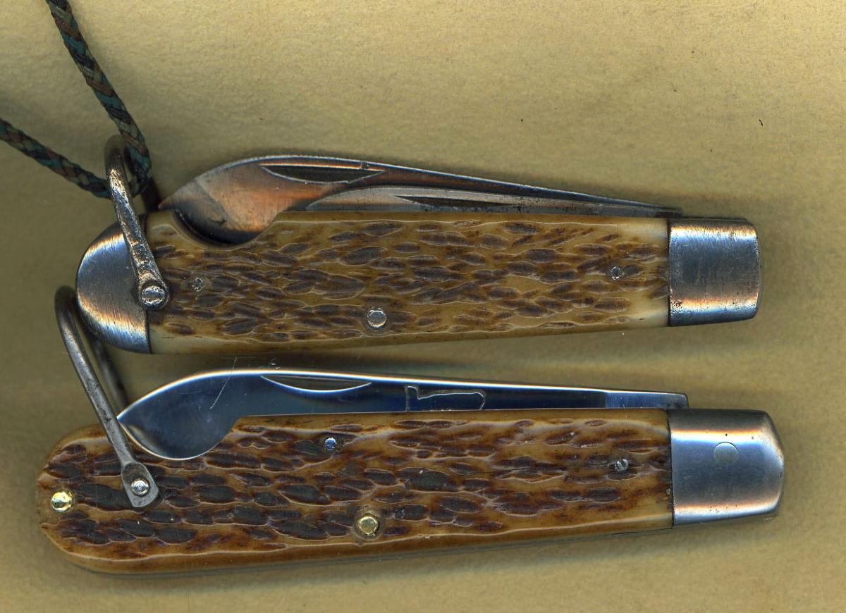

Here is this knife compared to a standard Camillus 4 line military jack.
As you can see the former TL-29 is 3-3/4" compared to the 3-3/8" jack.
3/8" may not seem like much but when you have big hands, it is a lot.

Good point Jim, I considered that when I cut the EO notch.coffeecup wrote:Looks really good!
Just a sidebar: One the military-issue E-O, if you increase the size of the E-O notch just a bit--maybe 1/8" wider and about 1/16" deeper--it gets much easier for arthritic hands to open. After a couple of tests on some E-O basket cases, I modified an original military issue E-O for a friend of mine. He was afraid he was going to have to give it up after carrying it since '42. It looks a bit strange on the shorter frame, but I bet on a TL-29 conversion, no one would notice.
I cut the notch with a 1/2" sanding drum..... I think I have a 3/4" sanding drum that would do the deed.
Thanks guys for your complements, but I didn't do that much and it is pretty hard to strike out with Rogers' bone.
The most difficult part was being careful so that the pin crack in the mark side didn't open up.
But with an application of super thin Zap CA glue it worked nicely, but it dries very quickly.

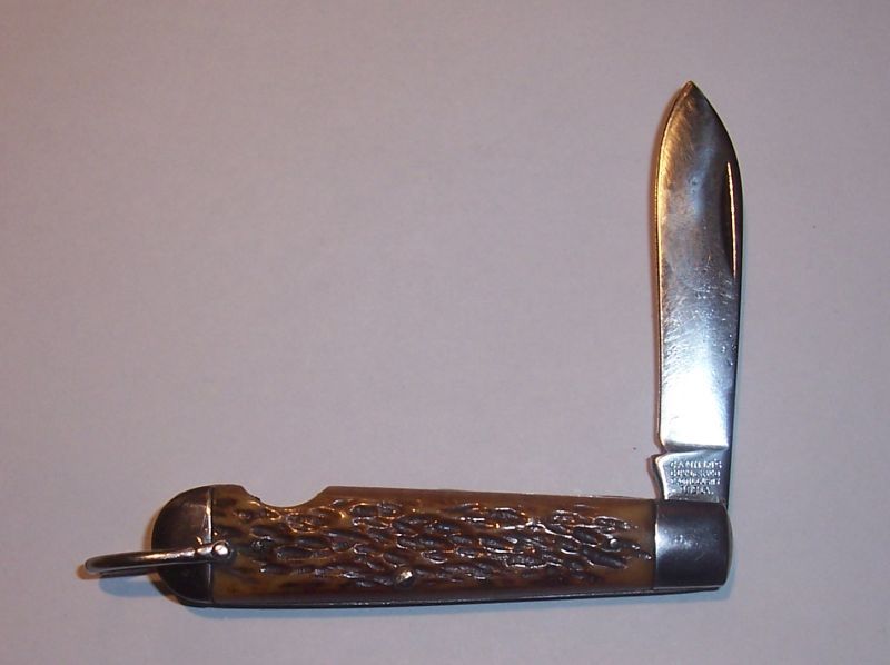

I've been looking for a place to post this one and this looks like as good a place as any. This old 4 line had the small blade broken in half, so I decided to make it a single bladed knife which turns out to be the same idea Dale had. This one measures 3 3/8" also.

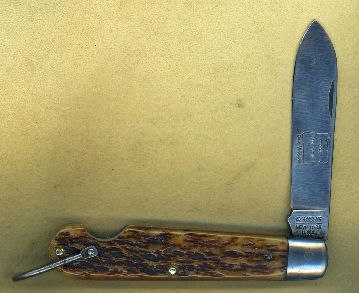

That looks great Bob!
After reading Jim's suggestion I opened up the easy open cutout about 1/8" on the TL-29 mod knife I made.
It does make it a bit easier to open.
Here are the pics:
BEFORE: AFTER: It is not a huge difference, but it does make it easier to open since the blade is brand new and has a lot of snap and a harder pull than the old worn blade.
Thanks for the suggestion Jim!
Here are the pics:

That's another great save there!
That bone is just too nice, Bob.
Nice work as usual.
Nice work as usual.

It's amazing how little difference there is between the two, don't you think? And Skyline is right where we left it Tom. I'm ready when you are.
Nice work (as always) Dale! I think I'll leave this one original on the EO notch though. I can almost pry hubcaps off with my fingernails, so this one is a piece of cake to open for me as it is. And I'm with everyone else concerning the bone on these. Downright beautiful!
