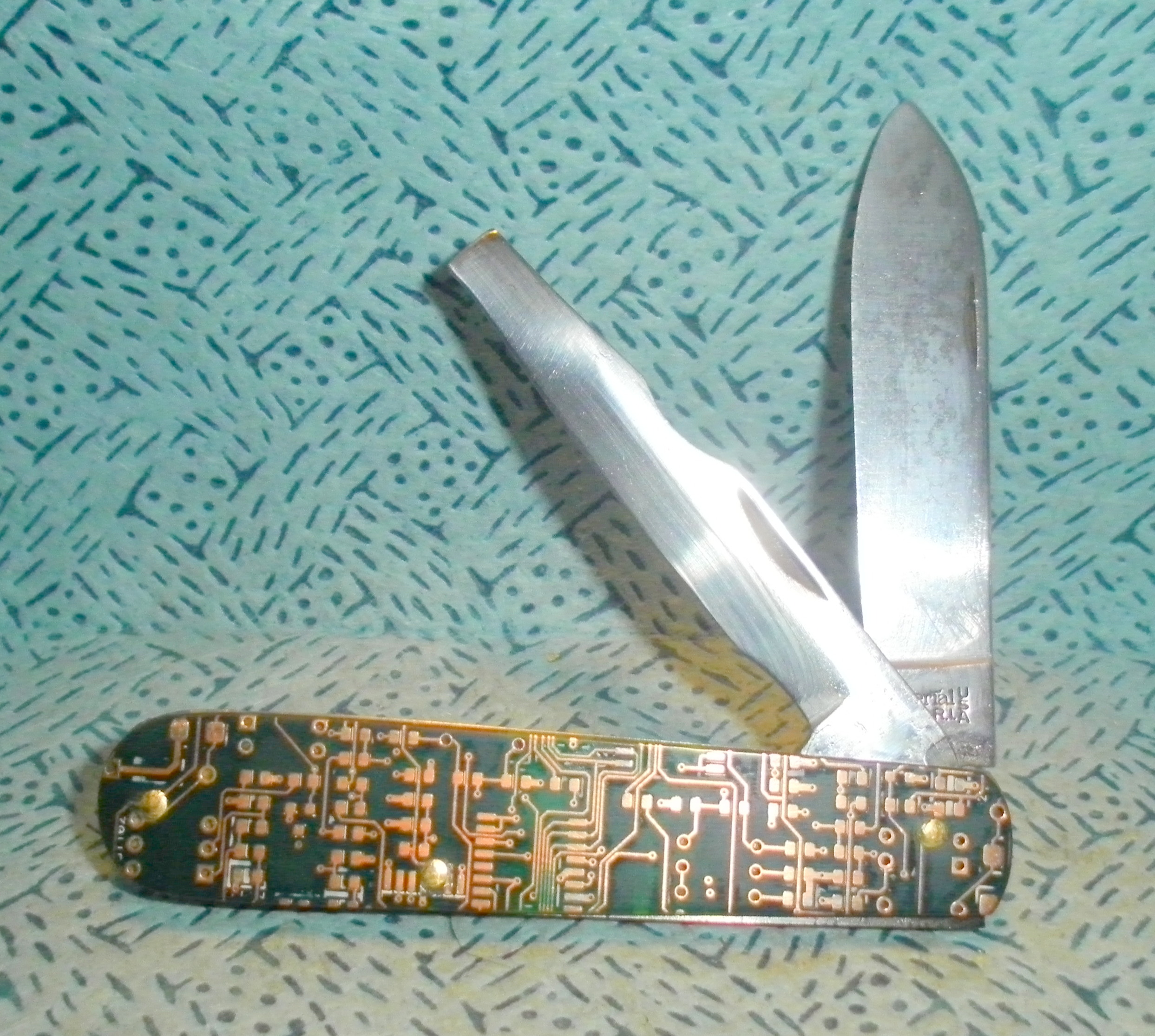

I kinda thought this would be a cool idea. The shell handles on this Imperial electricians knife were pretty much done for, so I replaced them with a set of slabs made from circuit board. The phenolic should last for ages. I also shaved the linerlock. It makes for a nice, thin, easy to carry folder. Another thing I like about these electricians knives, is the strong halfstops.

Thanks guys! My brother gave me an unused 11" x 16" circuit board and I just had to try it. It's tough stuff and makes a pretty unique handle material.

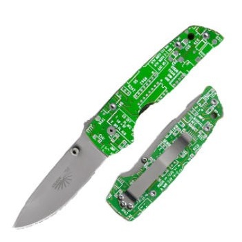

Nice use of materials. Reminds me of the Camillus cyber knife.

I hadn't seen one of those Camillus Cyber's, pretty cool! Is it real circuit board or just imprinted to look like it?

To answer your question on the Camillus, yes, as I recall they were made with real circuit boards.
IMHO, the coloration of your knife is much nicer than the Camillus.
IIRC, they were pretty expensive and were some of the last remaining stock in some stores.
They were apparently not fast sellers.

Thanks for the compliment and info, Dale! I've never had one of the Camillus knives in hand, but I do like the dark green color on the circuit board I have. However, it might have been a good idea to have taken royals advice. The fact is the circuit contacts on this board were originally silvered, but when I glued them to the liners, some of the glue squeezed out through the holes and I had to sand through to the copper getting it off. DUH! I do like the looks of the copper and green together, but without the silvering, the copper may turn green over time. Nothing to loose sleep over, but if I want to maintain the silver color, it will require a different approach then I took on this one.
