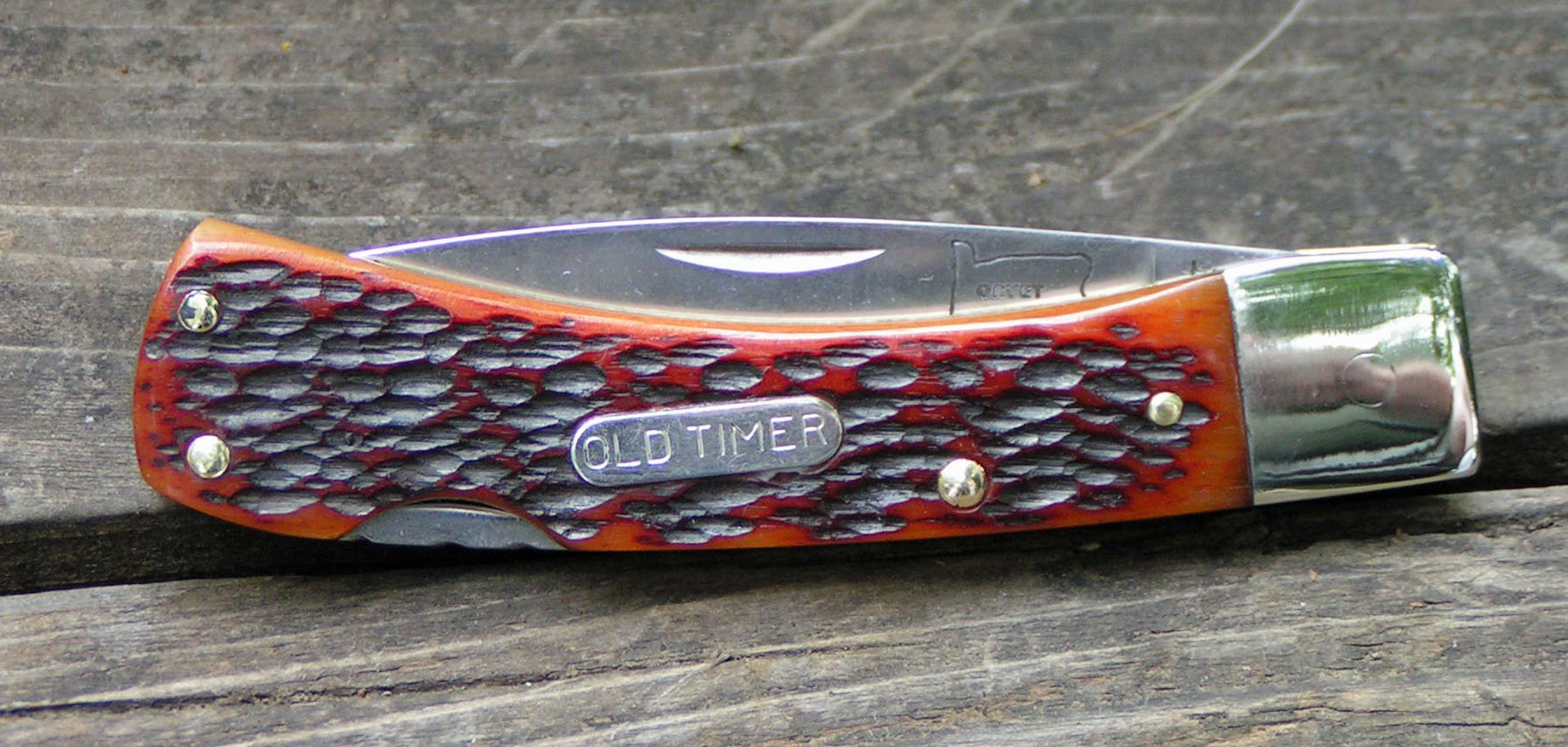

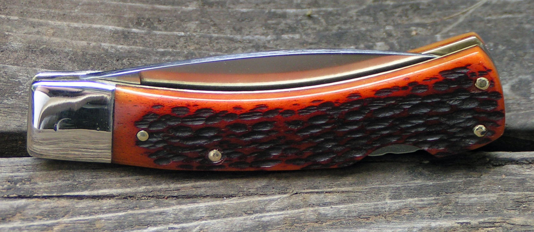

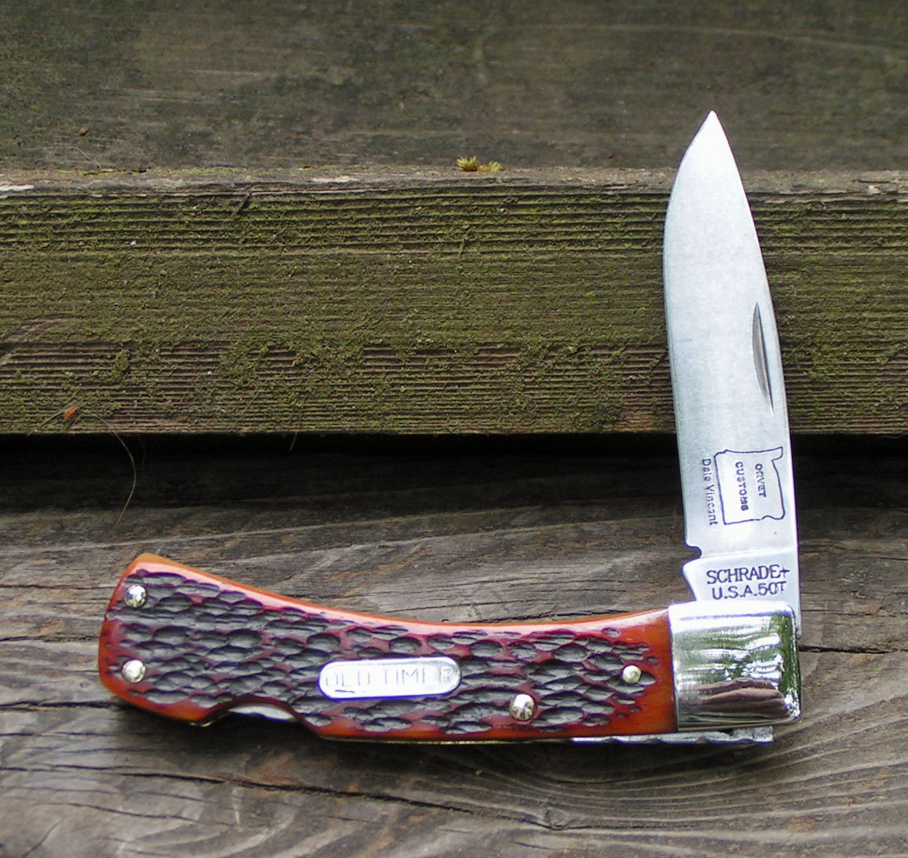

This was a 5OT that had a blade with a broken tip on the blade.
Since I had to put a new blade in it, I decided I may as well put give it the beauty treatment. :mrgreen:

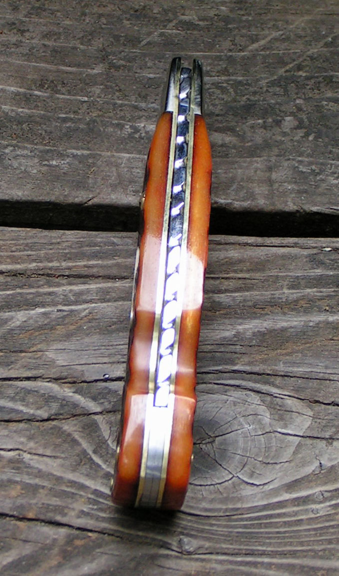

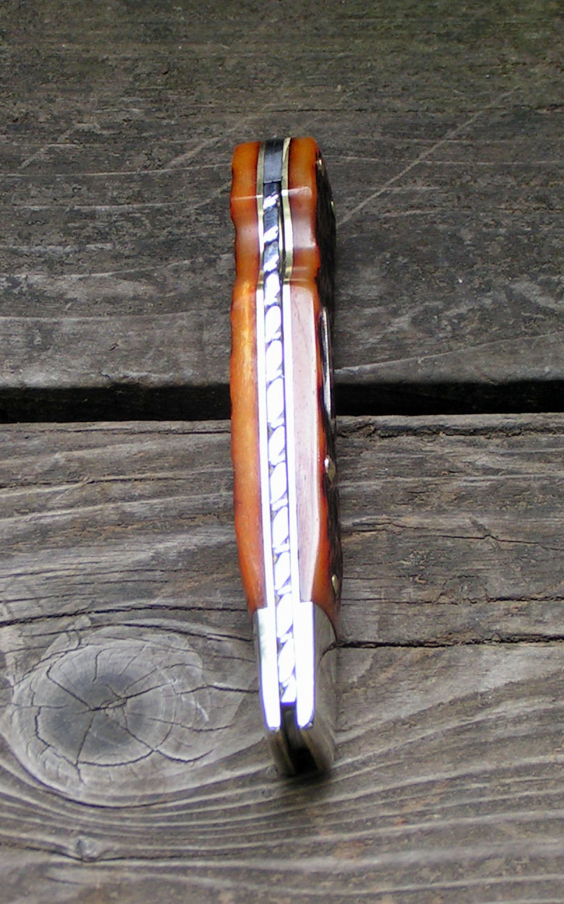

It got rope file work on the lock bar.
Sorry I couldn't get a good pic without too much glare so here is a couple angles on it.

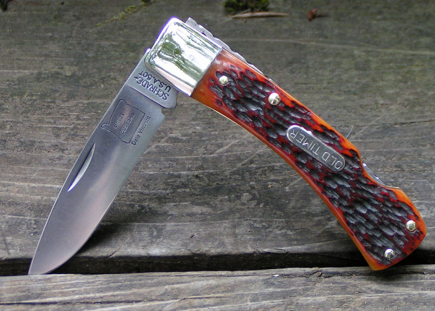

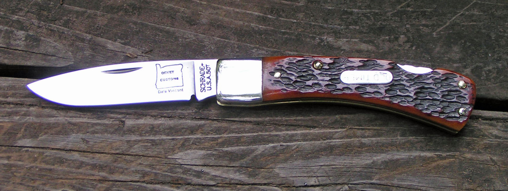

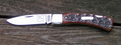

The handles are Culpepper's Amber bone with the Shetland jigging pattern.
I even copied Schrade's odd little angle at which they put in the Old Timer shield.
I am not sure why they did that, but I installed it that way so it would follow factory specs.
I will probably end up putting this one in my store, but I am tempted to EDC this one! :mrgreen:

That's a good looking Old Timer .Nice job Dale

Damn that's nice!!!
Never noticed the shield angle before. Huh, learn sumthin' everyday around here.

Dang, Dale! You been busy, boy.
That sure came out looking sweet. ::ds::

Thanks guys, glad you like it.
Glenn, I have another one to post as I finish polishing it out. It is different, but I like it.
