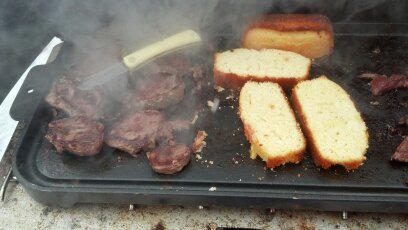

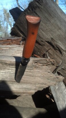

For me it was just sweat during deer season so I put the # 7 in with the camp utensiles
GREAT knife for the camp utensile box but a lot of my buddies won't use a knife with a heavy pantina on the blade
so I find they like the SS sodies better.
