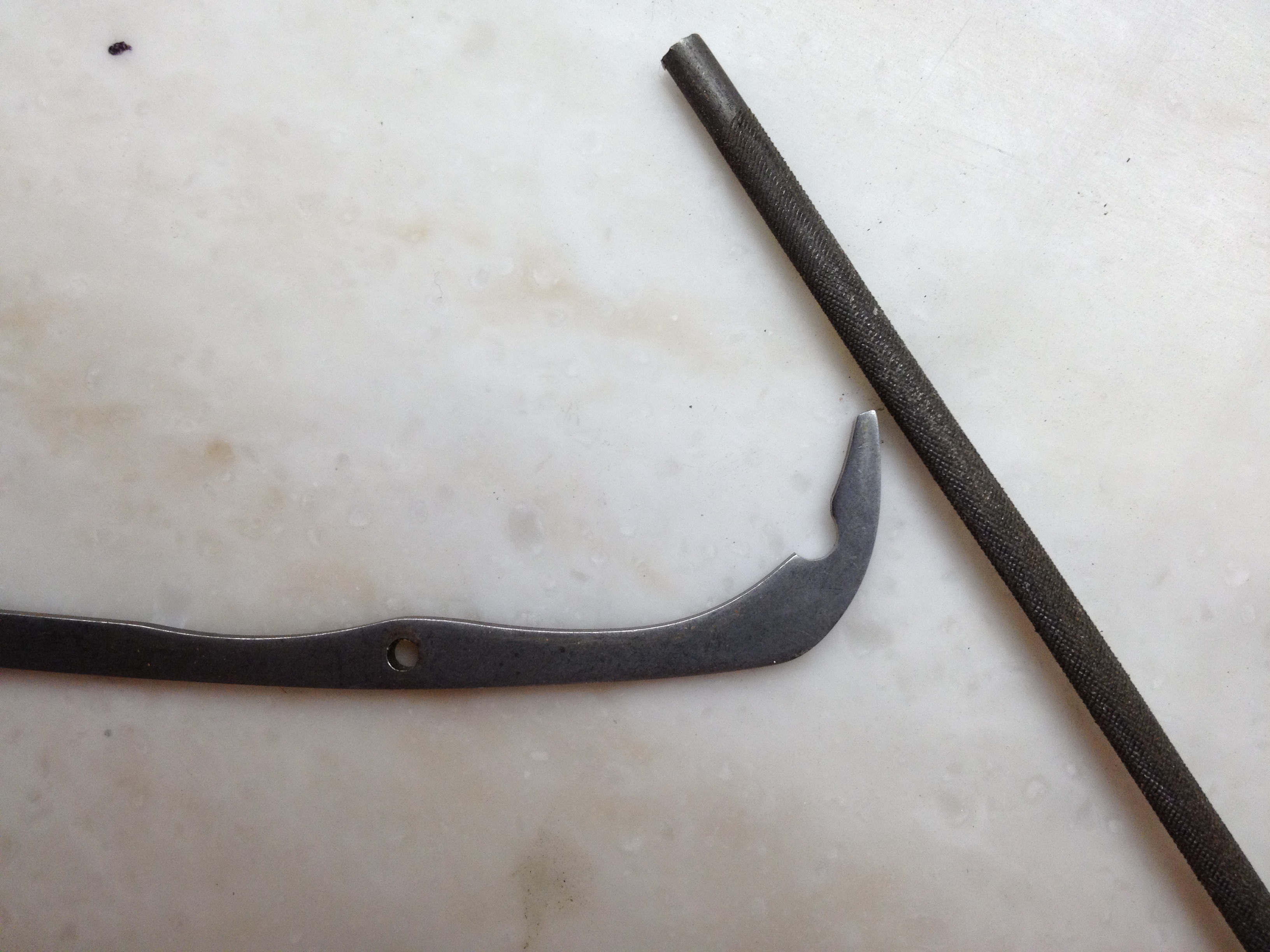

MM is right. The way I've done it is drill the hole in the butt end of the liners big enough for your tube, insert the middle pin (not sure what its called) and tube. The backsping should pivot freely, assuming you've removed the blade, and then file away at the little squared off area until the spring seats flush with the liners between the butt end and middle pin. Hope that made sense.

I now understand what was said about installing a lanyard hole: I didn't realize the spring didn't wrap around the entire butt of the knife. My thoughts of quickly drilling a hole through the covers and spring for a lanyard have been set aside. I may have to go with MM's bail idea.
