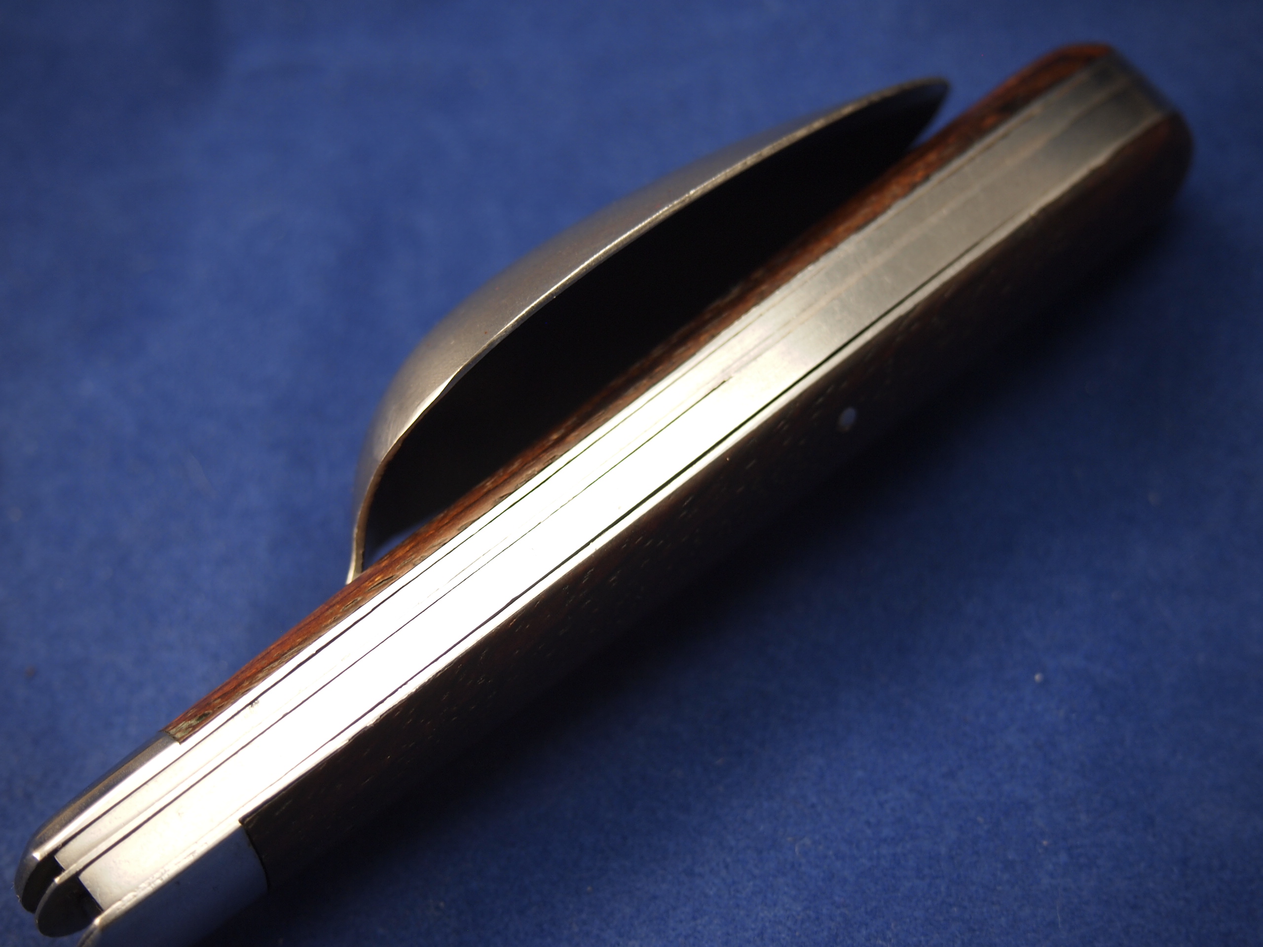

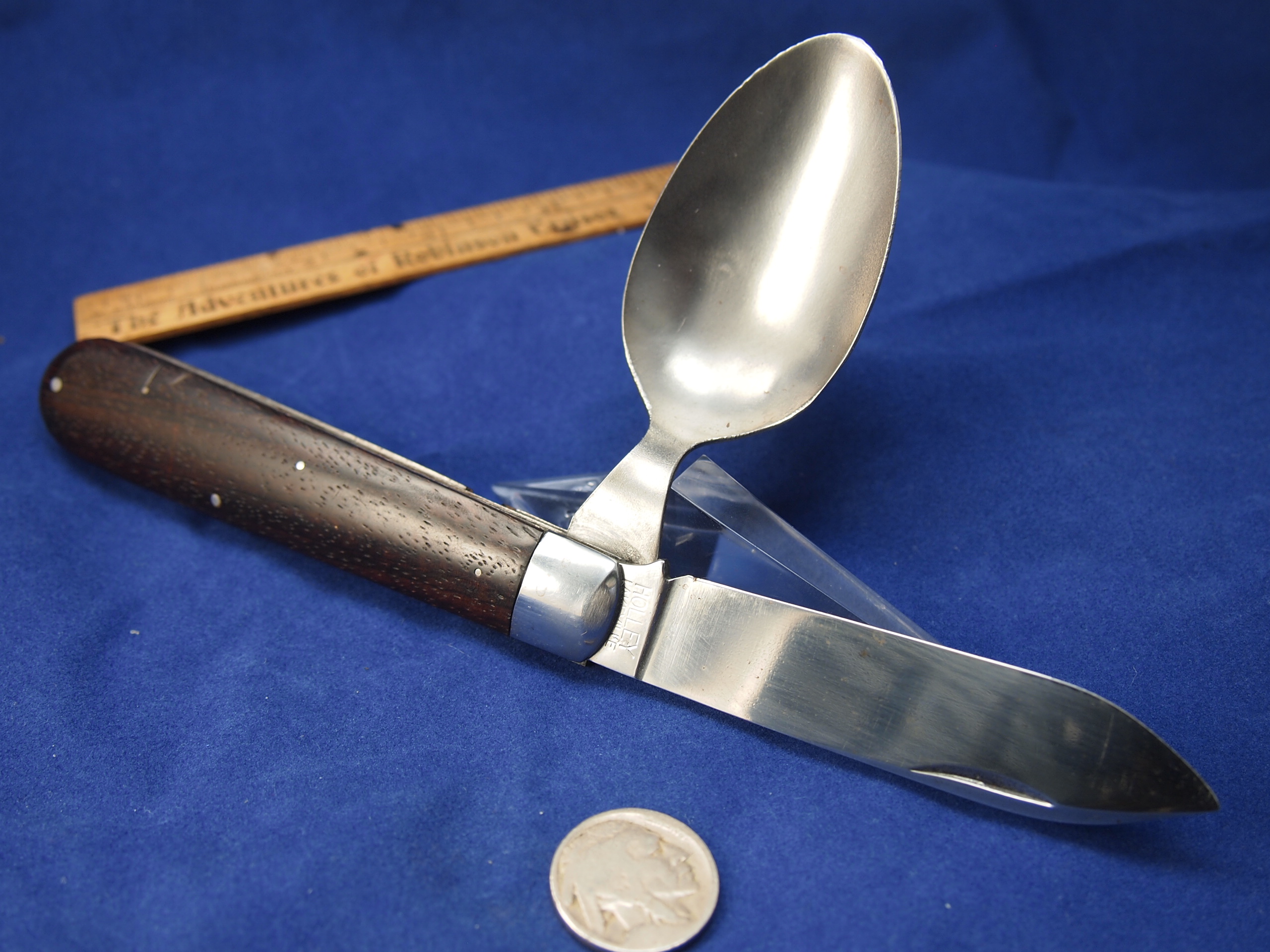

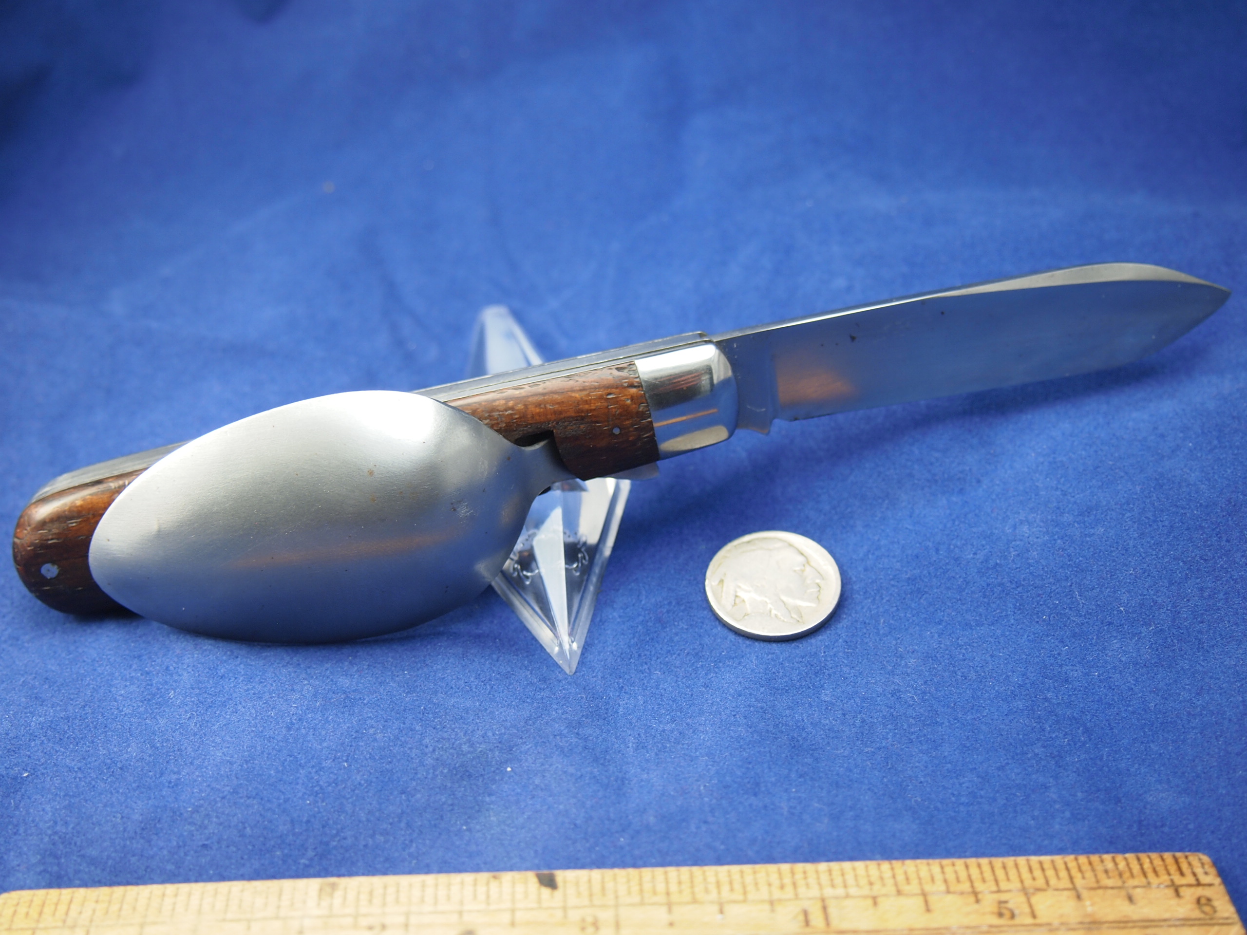

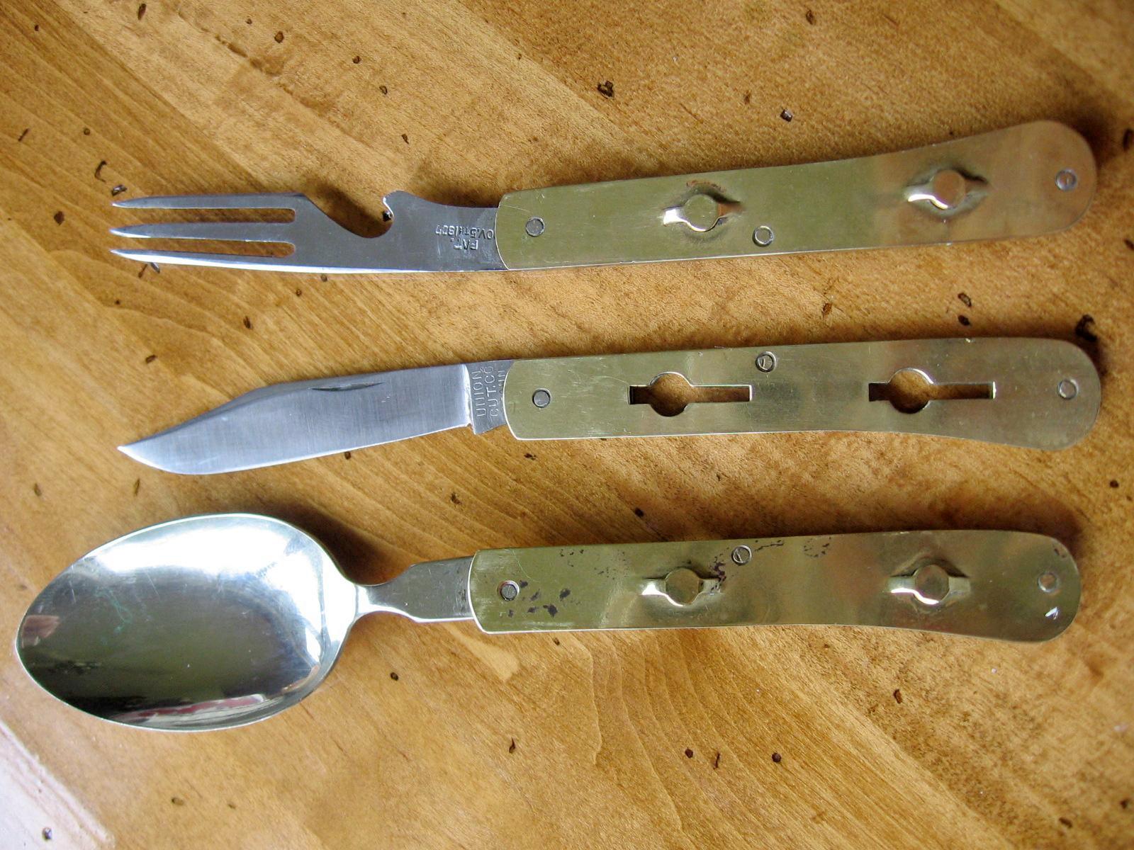

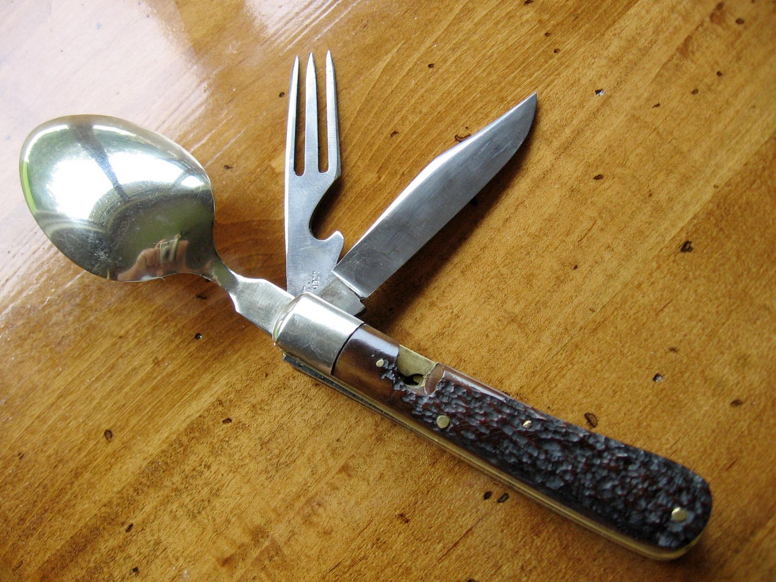

????????____Hey Charlie,these are the first I have ever had or had my hands on ??? If they are wrong,this is the way,I received them and I can't see another way to assemble them ???
_____ I took the knife apart,and there is only one way to ""assemble"" it together***________ bolster and butt end have to match ??__one piece slides up,while the other slides down to connect the slots ***__the other one I have assembles the same way, but has a can opener at the butt end*****___ wonderin' what you see ????
MONK****
MONK****

Re: EVER FIND YOURSELF WANTING ONE OF THESE? GOTTA BE WORTH

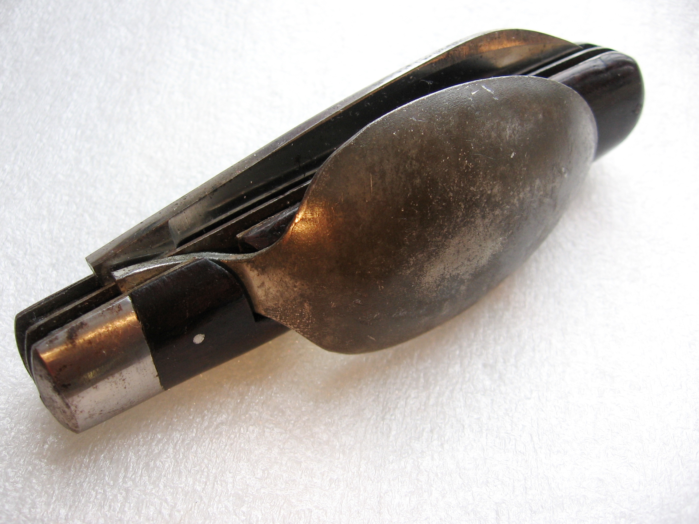

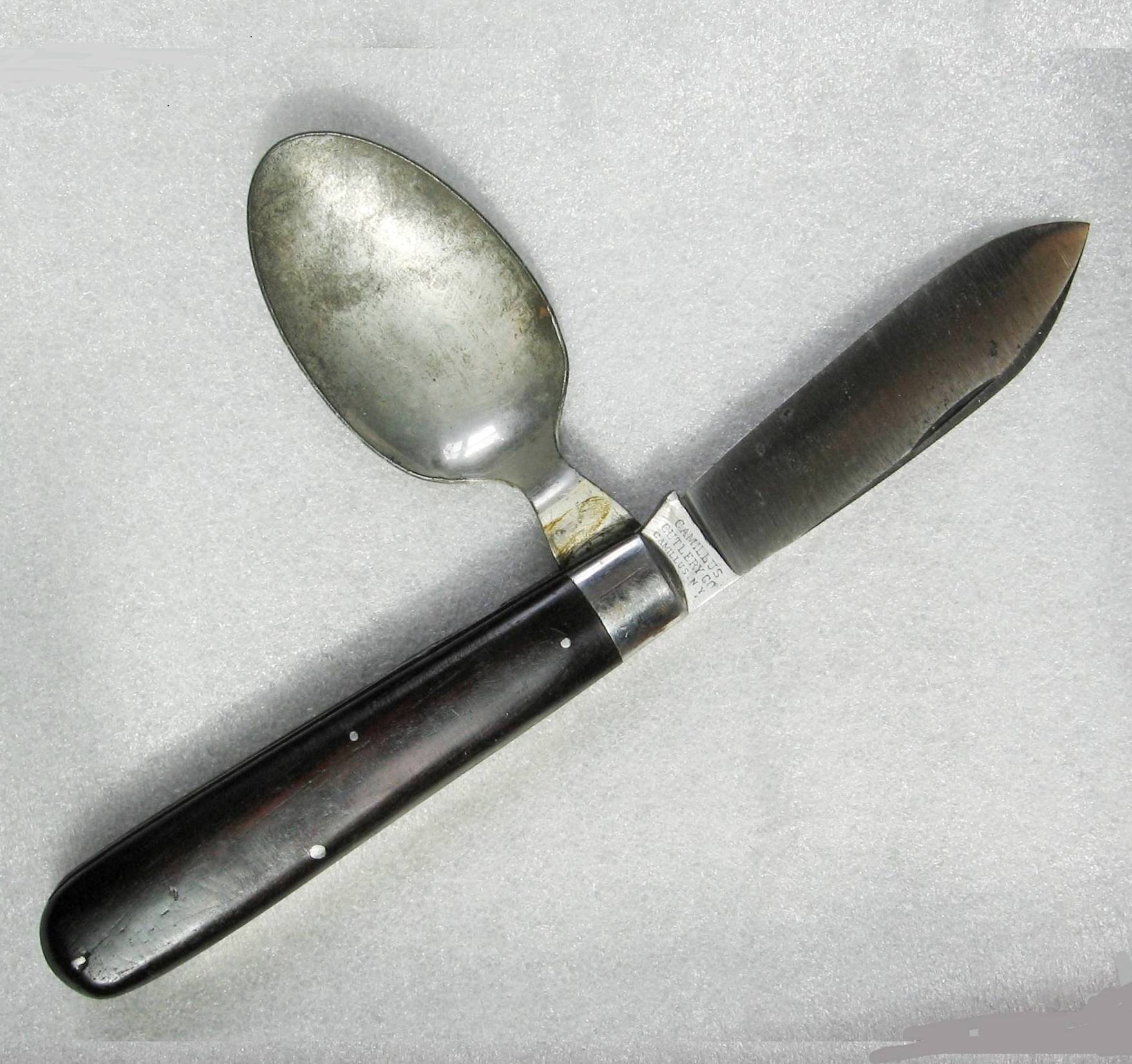

Charlie, I think what you might be thinking of is the Frary Camping knife By Frary & Son, which dates to the early 1880's. A very fine example with the etching is posted here http://www.allaboutpocketknives.com/kni ... 7&start=15RobesonsRme.com wrote:I think Holley and Landers, Frary & Clark actually made these during the American Civil War, although I do not think the knife in the OP is anywhere near that old.
LF&C did not start making knives until the teens. The type of slot knife I am familiar with as being Civil War vintage are like this... http://www.allaboutpocketknives.com/kni ... r&start=60.
I have seen them by a number of cutlery firms, including Ulster, Empire, and Northfield, ect. although not all date to the civil war. I am sure others firms made them as well.
That is a VERY fine example reddirtknives. Surely, the nicest I have seen.
Thanks for the information coffeecup, that is really neat to know. The idea of having a spoon/knife on the same non-detachable handle seems unpractical, and I wonder if the cutlers questioned its usability while they were making them.

Re: The Red Cross Holley & Camillus Big Mistake Xmass Hobo K

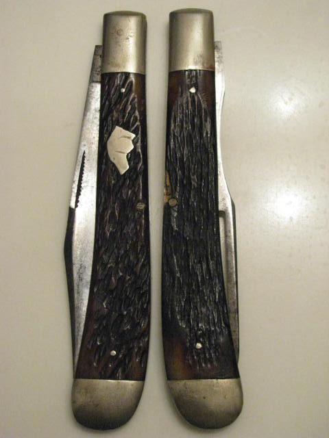

I would concur with Charlie;I don't know that got assembled like that second and third picture but it is not right. The second group of pics shows it assembled correctly.RobesonsRme.com wrote:That three piece Union is a beautiful knife, but I'm not at all sure you have assembled it correctly. I don't think I've ever noticed one of these with the knife blade opening out of the bottom of the assembled frame like that.
Charlie Noyes

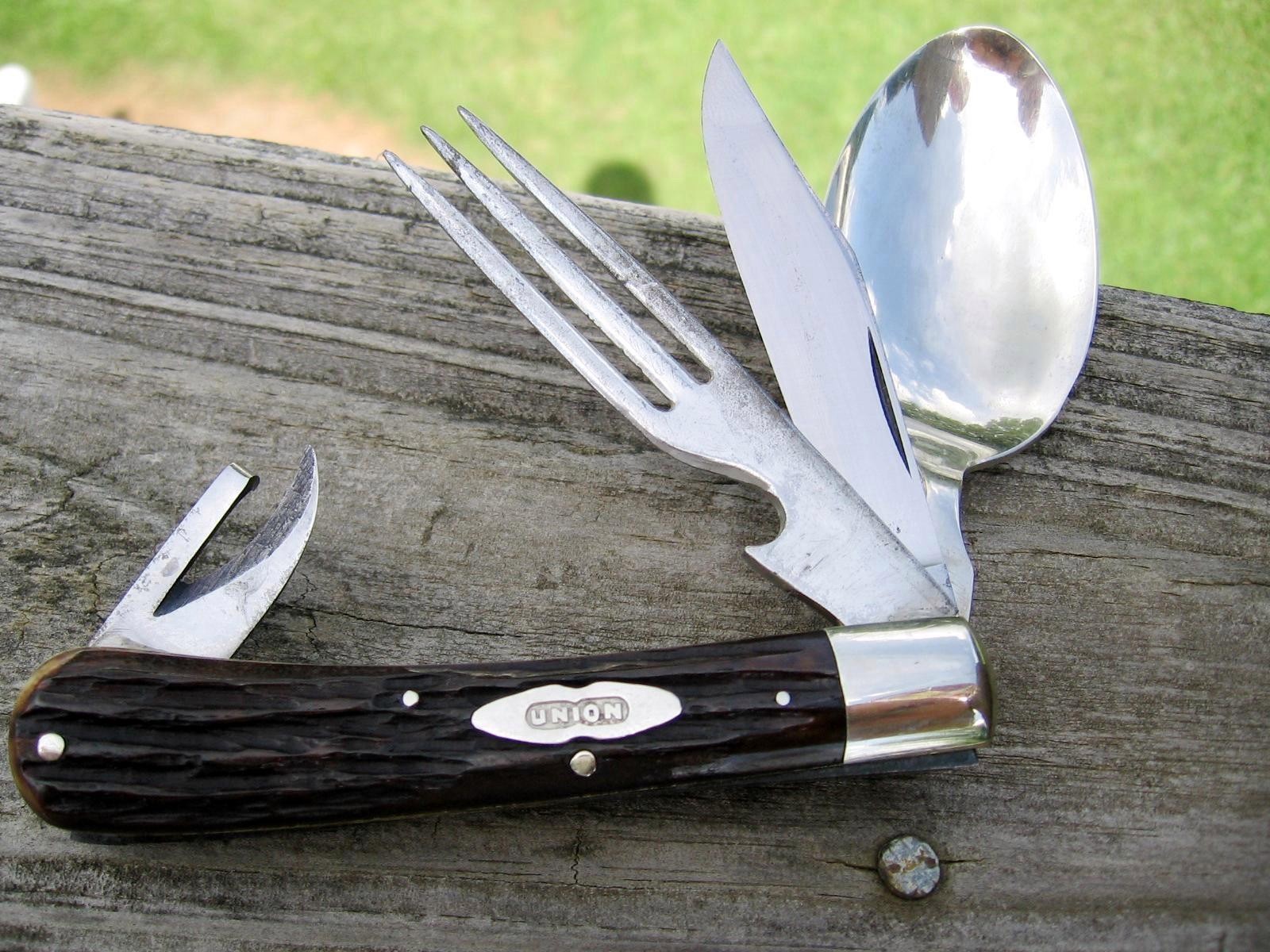

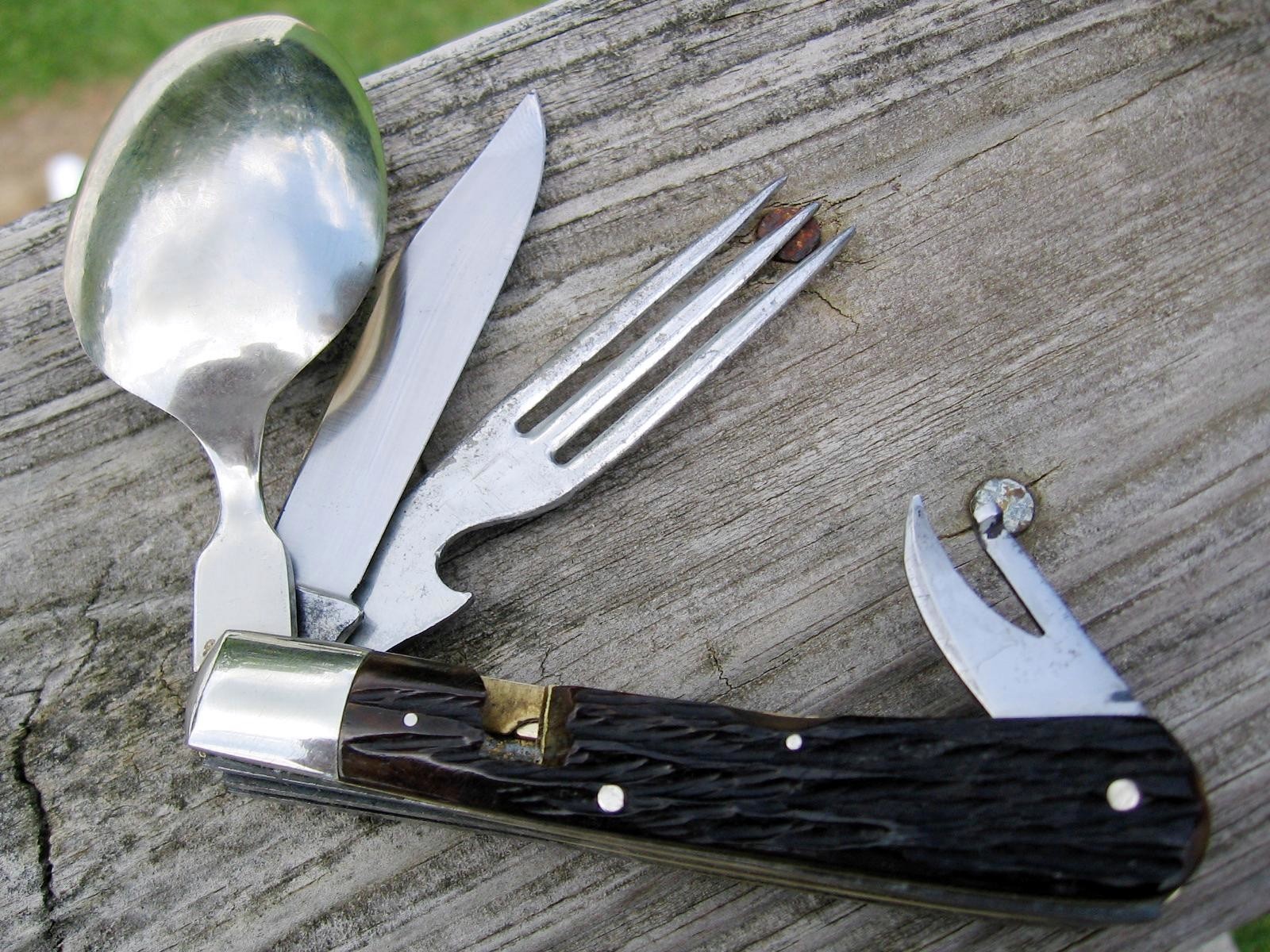

Here is my Union Cutlery Co Dogshead slot knife with just a knife and fork blade.

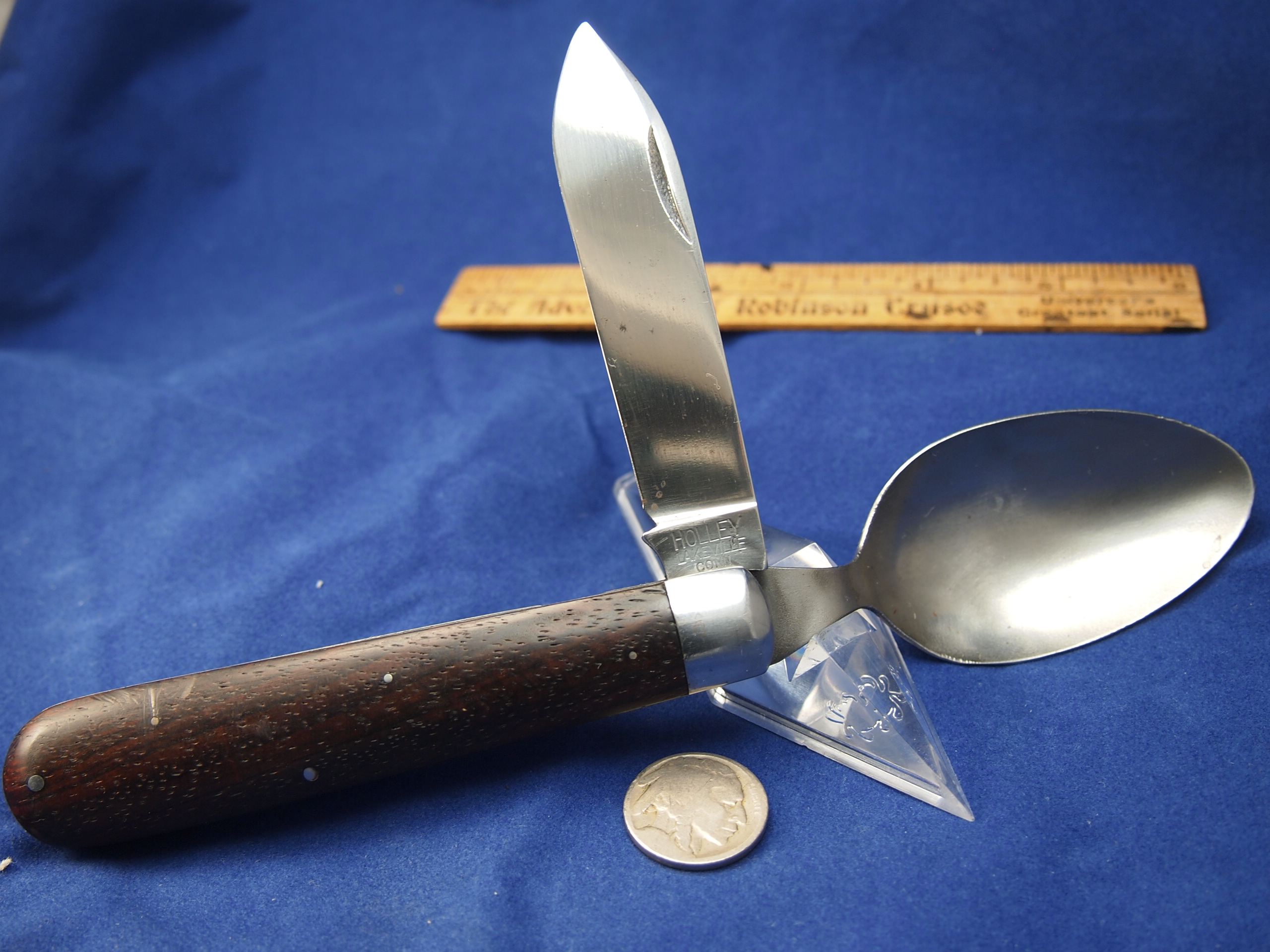

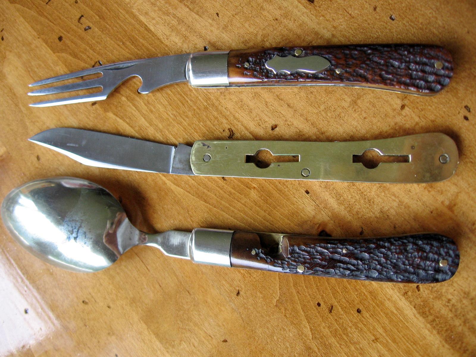

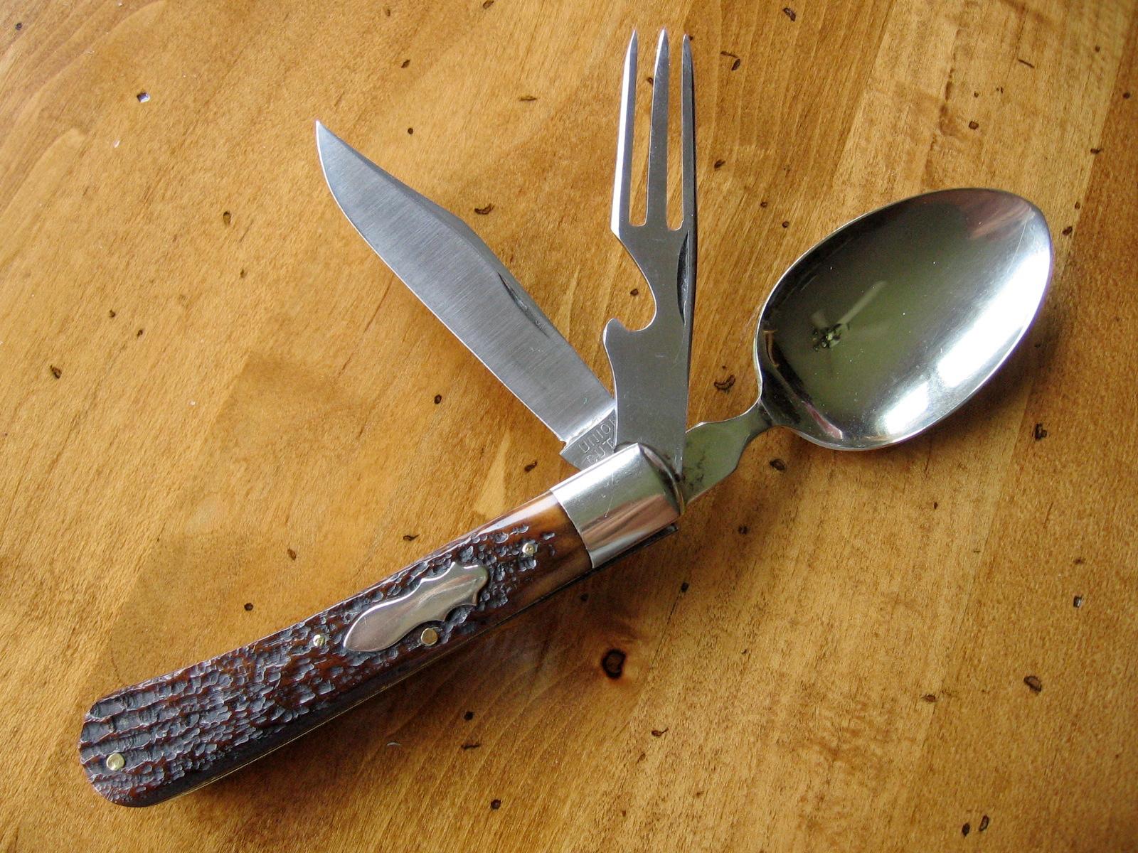

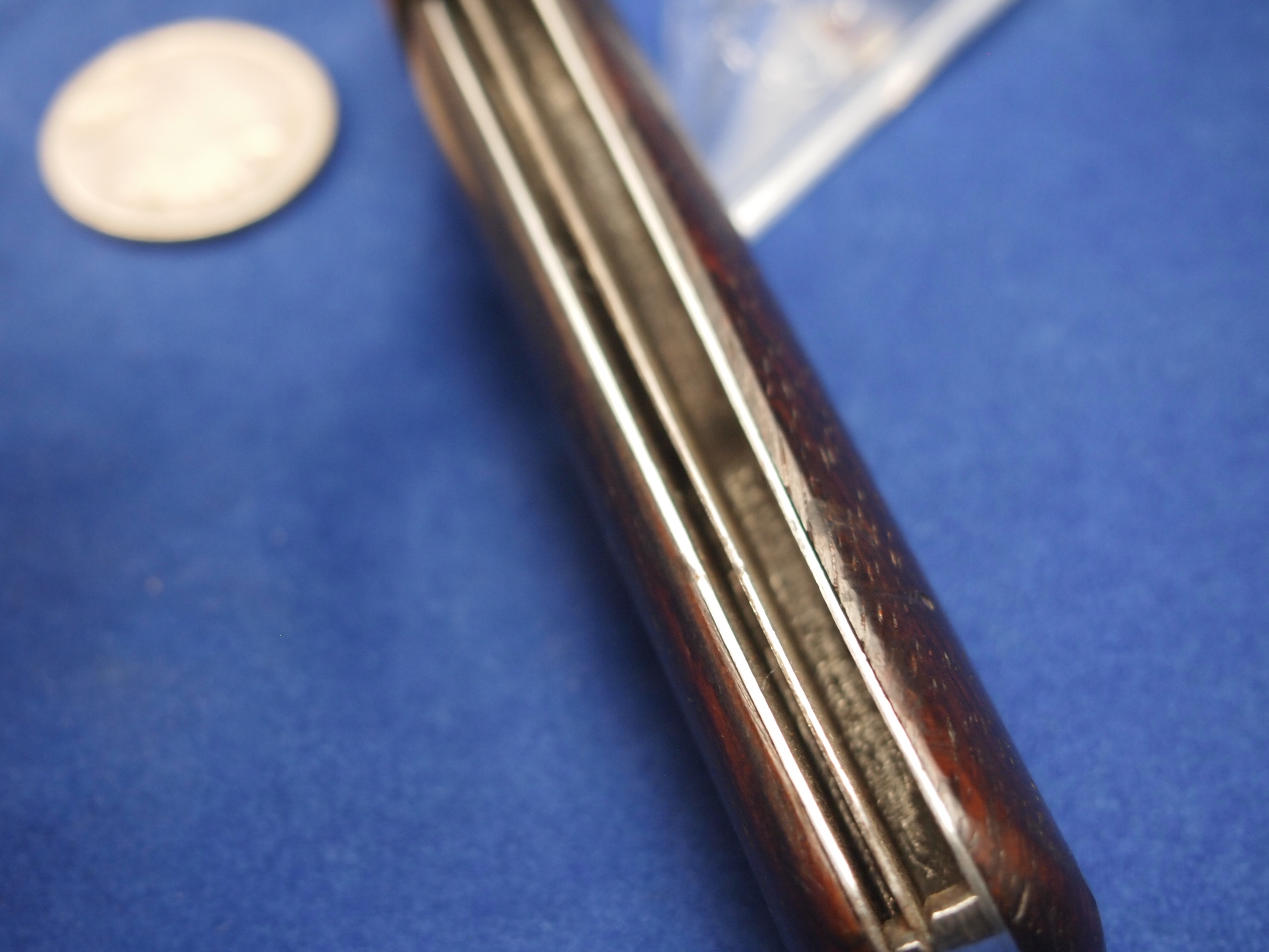

a couple more pics before I lose this knife or sell it
junebug
- Posts: 5499
man RED/TATER TIP/OK GREEN..........that knife is a cool one.
what are the scales???
ya know how some guys say PEARL gets FLEA BITES....i like how those scales have the lil KNICKS/BITES(???) in them.......
be a hard one ta lose......
hope you do well sellin it

The handles on all of the ones I've seen appear to be rosewood; those little fleabites are pores in the wood.junebug wrote:what are the scales???![]()

Yep, Coffeecups is right about the pores and I believe it is rosewood as well. Juniper berries, Thanks but I'm not selling it as of yet and I'm not sure the best place to sell it or who is most worthy of having it other than me

I think they were wrong and coffeecup was right... This Holley looks like it has Rosewood handles to me...

Here are a couple of shots of mine, which I've had for a few years now.
- reddirtknives
- Posts: 1213
- Joined: Tue Nov 22, 2011 11:54 am
- Location: Okrahoma where the wind comes sreeping down the prain

citytransplant, Nice example
Well I couldn't wait for coffeecup's test results… But I did learn that Ulster and Case also made these Redcross Big mistake knives.
