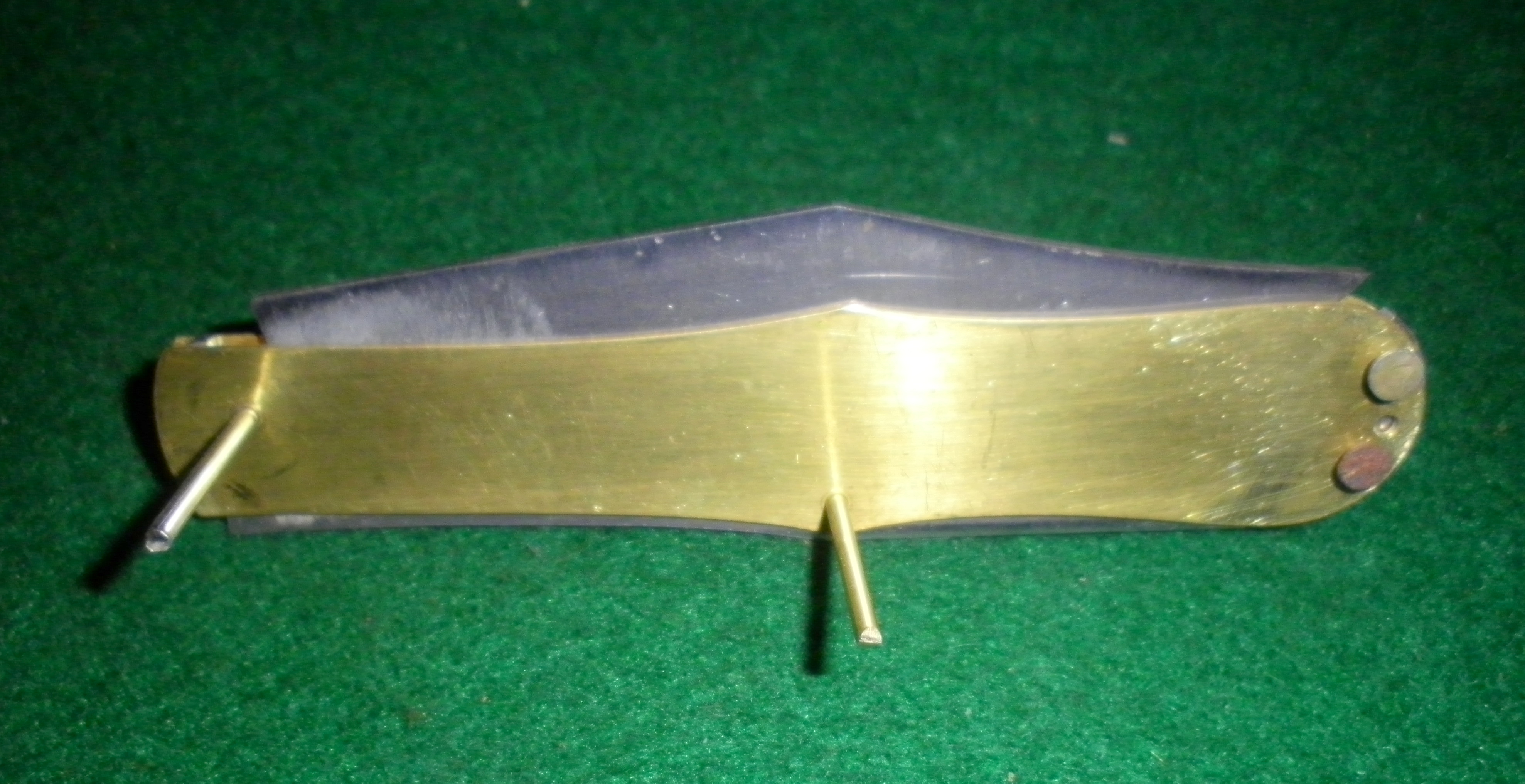

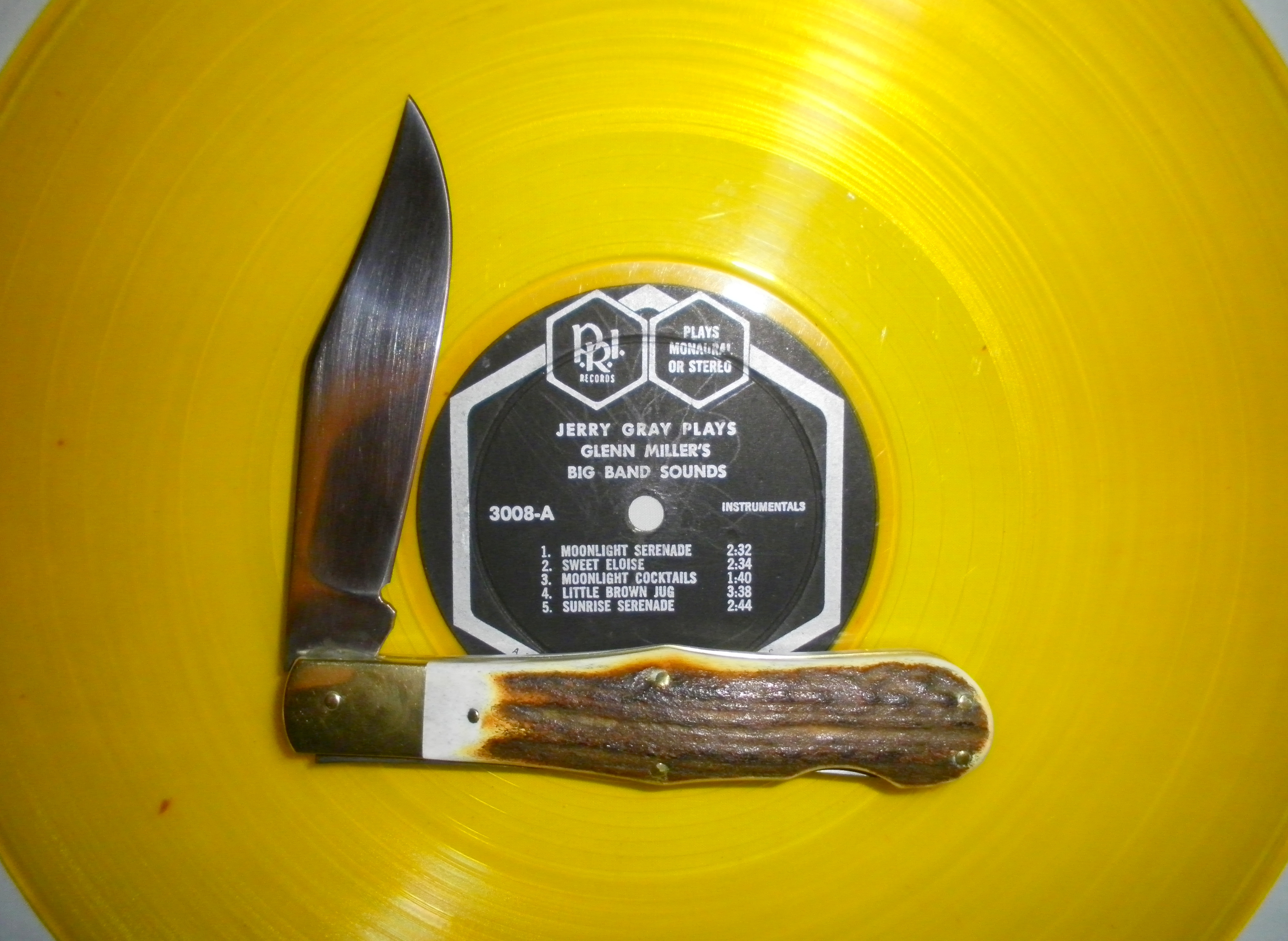

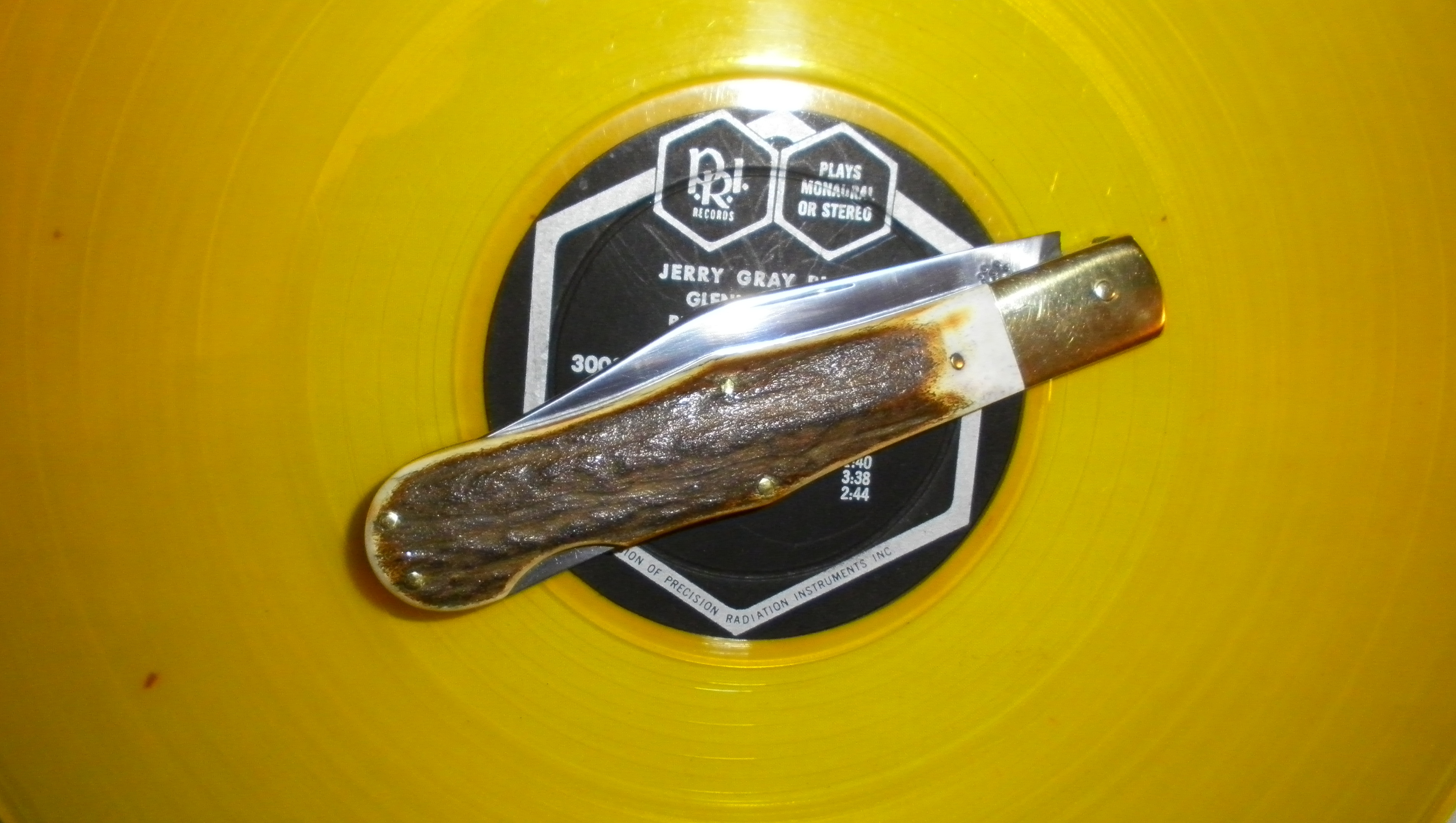

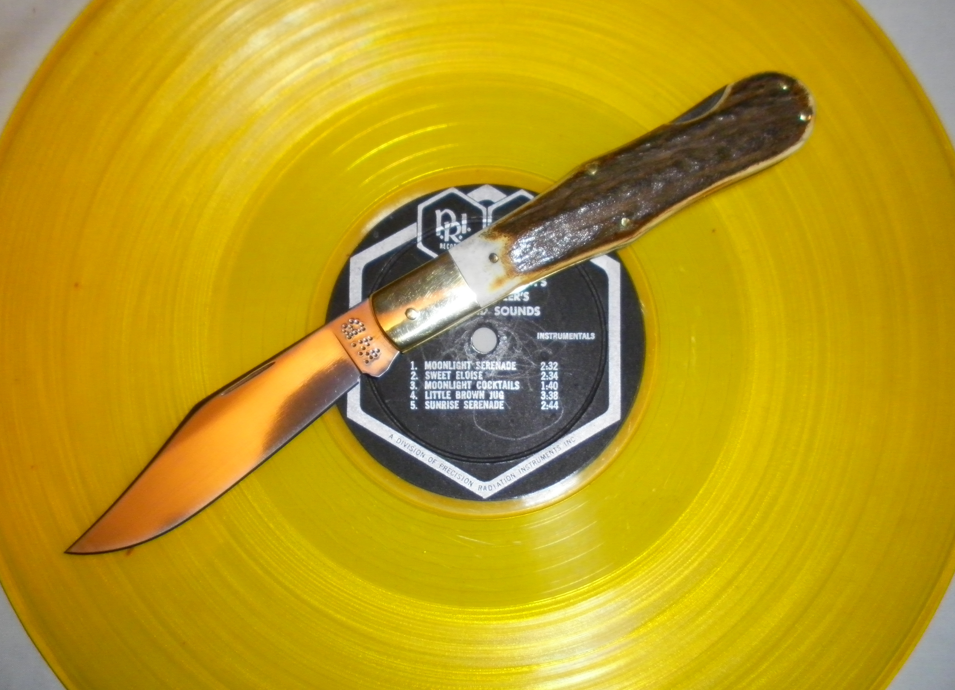

All brass frame. 1095 blade and lockbar. Toasted elk slabs. Locks up solid as a rock!

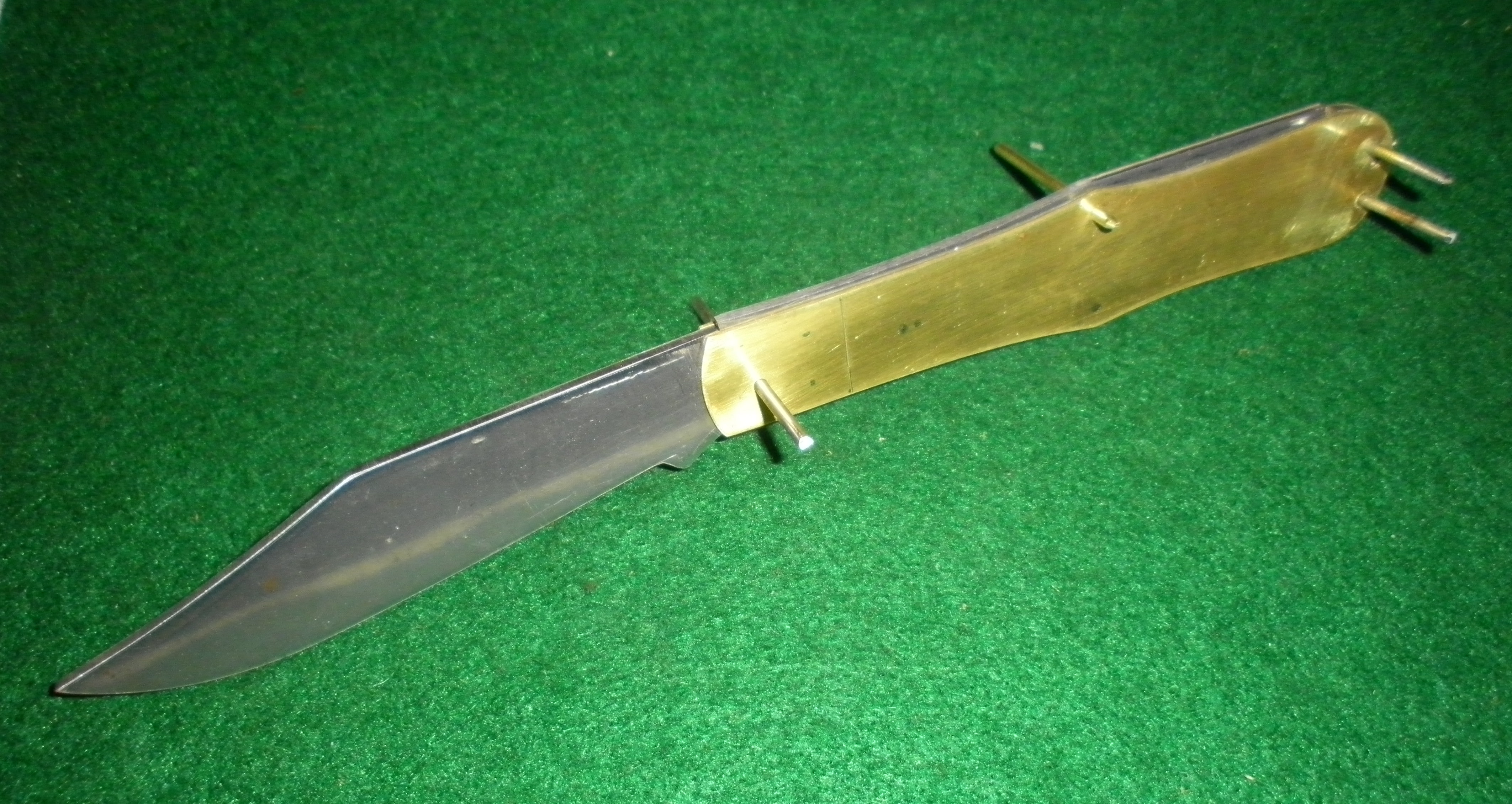

I started this one almost 5 years ago. I built a full scale working model out of plexiglas back then, but just couldn't seem to bring the whole concept together in my head. It's 5-1/4" closed and for a first try, i'm pretty happy with the way it turned out. Although, I probably should have waited for my new blade etching setup. :D

Yep, 100% from scratch. Getting the lockbar to fall correctly in the open and closed positions is probably one of the bigger challenges, but not really that much different then on a standard slip joint. I pondered quite a bit on whether to go with a locking model or a slip joint. But, I have several factory slip joints, so decided to go for a lockback on this one.

I laid out the lock bar and notch myself. Having worked on a few lockbacks and making a working model helped a lot. Neat thing about using plexiglas for the model, is that you can see through to make sure the blade has all the proper clearances and help layout where the spring needs to go. Works just as well for conventional slipjoints too. Plus you have patterns to layout your parts. I highly recommend making the models if your building from scratch, it'll take all the guess work out later.
If there is one thing that I would have done different, I would have used a slightly smaller spring. It locks up tight, but it's just a little heavy on the release.
