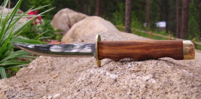

Post by dewman »
Well....It's done....sorta'. I've still got to disassemble the whole thing and heat treat the blade, but you can get the general idea. I'm still not too happy with the proportions of the handle vs. the blade. The "curb appeal" is missing that I was looking for.....but for a first time knife...???
I think the three cutlery rivets it will have when finished will add to the overall look. I picked up some leather, so a scabard (sp?) is in the offing soon.

looks very good dewman! ::tu::

Hey, For a first, second, or a knife made in the first year, you did good. Trouble is, now you're HOOKED for life. Keep on going, join knifenetwork.com and take some online classes where you build a knife along with an instructor, seems like they have a half dozen or so per year. They do have some big time full time knifemakers there. I went ahead and put that site out there since their venue is so different than ours. Keep up the good work, if you need a souce for heat treating 1095, make a post and I and some others may be able to find someone, many that do HT (heat treating) will only do certain metals. 1095 is not considered difficult so not all do that one. I do have a HT book for ferrous metal and nonferrous. They usualy run $249 each (not a typo). I found mine at Amazon.com for about $40.0 each, but it took over a yar of lookng, they just don't come up at a low price very often.
For a first time knife you did great! Keep us posted.

Nice looking knife dewman! ::tu::
Keep up the good work.
I always learn something new with each knife I make. I have lost track of how many I have made or repaired, but I am still learning. That is what makes this hobby so appealing to me.
You did a good job.

Thanks for the encouragement, guys. Sorry for not posting it on the right forum. I just noticed there was a more appropriate section for this sort of thing.
