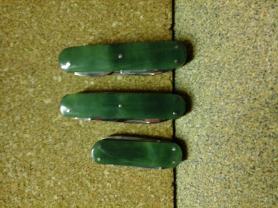

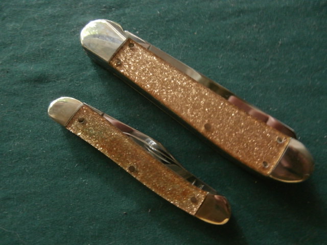

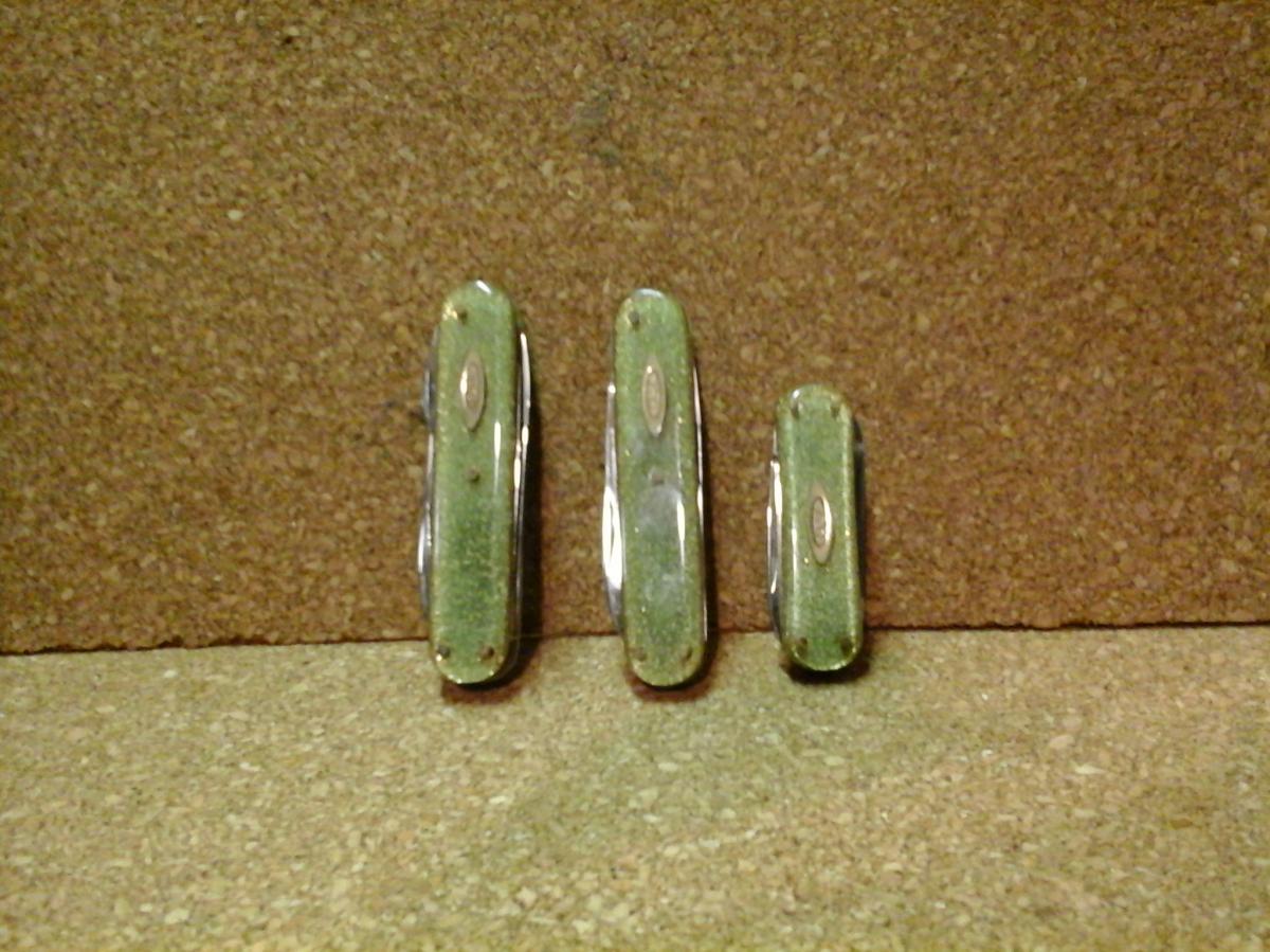

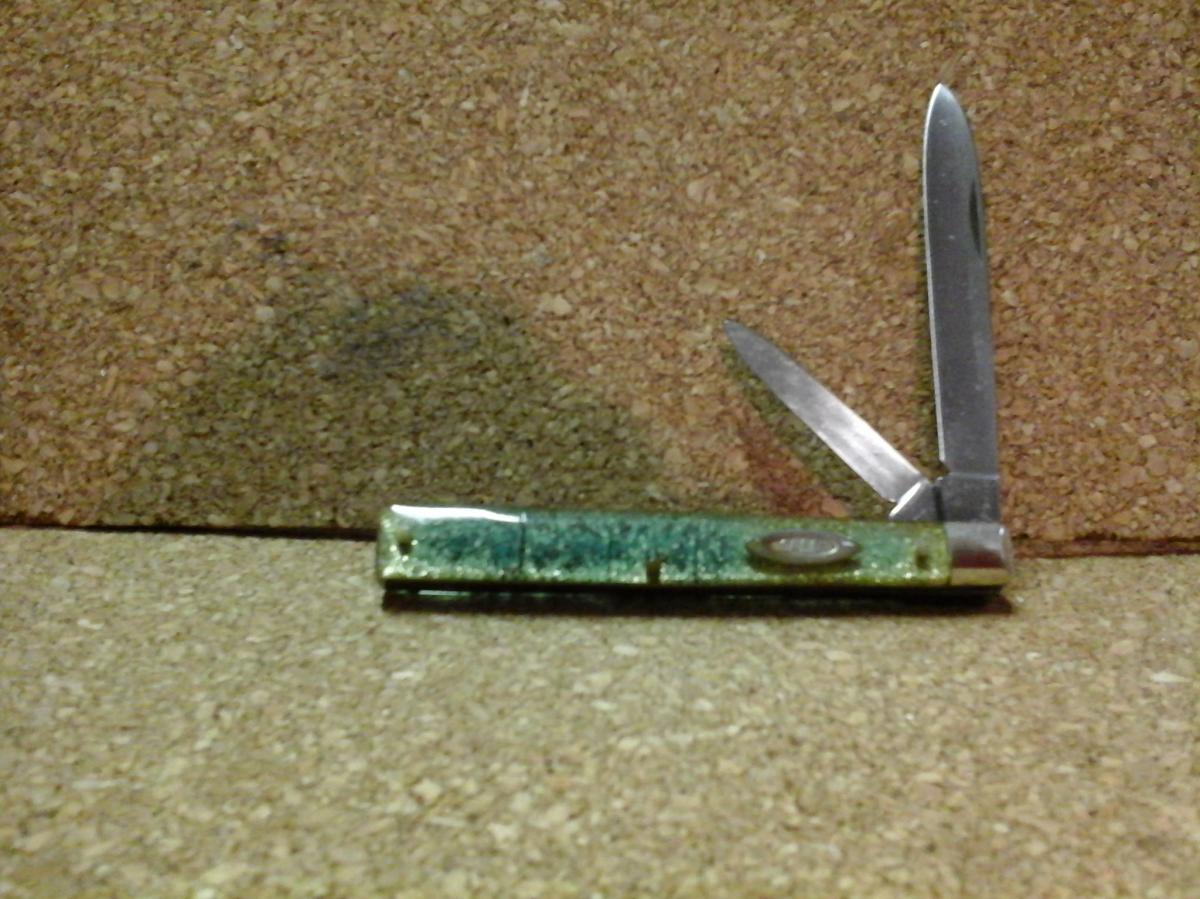

I just pulled out these two Copperheads that have been in storage for about one year. They were stored in a felt-lined, zippered, vinyl knife case with about 40 other knives (mostly bone & stag handles) these are the only synthetic handled and the only ones showing signs of deterioration. On the large Copperhead, about half the shield is also turning brown (that's the actual color in the photo, it is NOT due to light reflection) and the front (shield) side scale is turning dark and losing the sparkle. The back side shows no color deterioration. On the mini Copperhead it's just the opposite: front (shield) side has original sparkle, back side is turning brown. Both knives were stored side-by-side with shield side facing upwards. My question is: Why are they losing the sparkle? and Can anything be done to halt further deterioration? Any suggestions are welcome as I have no idea why this is happening.

Definitely remove the celluloid knives from the others. You can read all known literature about celluloid but bottom line is no one knows why it deteriorates, or how to stop it.
Once it starts it will not stop. If it hasn't started, it will eventually. There is extensive discussion if the topic on this forum - use the search function, keyword celluloid.

Once the celluloid has started to break down, there's no stopping it. Contact Case Repair as they should be covered under their warranty. 1-800-523-6350

My daughter had 4 Goldstone Case knives that were outgassing badly. I sent them to Elvis/Bob. He rehandled them in acrylic and they turned out beautiful. Here are 3 of them.

David, those look nice...almost like jade. Just curious, what does a re-handle job like that cost, approximately? Also, did the celluloid affect the blades or liners at all? On my big Goldstone Copperhead the shield is half brown and you can see the beginnings of discoloration along the edge of the bolsters.

The outgassing did corrode the liners causing the covers to look green. The shields turned brown, no bolsterss on these knives. It did cause corrosion on the blade of the doctor knife. Here are before pics of our knives. Keep in mind these all were Goldstone.

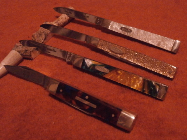

But, back to the celluloid handle issue...How is the best way to store them to minimize or delay the outgassing problem? Or is there absolutely nothing that can be done? In all my research and reading about this problem, I couldn't find anything besides simply storing them individually, wrapped in acid free paper in an airtight, waterproof container.
Here are some of my other celluloid handled knives. Notice the Goldstone Dr.'s knife still has that sparkly brilliance that attracted me to this material in the first place (like a blue marlin hitting on a stinger lure!)

I have a little bit of good news for you. From nearest to farthest, the second knife is Corelon and won't break down like celluloid. It's safe to put back with the others. If the celluloid knives aren't showing any signs of problems you can give them a good coat of Ren Wax, store them separate and hope for the best. Any signs of rust, tarnish or anything else that doesn't look right is probably due to the celluloid and those handles should be replaced. While it's always a good idea to get bad celluloid off of a knife as soon as possible, if you aren't familiar with how to do it without damaging the knife, leaving it on there a little longer until you can get it into the hands of your chosen repairman is probably best.

You are correct...the White Pearl (at top) is also Corelon. Not sure what the scales of the Bulldog (at bottom) are but it's a newer one so it's probably Corelon as well, or whatever Bulldog Brand uses that is similar to Corelon.

The imitation tortoise shell on the Bulldog is also celluloid. Even though it may be a newer knife, a lot of the German makers still use it. It's been noted that the lighter colors of celluloid tend to begin the breaking down process sooner than the darker ones, but still it's always a crap shoot. I have seen knives less than 10 years old begin to break down while others still look perfect after 100 years. Other than the lighter ones starting to off-gas sooner, there is no rhyme or reason to celluloid. It simply does what it wants. Case has used celluloid a few times since those 1989 goldstones, but mostly on their "Select" line that still gets nickel-silver liners. The ones I have are candy stripe as well as good old red bone.
