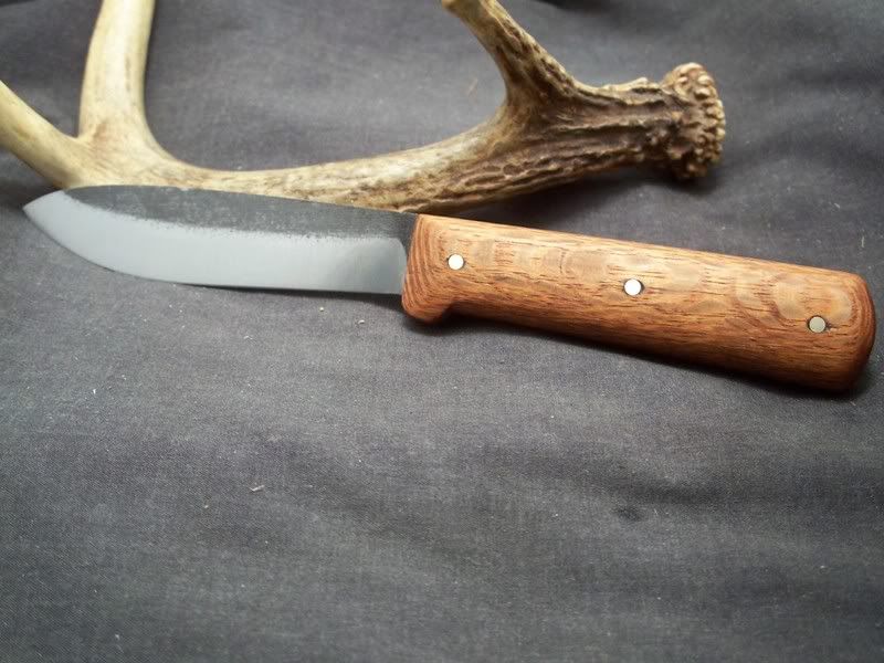

This knife is based on the knife that Horace Kephart supposedly carried on his adventures. I added a little more roundness in the belly of the blade. His was a little more straight. 4 1/2" blade is from and old crosscut saw, handle is Maple Burl. The sheath didn't quite come out like I wanted, but it works.
The pic shows how the blade is in the handle. It's held in by epoxy and 2 peened brass pins.

Nice interpretation of the design Wildcat. Here is one I did up, off original dimensions, only difference is mine has a high scandi grind instead of the flat grind of the original. I like to recreate these old knives

that is a nice one for shore ::tu::
how thick is the blade on yours?
Mine is 1/16" thick. Modern knifers would say that is way too thin. Those old woodsman would prolly think it is just right. I know it will slice without binding.

mine is aboout 3/32". alot of the old knives were thin. I've made some really thin knives, andthey do slice well. When you flatgrind 1/16" steel it gets silly thin on the edge :lol: when you sharpen it you can almost see the edge bend when you press it on the stone, then it will spring right back up after the pass is done. :D

do you heat treat your blades made from the saw or do you retain the saw blade hardness?

it depends on the knife.
Do you?

when I use the saw blades, I leave them as they are. I dip the blade in the slack tub after every two or three passes to keep it cool.
I do the same thing with files when making a knife from an old file.
