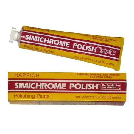

P.S. DO NOT USE the Simichrome on Knives with Etched Blades!!!
