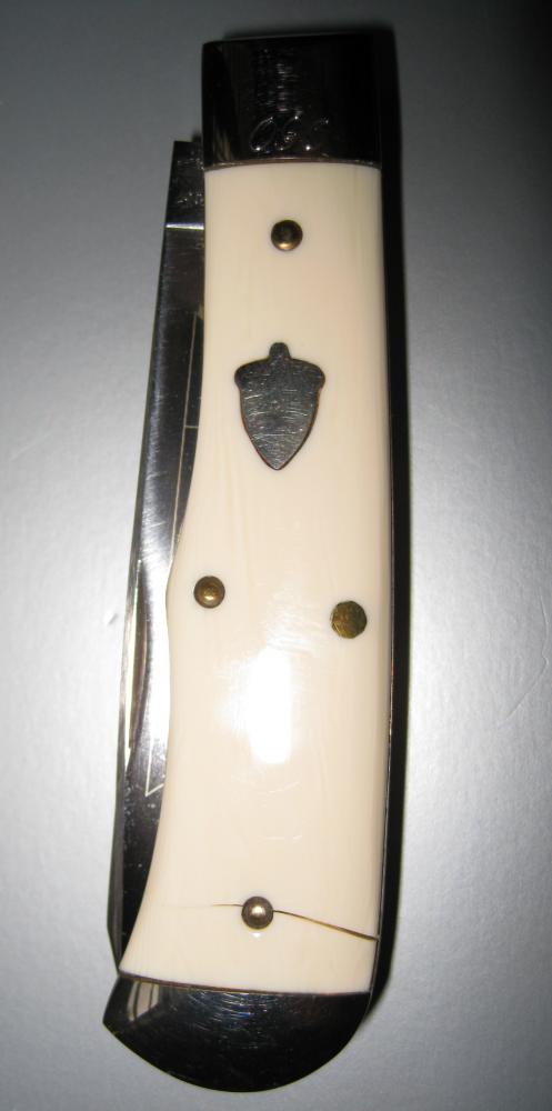

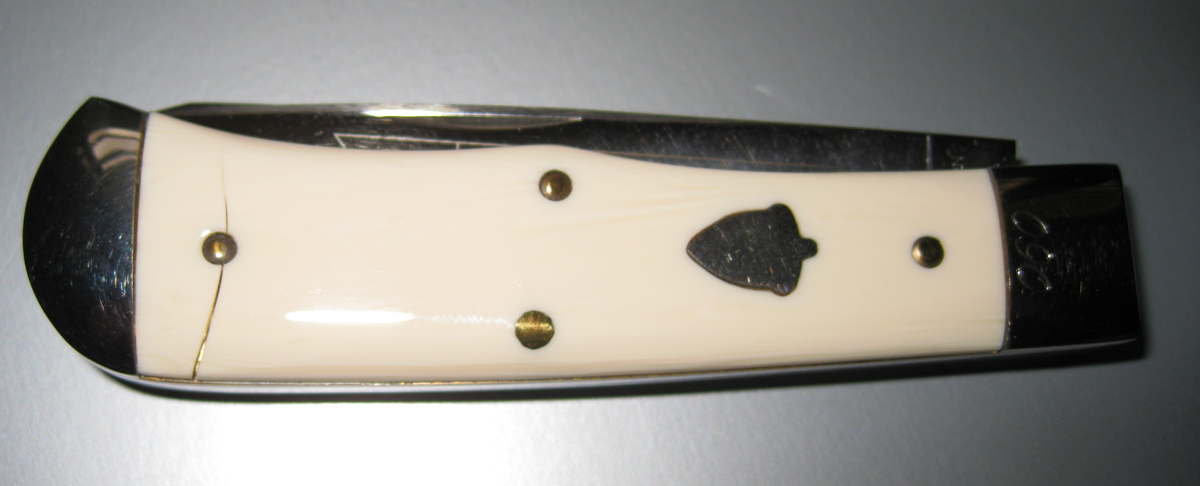

Had a real Bummer, :roll: when I was going through some of my GEC's this morning I have this #73 Ivory Casien put away in my Gun Safe, Ren waxed, wrapped and in it's little tube. Never used or carried! Now Low and Behold it has a nasty crack on the bottom pin! ::dang:: How the Hell did that happen??? ::shrug::

Wow Mitch! WTH? That is a nasty crack too, you can see the liner it's so bad! My condolences on the loss of your scale... can't imagine how that would have happened ::shrug::

It's not the first casein handle I have seen like that. Might be why they haven't really used it since. ::shrug::

::facepalm:: Mitch, ivory is really touchy stuff to work with but beautiful. Probably what happened is that the hole was not big enough and the pin was pressed in and over time the stress caused the fracture, or the ivory wasn't completely dry and that drying out over time caused the crack. I have made quite a few fixed blade knives using ivory but have never had one crack, I have learned the hard way and got some too hot when sanding and that will cause hairline cracks, but they usually don't get larger. I drill my holes for pins a few thousands over size, then peen them slightly and epoxy them in place. Not much you can do with your knife now except maybe put a little super glue in the crack to keep it from getting any worse. Also I recommend using minerial oil on ivory from time to time. good luck, terry ::tu::

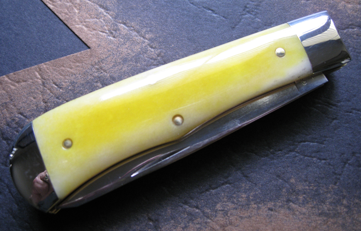

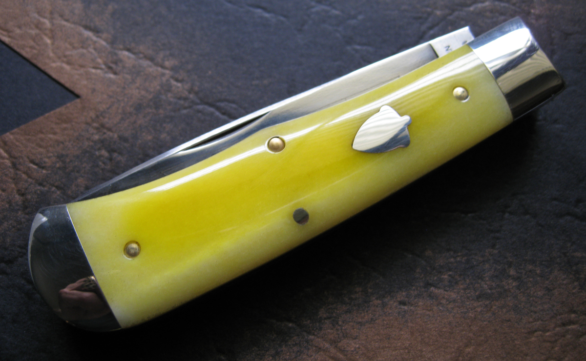

8) Well! Here's the end of the Story. I received my knife from GEC and they rehandled it in Smooth Yellow Bone for my $25.00 and I am neither Glad nor Sad, I am feeling rather ambivalent ::shrug:: about this knife right now! I really did love the model with the Casein Scales and now it's Gone! At least the turn around time was Outstanding! I mailed it on April 11th and got it back on April 24th.
