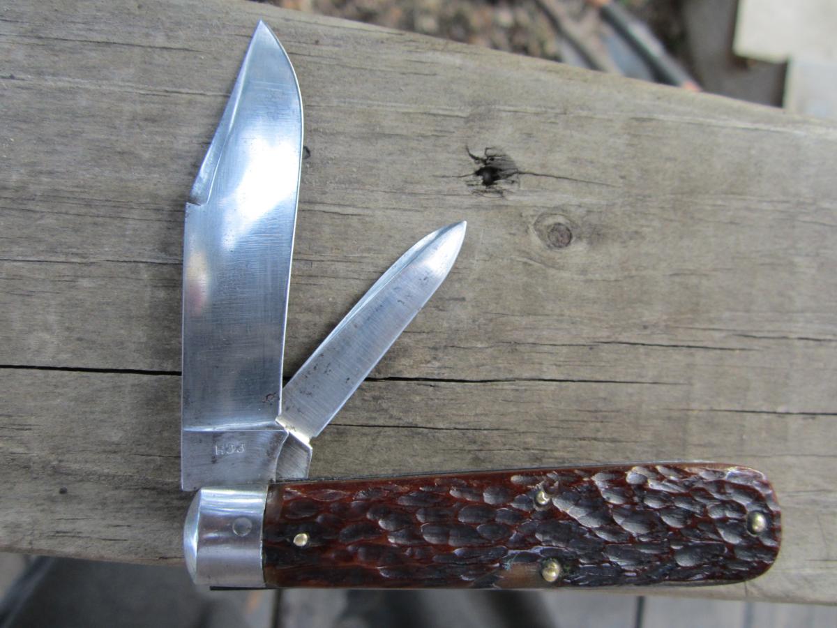

Anybody like these sweet ole barehead 33's
Snaps like Hillary clickin SEND_ALL on a top secret email

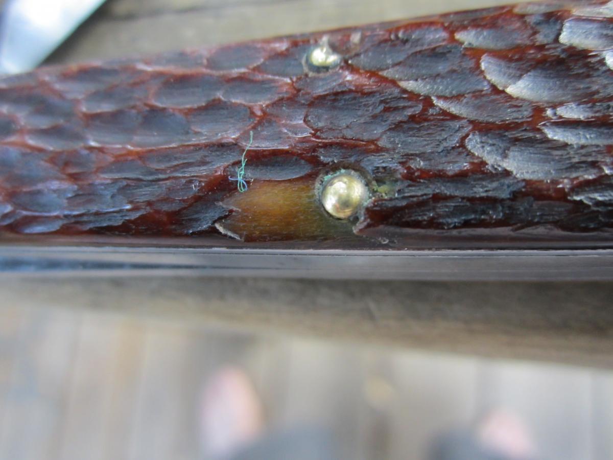

Etch remains... but ama askin anybody know???
SWhat marker or dye i'd use on the pile side chip?
its not completly gone.. jus the top layer of bone gone.
bottom layer remains awaiting lil dye or marker or
mebee a lil dash of Lady Clairol Liberace #606_J??
preciate any input...

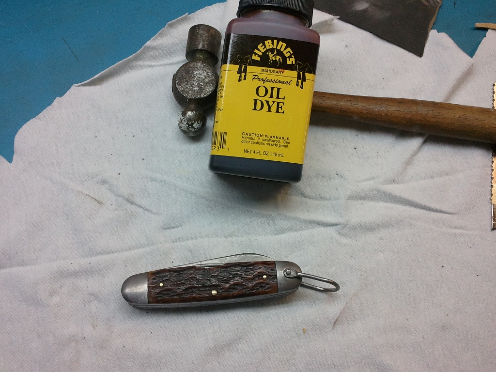

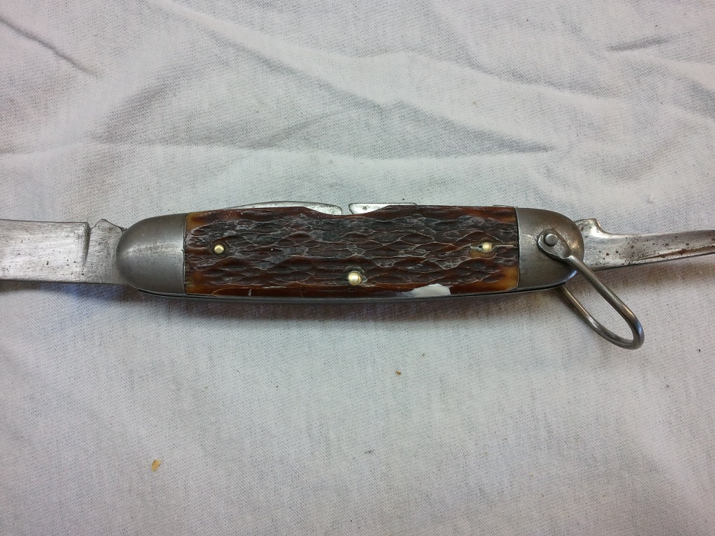

Personally I would use the Fiebing's mahogany oil dye. That ol Remmy bone looks pretty close to the Utica scout I just fixed.
BEFORE AND AFTER
An that's on epoxy. No doubt it will stick to bone. I did this a couple weeks ago and it's still holdin after pocket use.
BEFORE AND AFTER

I use a variety of brown permenent markers for small chips like that .
