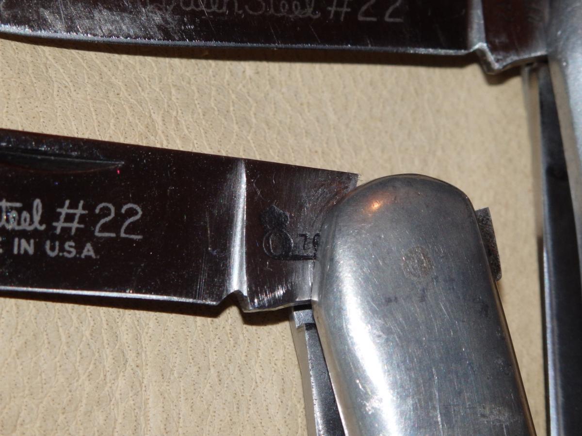

Queen #22
- QTCut5
- Posts: 6630
- Location: Napo'opo'o, HI
Re: Queen #22

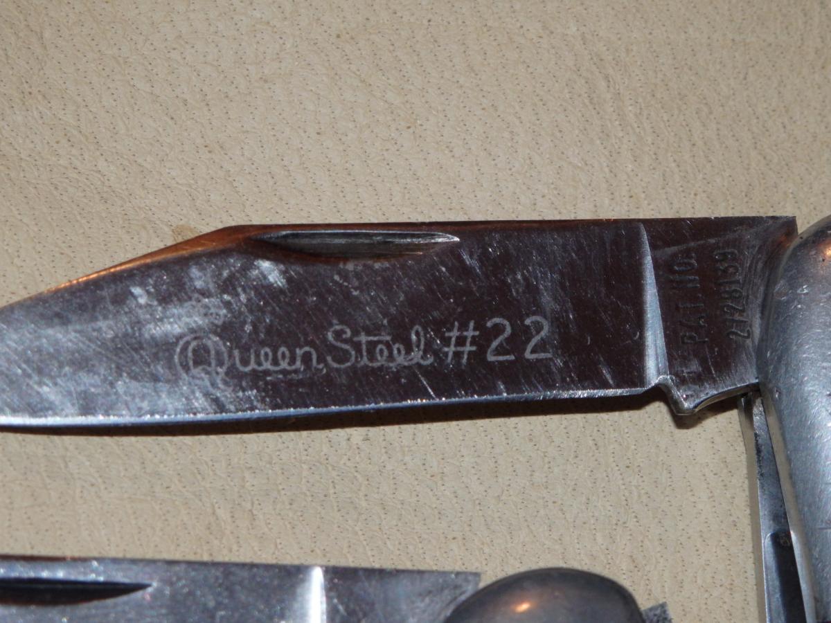

It's definitely a stamp...I can make out the Q with the crown but not the rest of it. I own several Queen knives that have the same issue...the tang stamp is corroded but nothing else. I had always just assumed it was due to poor post-production polishing that didn't penetrate into the tang stamp, but I really don't know.
Cool looking knife though, despite that one little "smudge."
~Q~
~Q~
~Q~

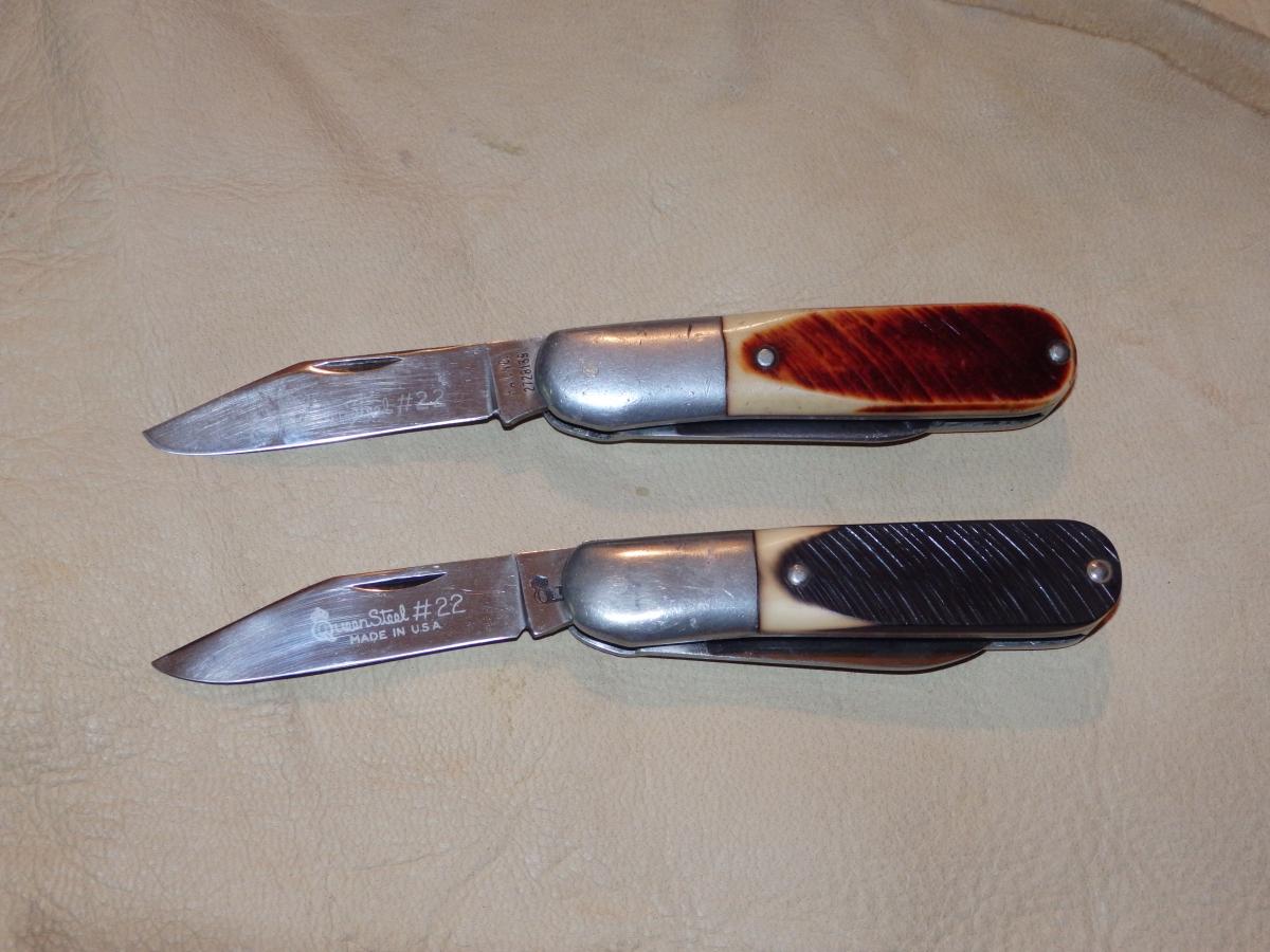

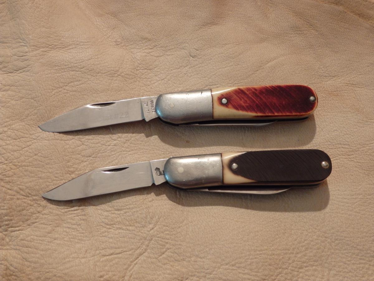

Re: Queen #22
Neither of mine have any marking on the smaller pen blade, main blade on darker brown one is stamped '76, reddish one just has pat. pend #'s, like yours....I always assumed that was the older of the 2, but, IDK....

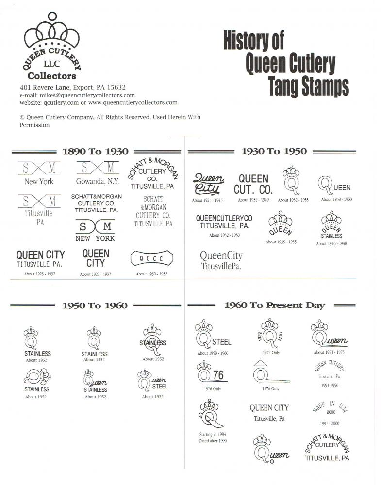

Re: Queen #22
Please see the attached Queen Tang Stamp page and the enlargement. 1973 – 1975 I believe.
David Clark

Re: Queen #22
The Schatt & Morgan key would be very nice to have. Jerry D keep plugging on that!
Re the 22 barlow, my eyes cannot distinguish the tang stamp well enough to see if it the one David Clark suggested (73-75), or the earlier one that looks very similar from '58-60. I am inclined to agree with David Clark on the70s. since I have seen many from that period with the same kind of "smudge" damage on the tang stamp - more common than not. And knife from the early 60s would most likely look like it had more wear. Ever see sawcut delrin from the 58-60 period? The only 22 I own (1992) has identical darker brown delrin. Early barlows may show patent pending, not the actual patent number.
Fred Fisher has helped me to appreciate these aluminum frame knives - innovative, relatively inexpensive to manufacture, but very durable in hard use situations -like their cousin, the big chief.
dan
