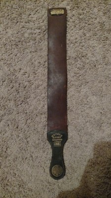

There was a box of six short bathroom type Cattaraugus strops on Ebay a couple of years ago and I bought a mint Robeson short strop off Ebay once. (pic below, it's the one in the middle)
