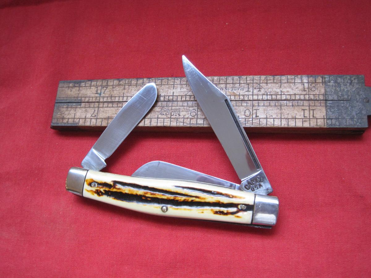

Just finished this CAMCO 772 today

TripleF wrote:Just finished this CAMCO 772 today
Well done it looks factory New.
