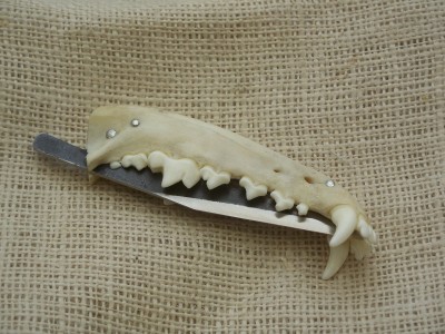

Haven't had a request for one of these in a while, turned out pretty good.

Neat, you have used both mandibles to make the handle. What do you do to keep the teeth from falling out ?
Somewhere i have a fixed blade with a coyote mandible for the handle. Problem is the teeth kind of bite when you grip firmly.
Still a unique and even attractive folder.

I bet you could design a sheath that could be slid back over the handle to make using it comfortable.

it actually feels remarkably good in the hand, the deer jaw ones need the teeth dulled or they will cut you.

Kaleb, do you do anything to secure the teeth ?
Did you clean the coyote jaws yourself ?
It is a real challenge to get them that clean of all soft tissue without using lye which can dissolve some of the bone and all of the dental ligaments so that teeth fall out.

Yes they get epoxied in after I beetle clean them and give them a soaking in peroxide.
