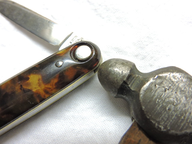

Mr. DeShives, how does one "upset the liners on the end of the knife"?
Could you please define "upset". I would love to tweak these nice knives so they would fire properly.
Thank you, sir.
Thank you, sir.

You don't have to take them apart.
I use a very small ball peen hammer and tap the end of the knife-just on the liners.

Re: Press button double switch
You have the right idea, but the hammer is too large.
It might work. I use hammer velocity over weight.
You just want to slightly peen the liners.

I did it.
I went with a much smaller flatfaced hammer and gave it a few wollaps and it worked. It's not perfect but it locks most of the time and it doesn't flip back. Not pretty but effective.
A little lighter touch might be better, but it's pretty good for a first try!
