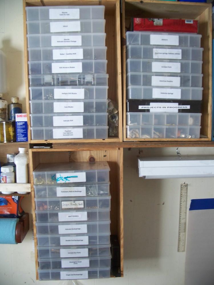

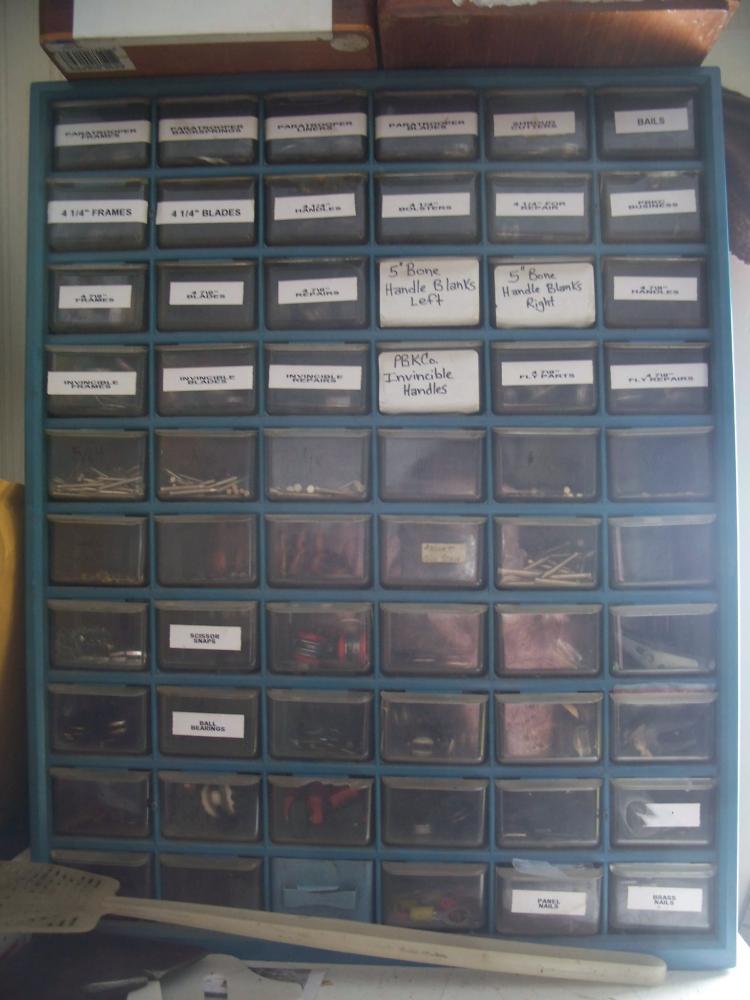

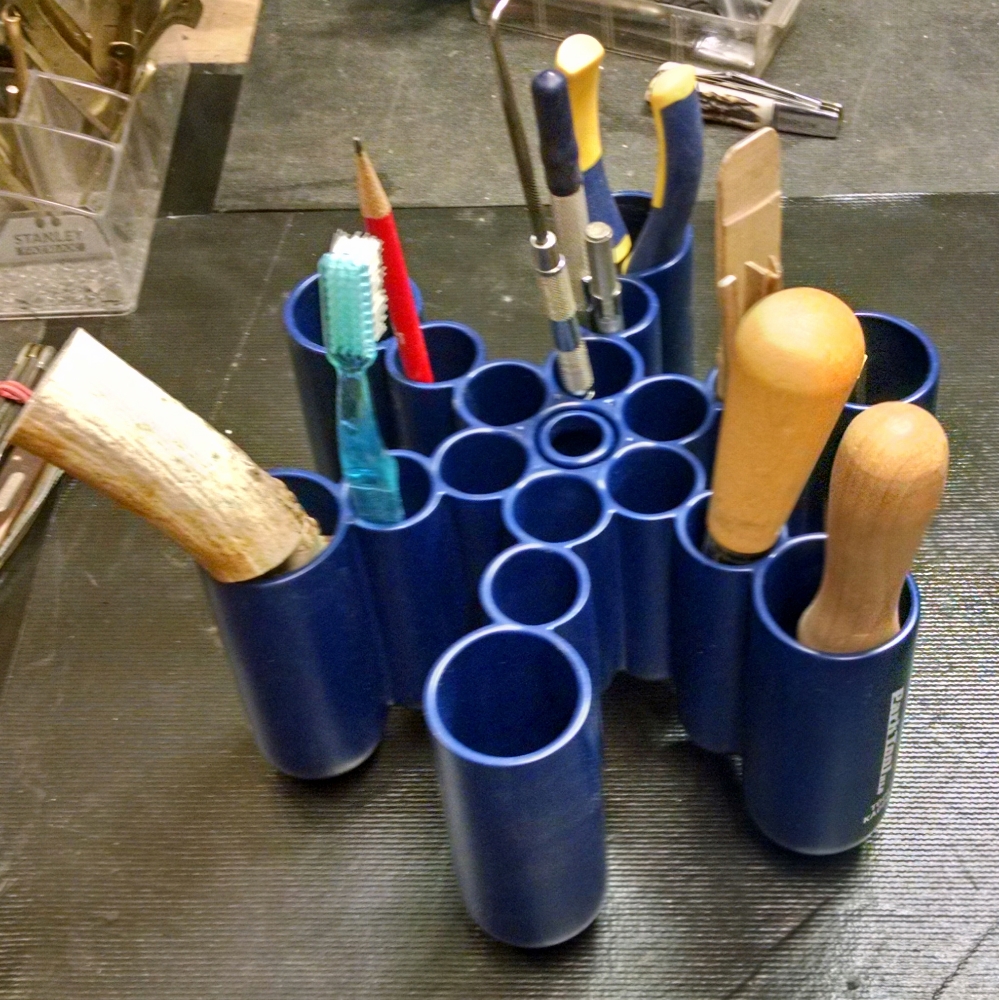

the nice thing about these is everything is actually hinged, no molded flaps for things to hinge on that will just snap off eventually

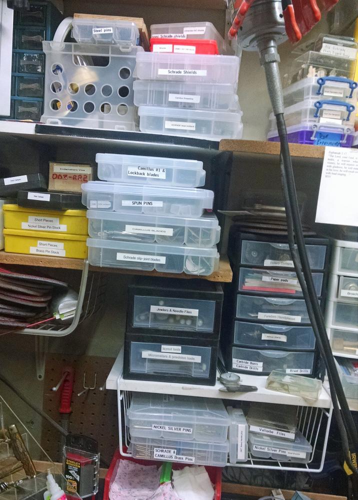

- orvet
- Posts: 19901
Re: Shops, tools, materials and tips

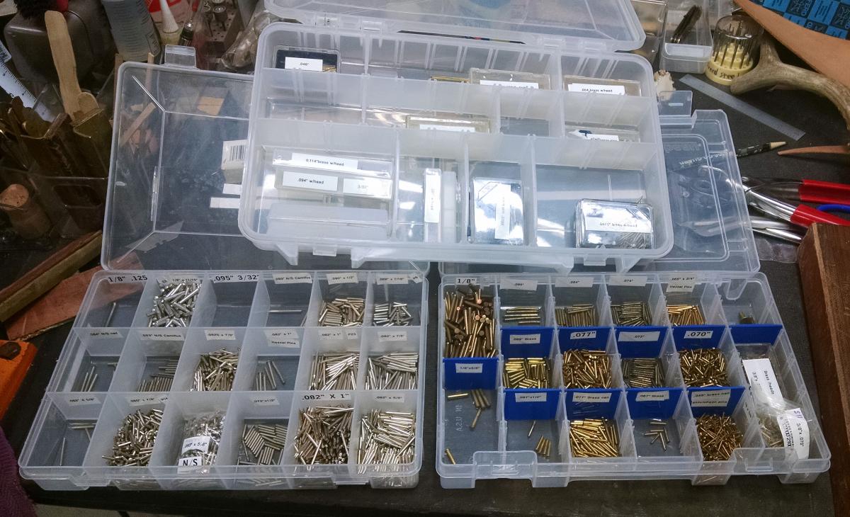

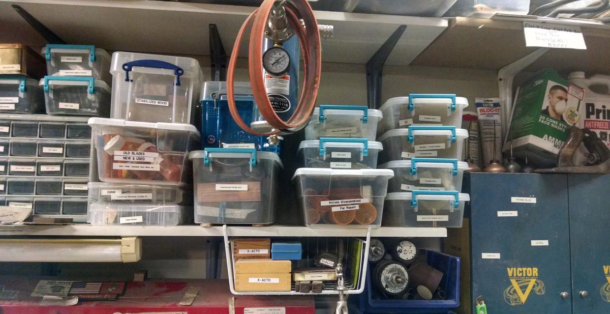

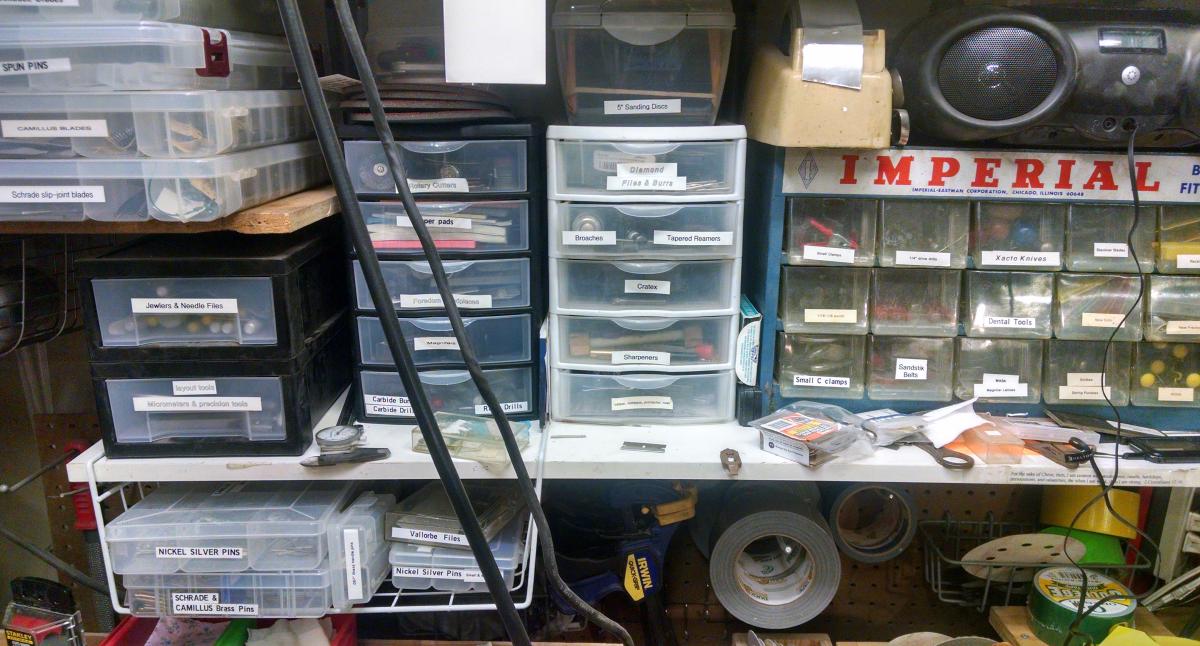

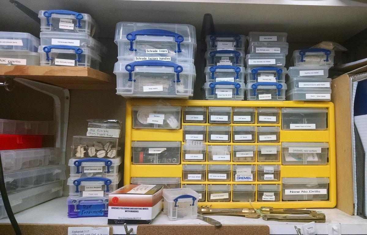

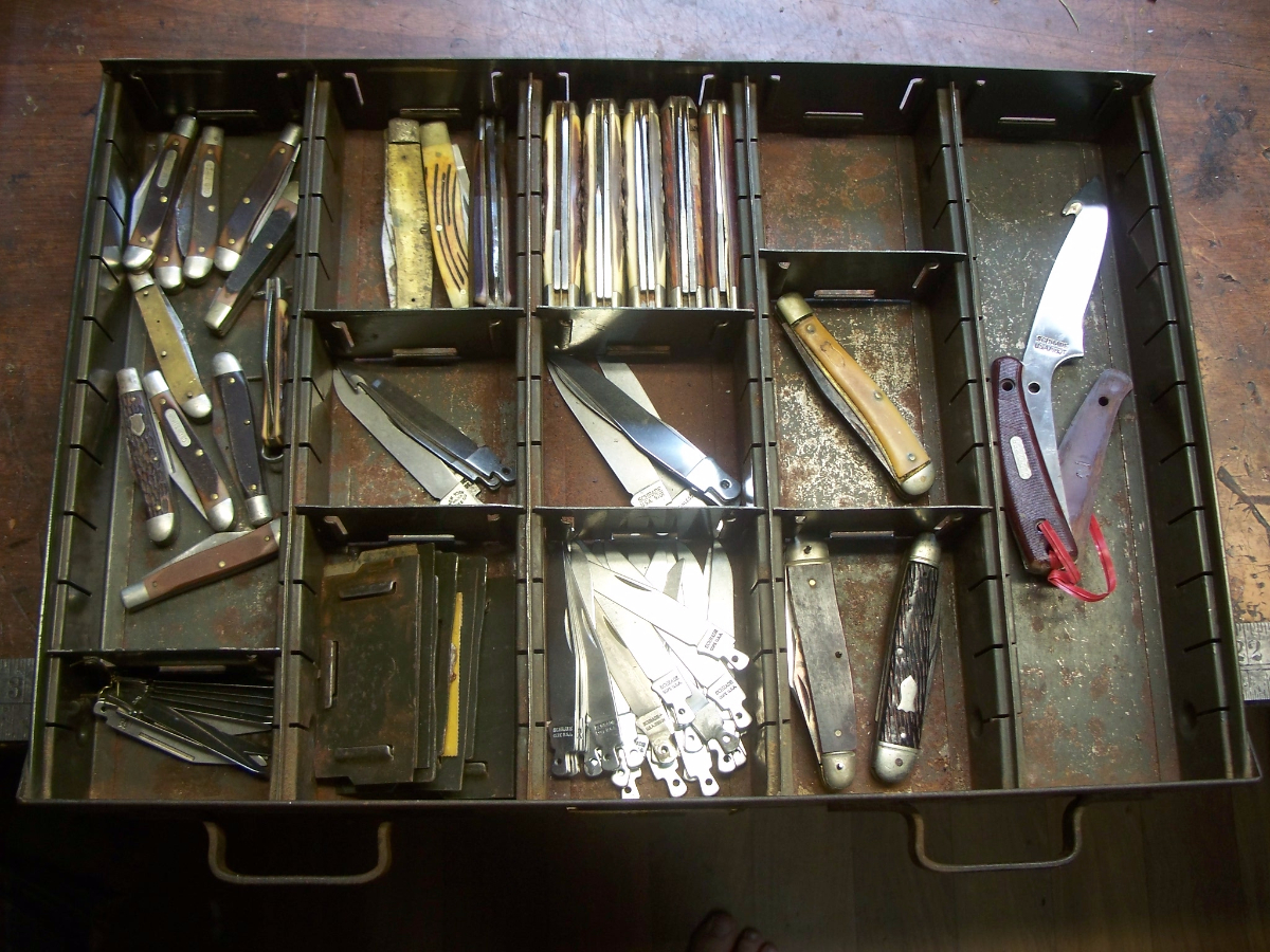

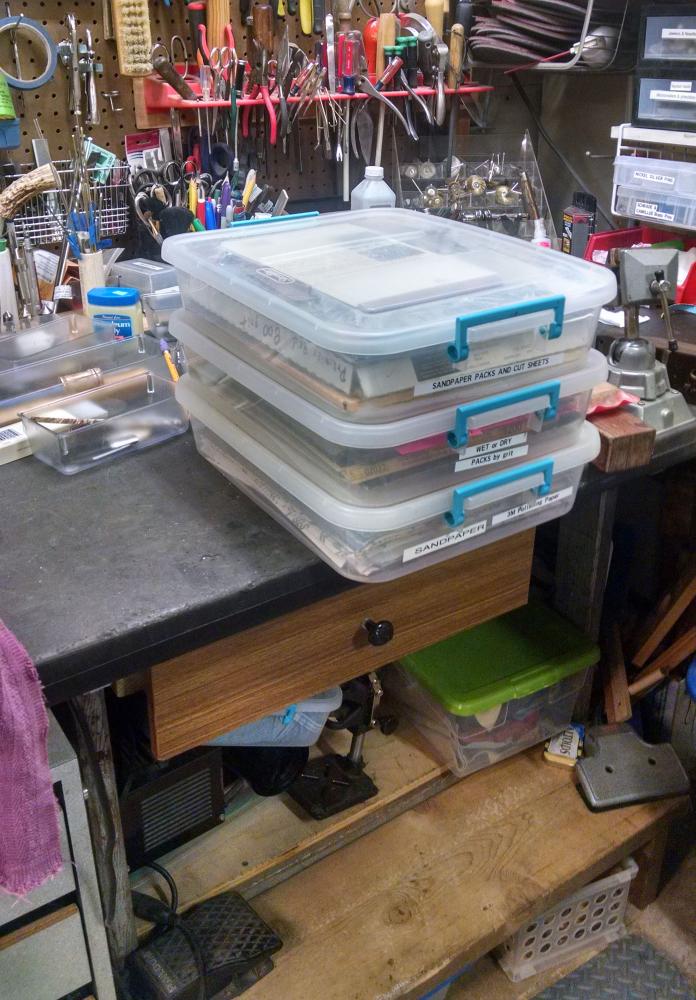

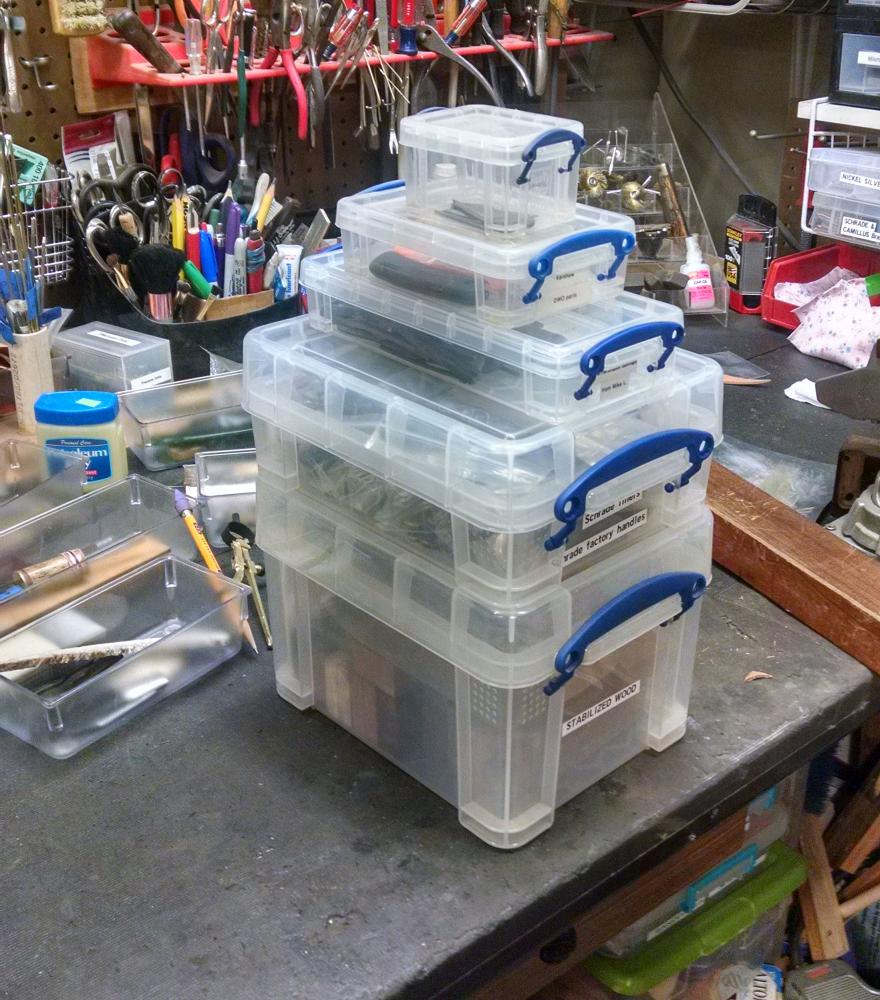

Here are some of the storage containers I use in my shop.
For me compact and efficient storage is essential because I have a lot of stuff in my shop and I am limited on space.
Here are the three pin trays I use the most, the upper tray are pins I have premade by spinning a head on one end of the pin. The lower trays are nickel silver and brass pins I have traded for/purchased over the years. I shudder to think how many dollars are in those two trays since I have not found these pins in the large quantities and had to purchase them in small packets. This is where the pin trays and others set next to my workbench. I still use the PVC tubes to store full 12 inch lengths of pin stock. These boxes come in assorted sizes and are made in EU. I seem to recall some of them being stamped made in England, but I guess if they are stamped EU they could be made in England or anywhere else in the European Union. The brand name is REALLY USEFUL BOX. There is a size even smaller than the one on top and they get much, much larger. They are rated by volume in liters. The small one on top is rated at .14 L and the one on the bottom is rated 3 L. I find these at Office Depot or OfficeMax. I think the largest ones they carry are about 50 liters. Here are some more pictures of the storage containers I use as they appear on the shelves. I have found a number of these plastic drawers quite useful for organizing things and keeping them clean yet right next to my workbench where I need them. These containers with light blue handles were some I picked up at Walmart. Walmart used to carry a lot of sizes in these but they are getting harder to find.
Some more Walmart containers. What I like about this particular size is they will store full sheets of sandpaper flat so they don’t curl there also large enough to store full packs of sandpaper. These three containers are full of individual sandpaper sheets, sandpaper packets and 3M polishing paper. By storing them in these containers my sandpaper doesn’t curl, which can be a real annoyance when that does happen.
Well there you have it, a look into my organized chaos!
- muskrat man
- Posts: 5684
- Location: Ohio
That looks great Dale. I have used the small tackle like trays from hobby lobby ($1.99 ea) for a while for storing blades, springs, screws, bails and other small parts. They work really well. the dividers are permanent though so you have to cut them out if you need a larger compartment but the price is right.

- orvet
- Posts: 19901
I see we think along the same lines Kaleb.
I have several of those I bought at an estate sale, though I have phased some of them out mostly were knife parts are concerned. For me, the tackle boxes are more efficient for knife parts.

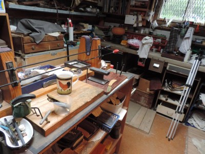

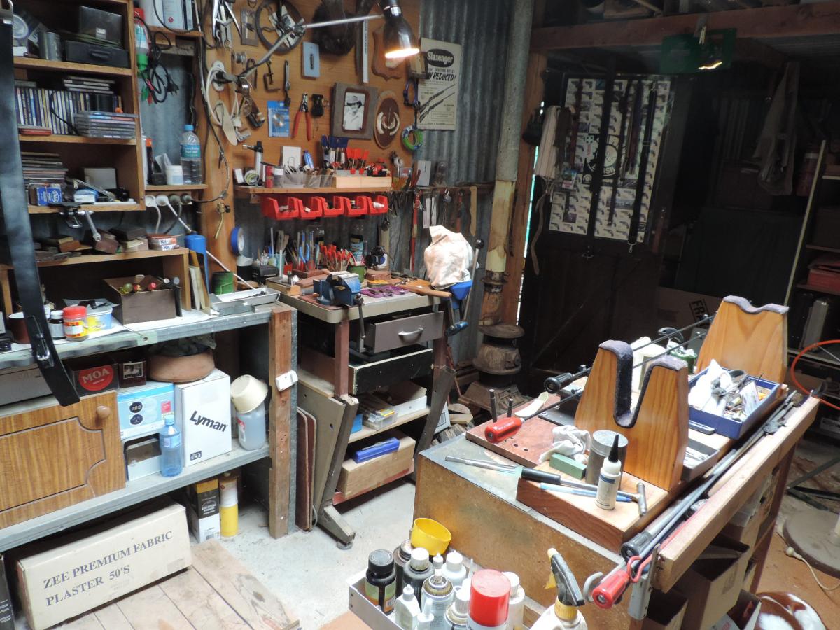

- Brumbydownunder
- Posts: 451
- Joined: Sun Dec 27, 2015 7:14 am
- Location: Central NSW Australia

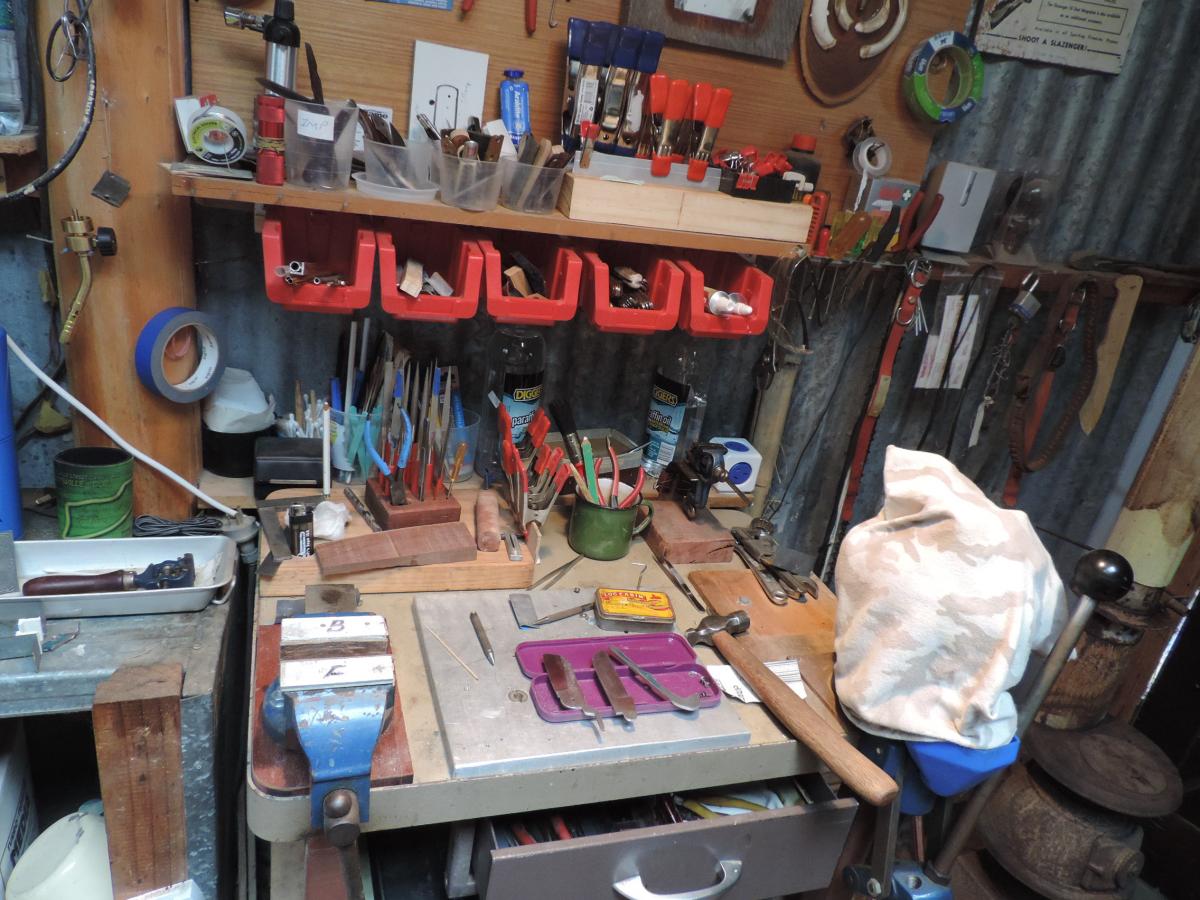

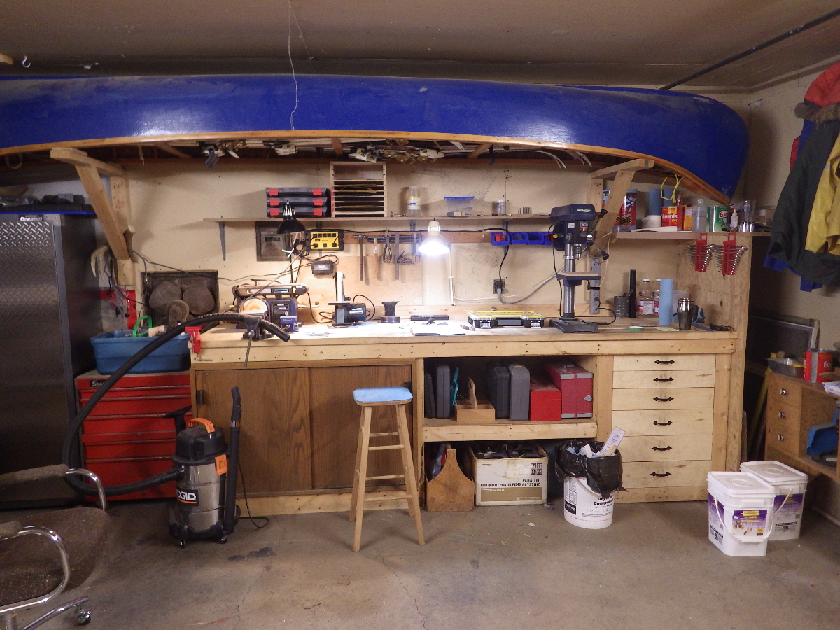

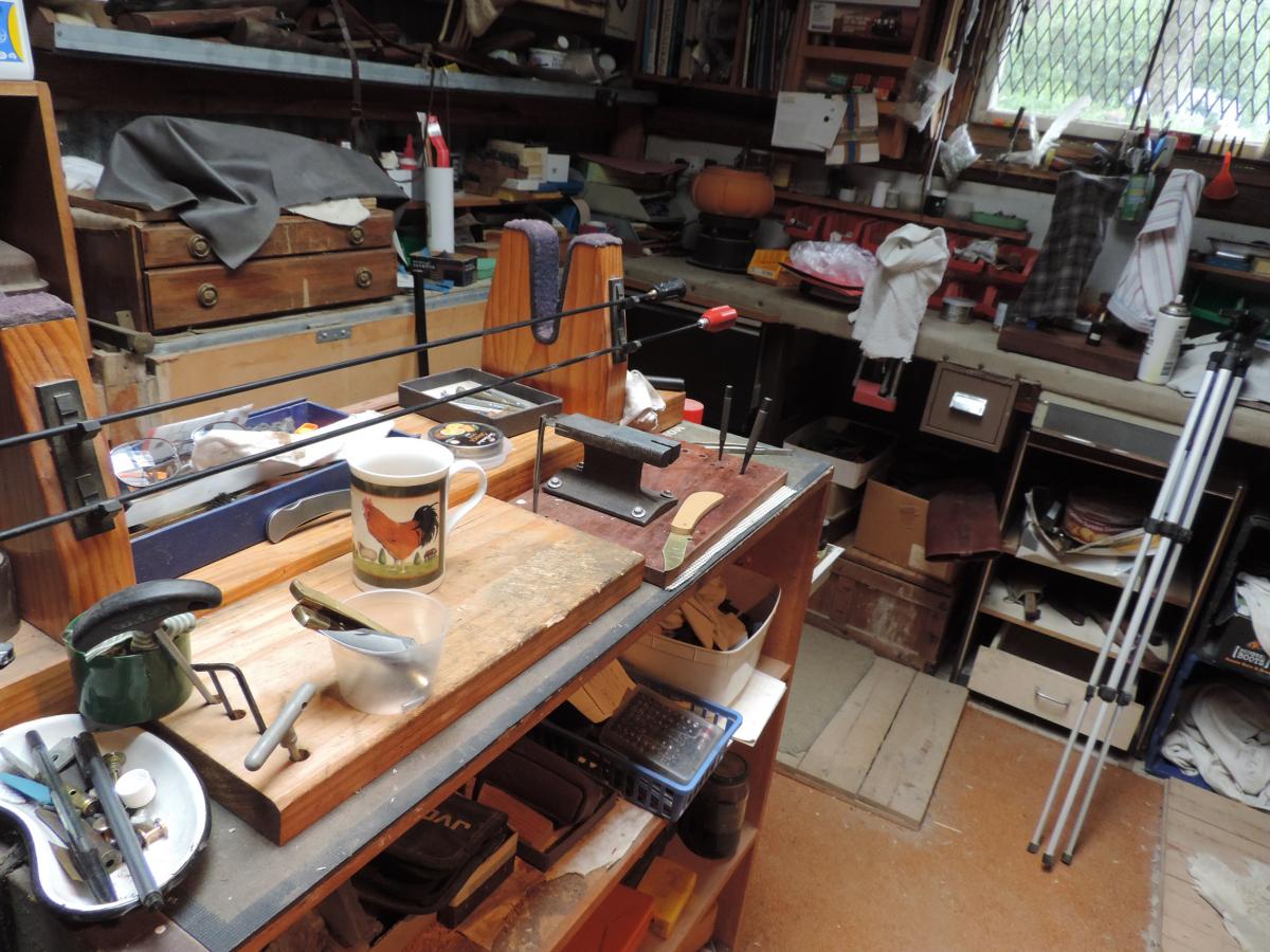

A couple of snaps of my knife making area, come reloading, gun cleaning area.
Everything in here is done by hand - the heavy artillery - bandsaw, sanders, drill press etc is in a separate room.
A question please... I see a couple of mentions of a "Spreader" I assume to spread slip joints to take them apart (?)
Could someone post a photo or two - or perhaps a link ?

- btrwtr
- Posts: 5480
Nice looking and well organized shop. Thanks for sharing!

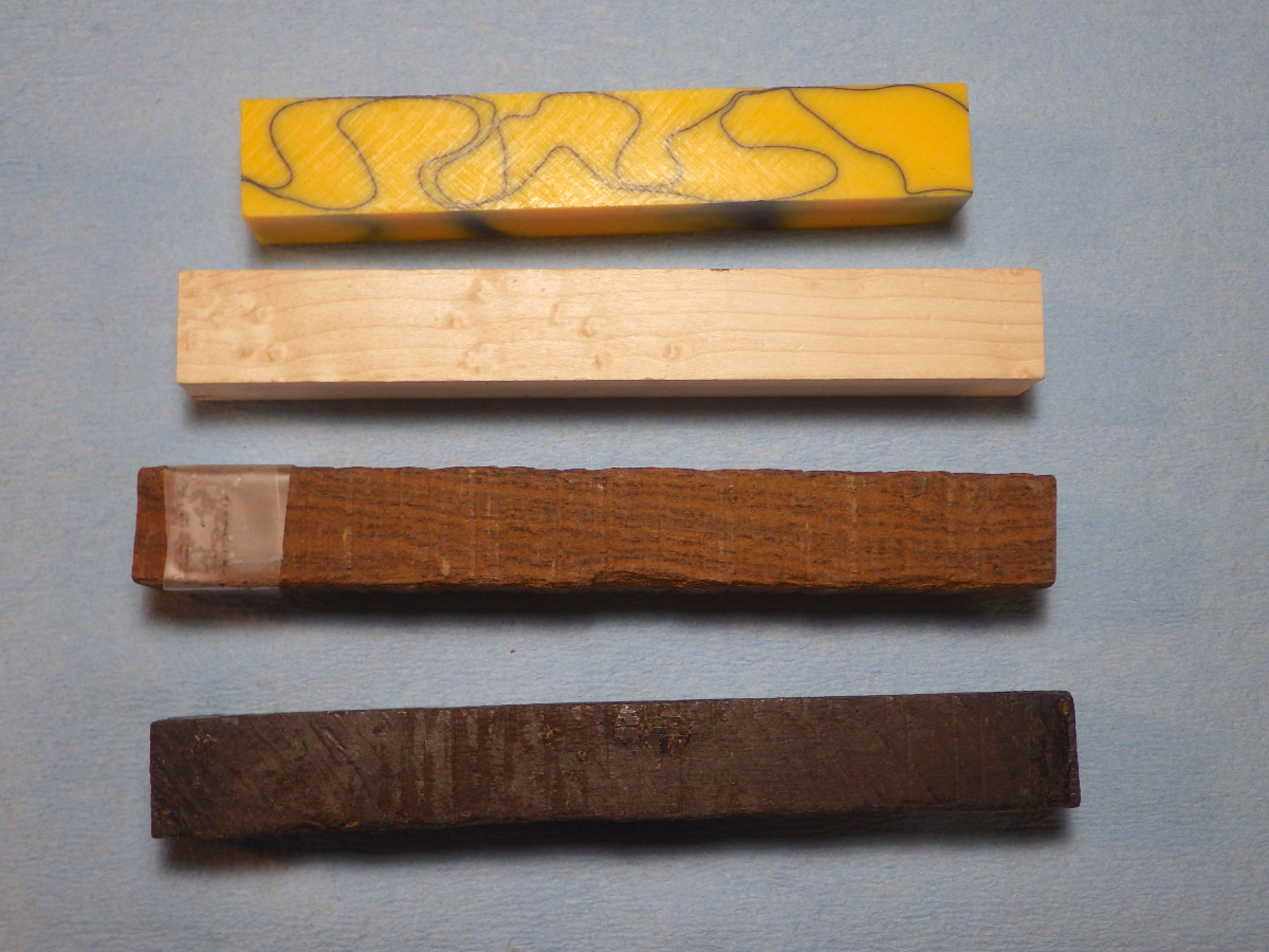

- danno50
- Posts: 3916
- Joined: Mon Jan 12, 2009 12:05 am
- Location: Saskatchewan, Canada
I found a cheap local source for some handle materials. Lee Valley tools sells 3/4" X 3/4" blanks for turning pens in fancy hardwoods and some acrylic. I got the materials below: yellow/black acrylic (receipt calls it acetate), birds eye maple, bocote and African ebony, for just under $20. the hardwoods are about 8" long so should do 2 smaller knives each. I use a jig on my radial arm saw to cut the pen blanks down the centre. I don't have a band saw and think the radial arm is safer to use than the table saw for this. Not sure how the acetate is going to work out. The fellow at the checkout says that when turning it the material comes off in strings? So hoping it will not be too brittle.

- Brumbydownunder
- Posts: 451
Looks great Dan, plenty of clear worktop and those draws bottom right give you some beaut storage but easy to access.

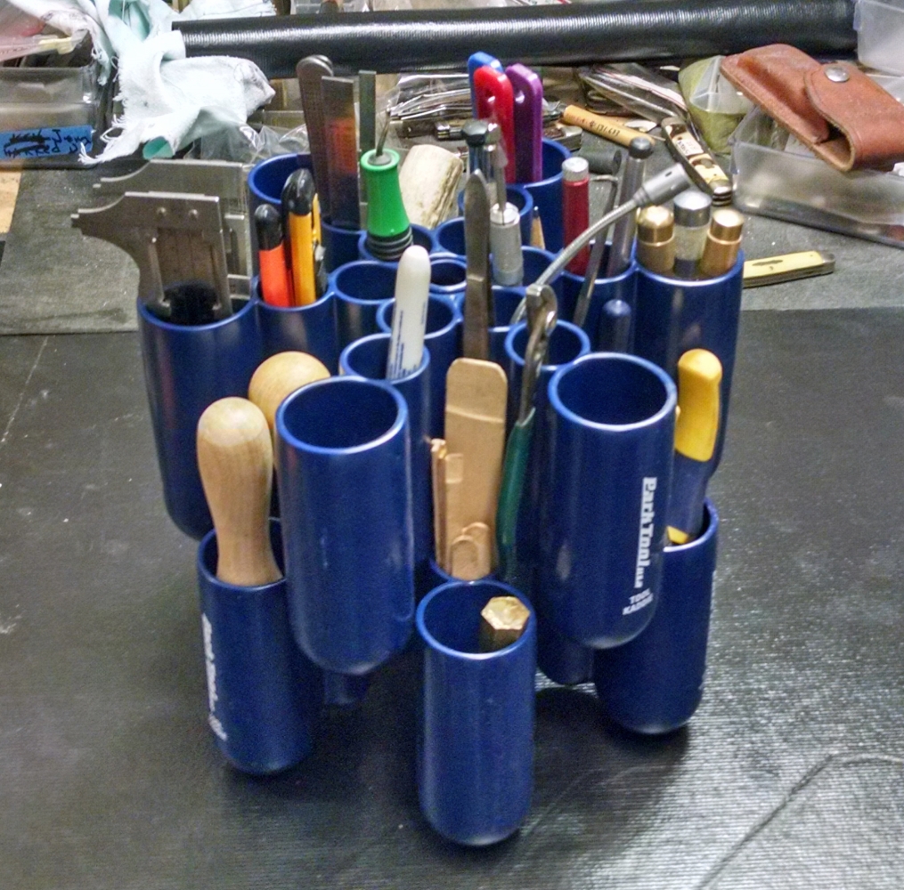

- orvet
- Posts: 19901

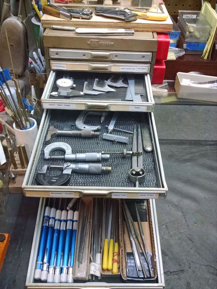

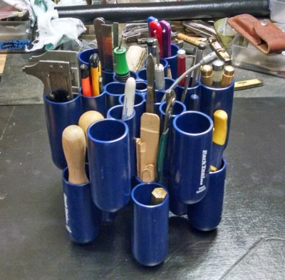

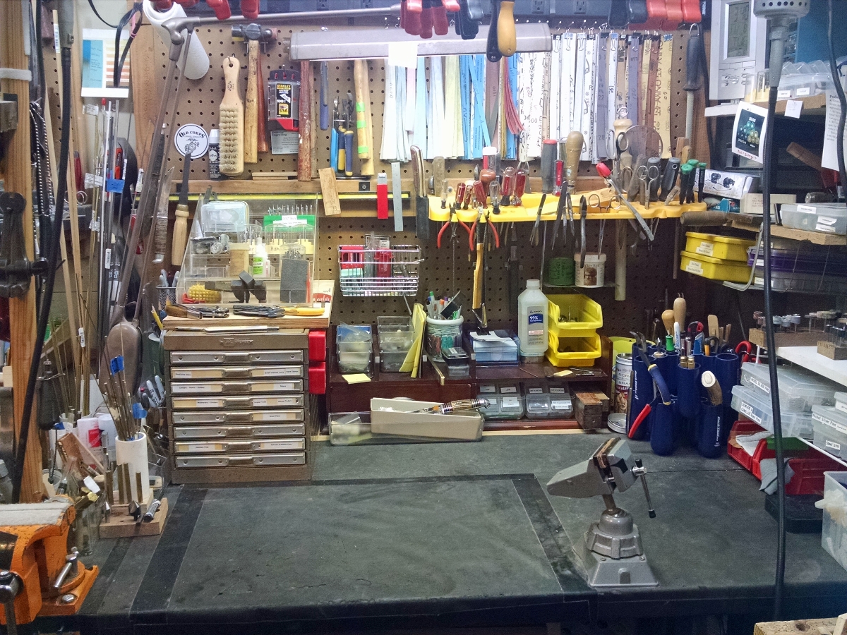

I took some pictures last year and the year before but I never posted them in here.
I thought some of you guys might like to see what I'm using and perhaps it will spark some ideas for you and how you can repurpose some things to use them in your shop.

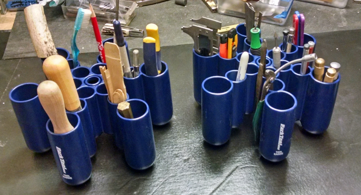

The blue plastic contraption is called a Tool Kaddie they were made for the bicycle repair business. Apparently they stop making them and I picked these up at a yard sale for 10 bucks each I think. They really weren't made for knife repair but they are certainly handy to keep a lot of tools close at hand!

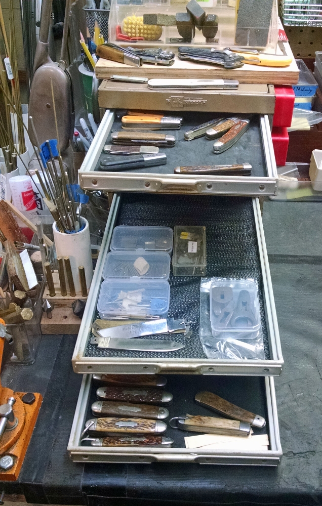

Speaking of handy, I pick this up last November at the flea market, it’s probably the last time my workbench was clean too! I don’t know what this little cabinet was originally but it is great for packing a lot of tools and stuff in a very small area on my workbench!

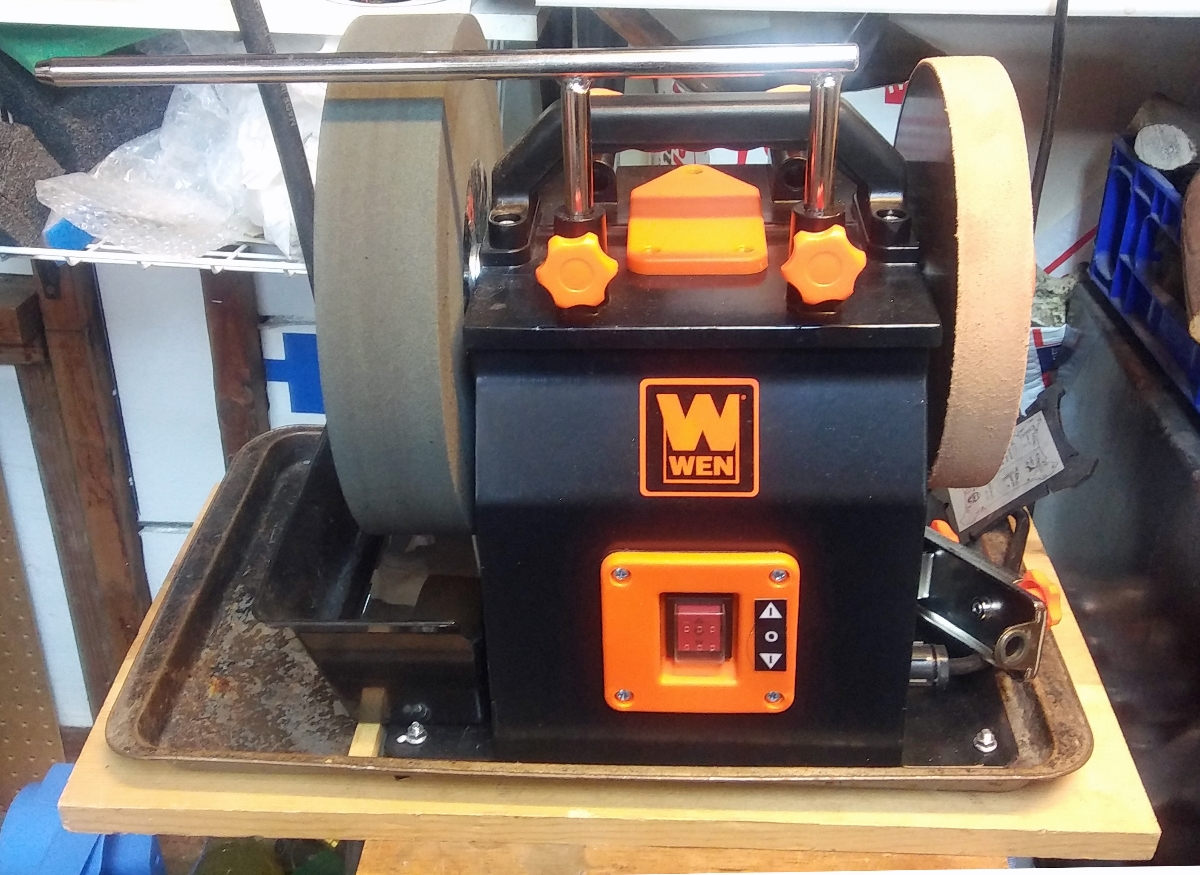

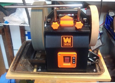

This was my latest edition to the shop earlier this year; a Wen 10” wet grinder.
I had an 8” wet grinder that I got several years ago. The wheel was worn down so far the housing was getting in the way of the wheel when I was sharpening. This new one is 10” so I should get several more years than I got out of the first one.
I had trouble finding a new 8” wet stone for my old grinder and when I finally located one it was $120. About that time I saw the Wen 10” wet grinder on eBay for $139.16. For $20 more I got a 2 inch larger wheel and a brand-new motor. This one is even reversible, which the old one was not. I have used this new wheel a few times and I am becoming very fond of it! I think it is basically the same machine as the one Grizzly sells under its name also.
I like the fact that I can remove chips and next from blades without heating them up and causing harm to the heat treat of the steel. It’s also very good for sharpening tanto blades which are one of my favorite blades.
- FRJ
- Posts: 17136
- Location: Ct.
Interesting show, Dale. I always like looking at work areas and tools.
The little cabinet looks very handy and also the new wet grinder seems like a real upgrade.

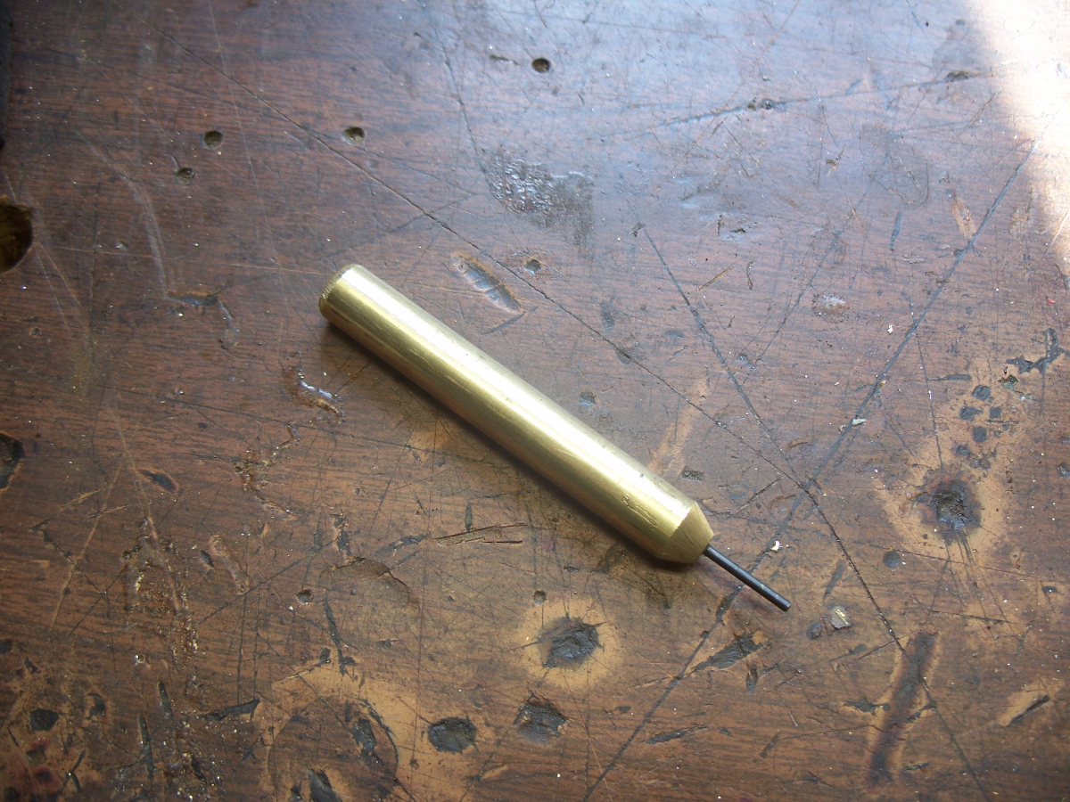

I got tired of bending punches, decided to make my own. I turned the shanks out of 3/8" brass rod, centerdrilled the correct size and use the shank of a dull or broken drill bit as the punch. Loctite it in place. If it breaks, throw a little heat on it, pluck the bad tip out and stick a new one in. The nice thing is you can make them in many precise sizes.

Great idea Kaleb!
The ones I break most often are the 1/16" pin punches. I have about half a dozen 1/16" Craftsman pin punches so when I get two or three broken ones and I'm heading to the east side of town of take them along and stop by Sears and get some new ones. When Sears stops replacing them I will have to go to your system.
Excellent job of thinking outside the box!

Good Tip MM ... one of those ... "why didn't I think of that?" I needed a punch like that over the weekend. Consider the idea "Borrowed".

I did that for quite a while, with punches and files, there is no sears hardware near me anymore, ours closed it's doorsorvet wrote:Great idea Kaleb!

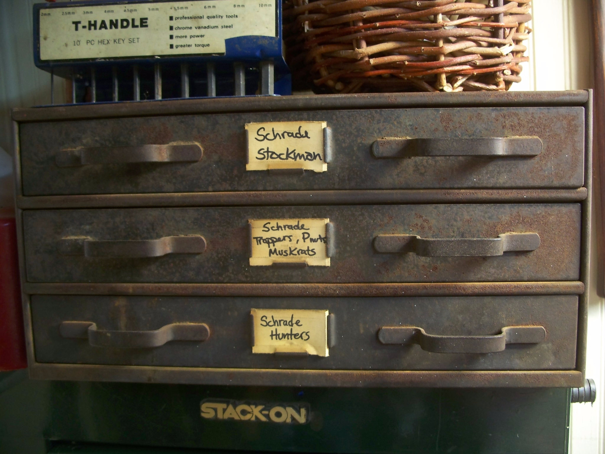

picked this up at the flea market the other day for $8, was full of hardware i'll use for something, eventually. But this is what I bought it for. parts storage for my most commonly requested schrades. I organized them by frame type rather than actual model # becuase so many of the schrade parts are interchangeable between model numbers. Most model designations within a given frame type were just to denote a change in handle material, and sometimes in blade steel.
- glennbad
- Posts: 8174
- Location: NH
Cool find! I'm always on the lookout for things to put parts in, never seems to be enough space though.

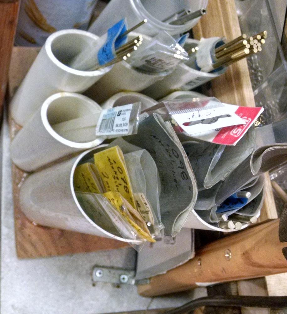

Lately I’ve been using Plano plastic fishing tackle trays for parts and for parts knives. When I get those reorganized and in place I will post some pictures.
