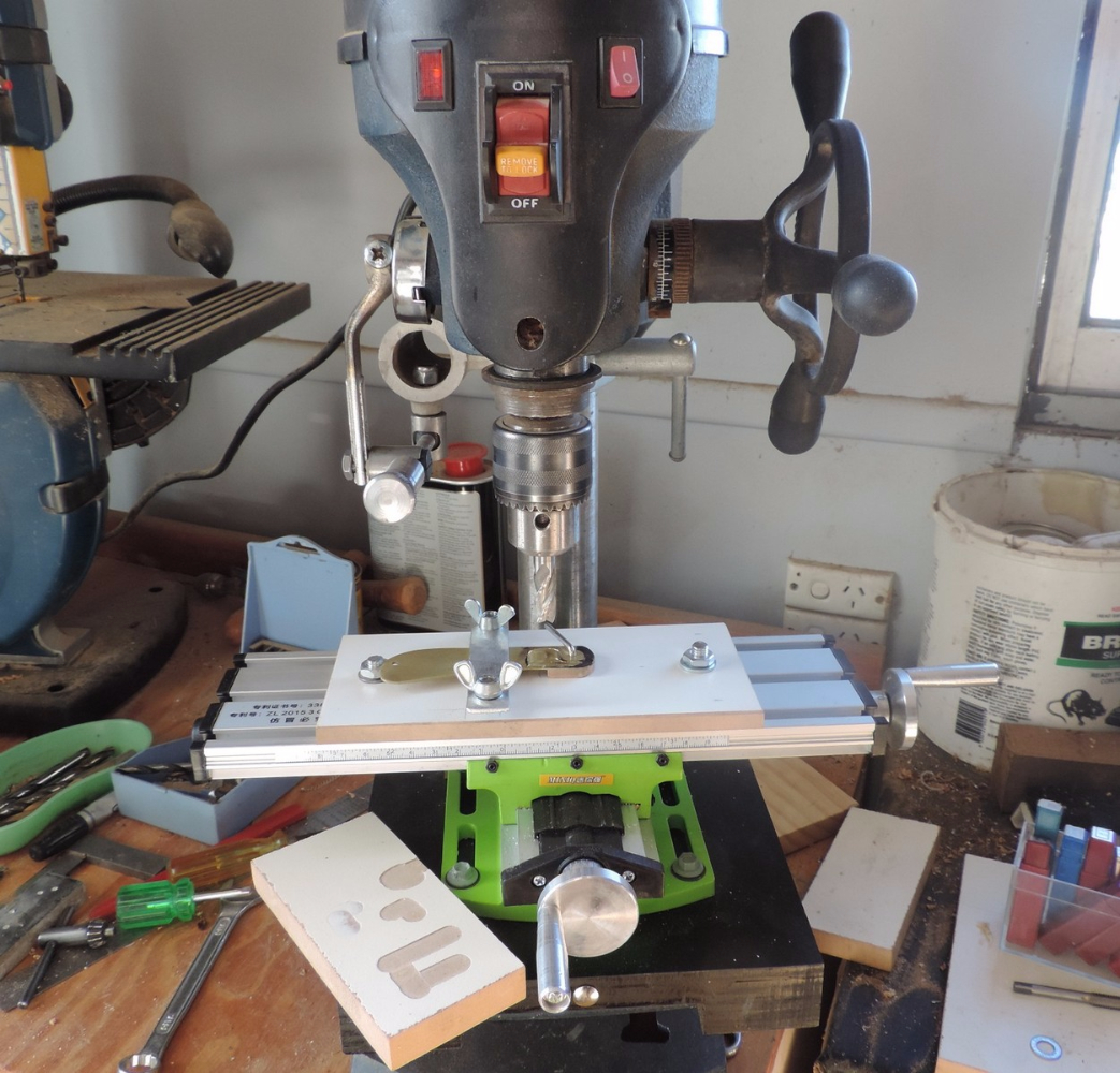

Love this thread... I have learnt so much. They say “Necessity is the mother of invention” but so often in my case “lack of money is the mother of my inventions” :roll:
A couple of recent creations as I get into making slip joints from scratch – up until now most of my dabbling is around re-working existing knives.
A rise and fall gauge … the actual gauge cost $19 off that auction site the rest of the 'stuff' surfaced from various parts of my shed.
Also I wanted to start relieving the area of the scales where the tang rotates. I don’t have a Mill or access to one so again to ‘that auction’ site for a small east/west vice $40 shipped out of China. Some other bits & bobs out of my handy shed pile and a basic drill-press becomes a rudimentary mill. I still have a few minor adjustments to make but the test-runs are going well.
Edit ... I should have added the Chuck is pinned to the Drill press shaft to prevent it shaking loose.

Nice set up Derek! The tools in my shop are all re-purposed. I have one drill press that a dedicated buffer as I dont have a bench mount buffer. I like it better as the speeds are slower and I have a choice of speeds. I like the way you set up your shop Derek! ::tu::

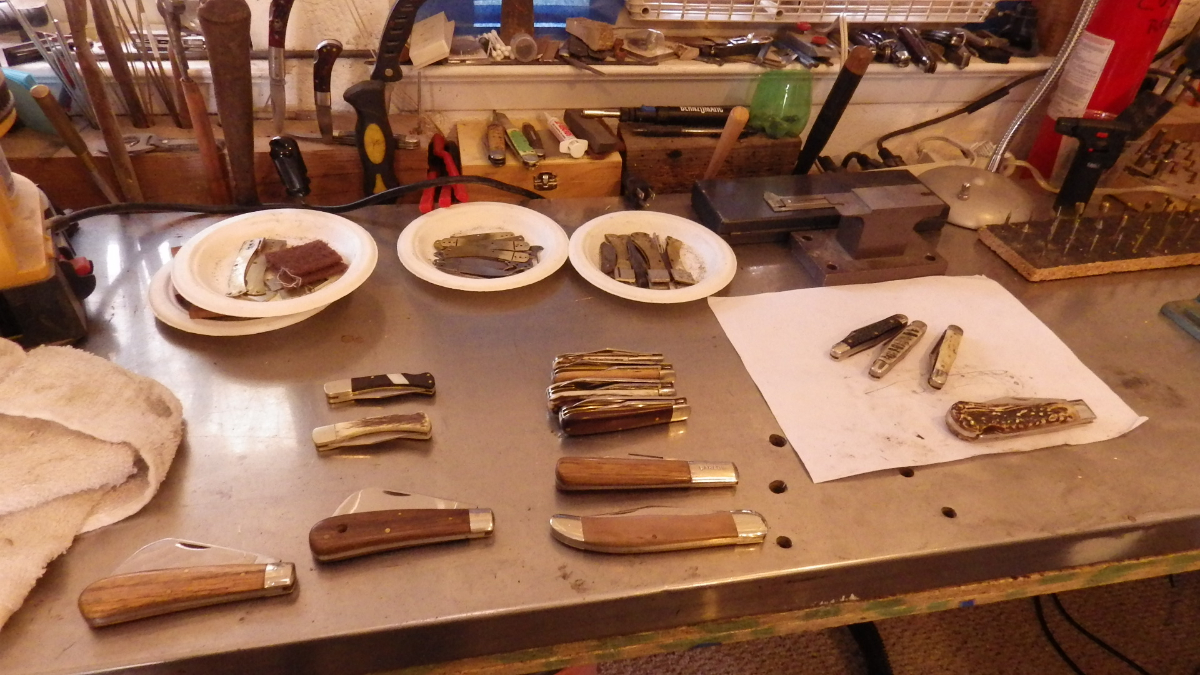

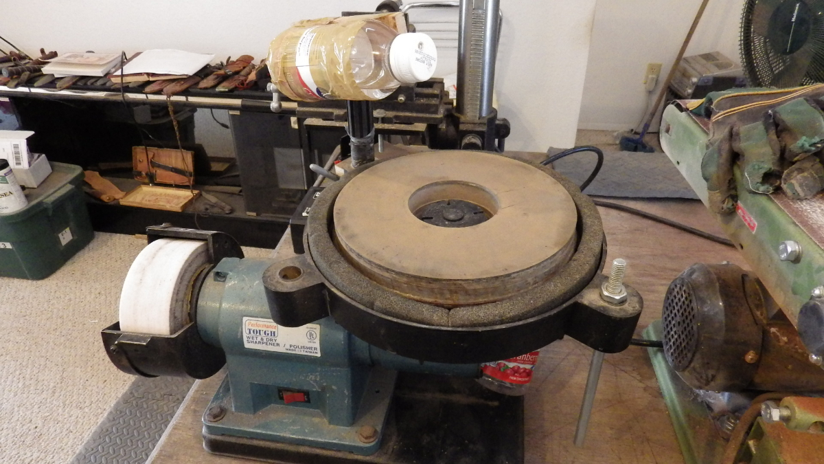

Well I decided to spend a few days arranging shop to make it easier to get to things since my my neck was bothering me too much to work on knives.
Here are some earlier pics from I first set things up about a year ago.
It seems I was always getting up to look for something. Along with a bad neck I have a screwed up lower back as well. Instead of unnecessary trips for sand paper or what not I arranged things so I reach what I need without getting too often.
The drilling and buffing stations are the same, just needed to be cleaned. ::super_happy::
The Work Sharp, 1 inch belt sander, 4 inch belt sander and wet grinder are all located together. Makes the large grinding chores easier. ::nod::
Sand paper, files, rotary grinder and accessories all together. ::nod::
#goldpan
Posts: 1891
Re: Shops, tools, materials and tips
Post by #goldpan »
Breaking things up a little bit.
I have had a stainless work bench top so I though it would be a good time to use it. Besides a such a solid work surface makes things like cutting knives apart as well as pinning them back together easier. ::tu:: This work surface gives less than just the 2 layers of plywood that I have been using.
A friend of mine gave me a wet grinder some time back. It was missing the water tank and such so I had to rig this bottle to do the job. I drilled a hole in a block of wood and used a bolt to connect it to my "post" in order to tip it up for off. And tip it on its side to get the water flowing. Change the angle to control the flow. I made two holes in the bottle cap. One for water to come out and one to let air in. Gets the job done cheap! ::tu::
Well its time to get back to working on those small Colonial lock backs. But now I don't have to hunt for all the things I might need to take a knife apart. Or put one back together! ::nod::

That is just way too tidy to be 'normal' :D
Nice work space it would be a joy to work in ... I'm envious>

Great ideas guys!
I love your vertical mill Grant, awesome idea!
I should be getting my other small drill press back soon. I may need to ask a couple questions on your setup.
Randy, I am jealous of all the room you have!
Outstanding layout and it seems to flow in one direction so you don't have to backtrack. Nice!

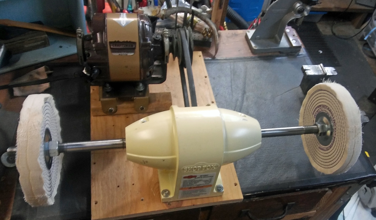

I have wanted to get another buffer for my shop for some time. Changing buffs can be pretty time-consuming and it’s nice to have one machine that can do your most common buffing tasks without changing buffs.
I found a buffing assembly with the three diameter pulley on sale at Grizzly Industrial’s website: http://www.grizzly.com/search?q=(buffer ... op+Fox%22)
I had a 1 HP Craftsman motor that I picked up at an estate sale for $5 or $10. It’s more motor than I need but I’m certainly not complaining. I got it set up and I have to make something to trap the dust because these new buffs will rain little threads until you get them broke in. I’m not sure where it’s going to be placed in my shop, that’s another issue yet to be solved. I would like to make a stand that would hold both buffers but I’m not sure how practical it would be especially with limited space.
The buffing assembly was around $130 shipped plus $10 for the old motor and everything else was things I had on hand. For less than $150 I have a variable speed 1 hp buffer.
Grizzly does sell a 1725 RPM 1 HP buffer for around $350. It’s a dead ringer for my old Jet buffer except for the color in the name on the front.
I just thought I would show you guys and if anyone is interested in making one of these for your own use, please feel free to ask questions in here or send me a PM.

That's a neat setup, Dale! I'd love to have a second buffer setup, but I probably don't have the room... :(

Nice set up Dale! I'm always a bit jealous when I see pictures from everyone's shops. ::nod:: Just like knives, when I see what others have I want one for my self! Thanks for sharing! ::tu::

If you figure out a good dust trap for your buffer i'd like to hear it, I have black streaks along the bench, up the wall and across part of the ceiling in line with both wheels on my buffer LOL. I've tried a couple different cobbled together setups, nothing that I have tried so far works.
americanedgetech
Posts: 1552
Joined: Mon Sep 04, 2017 1:40 am
Location: Florida Pan Handle
Post by americanedgetech »
Use a pair of 90* terminal ends for a floor register, and one section of trunk.
You can cut the trunk to make a larger shield that will work for two 12" wheels.
All in you'll spend about 12 bucks.
Edit:
Use sections of sliced fuel line or similar hose to cover the sharp edges. Trust me on that one... :x

That looks doable Ken.
Where do you get the ducting, Lowes?
americanedgetech
Posts: 1552
Lowes, Home Depot ect.
Something that REALLY helps is pop riveting it all together. Sheet metal screws tend to vibrate loose, and you'll know it when you get "shot" w/ one.
I just found the link for Home Depot... They are almost 9 bucks there now. https://www.homedepot.com/p/10-in-x-4-i ... /100197347
I would try a local HVAC guy, and ask for a couple. They should be around 4 bucks.
The circular part that takes the duct can face into a 5 gallon pail or out of a dryer duct thru the wall, and into a bucket there. You'll want to use steel ducts so they are easy to clean. Those flexible ones actually trap the compound, and will start falling off or kinking.
Same issue w/ a dust collection system... the compound gunks it all up unless you use something like a piece of a central air conditioner filter. ::tu::

I make my buffer hoods out of cardboard and duct tape. I screw them down to the bench.
Cheap, easy, effective and best of all-safe!

I appreciate a nice shop where everything is really nice, but I think having a table next to Wayne Goddard for 10 years at the OKCA show has had a lasting effect on me. Now when I see something I think how I can make it.
My existing hoods are cardboard, plastic jugs and of course duct tape. Two of my buffers are home made.
I will post a couple pics tomorrow.
