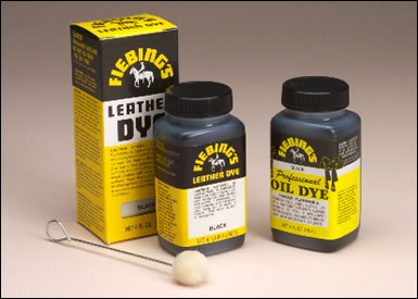

Chevy,
I live by this stuff.
Just put some heavy concentrate of rubbing alcohol or moonshine on it. Let it dry . And then put some Fiebings.

Rex, I would be grateful to see some before Fiebings and after Fiebings pictures if you have some available. Thanks.

Yes sir.RalphAlsip wrote:Rex, I would be grateful to see some before Fiebings and after Fiebings pictures if you have some available. Thanks.
Here is a link to a fixed blade where I used it:
viewtopic.php?f=37&t=52803
I have used it on a few other folders that I re-handled but need to find the thread. When I find I'll post link.
EDIT
Just found another one where I used it. May have been a bit overkill with the vacuum chamber and oil. I have since decided it is best just to clean with alcohol and then dye.
viewtopic.php?f=37&t=39182

Wondering. Will bone actually soak up the die? Or will it rib off in the pocket if used. I use that die on leather and it's definitely the best out there.

All of the handles I have used on it is still there. It does seem to soak in quite well.
I would suggest that after you are done to let it thoroughly dry and then seal by using flitz or other type of polish. Even mineral oil works to help seal it.

Just a tip, I would try what ever dye you decide on , to try it on an old piece of bleached bone or antler to try and match the color. I have used Fiebings leather dye and potassium permanganate, and analine dye of various colors. bone is kind of hard to match because it all takes dye at different rates and so on. It will not come of if you let it dry and wax after drying. good luck and let us see the results.

Be careful the "unbleached" and regular side may take up the dye differently and at
a different rate.
