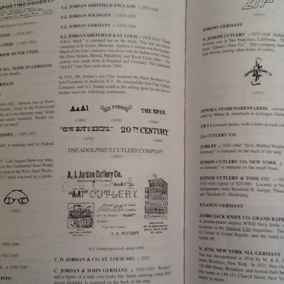

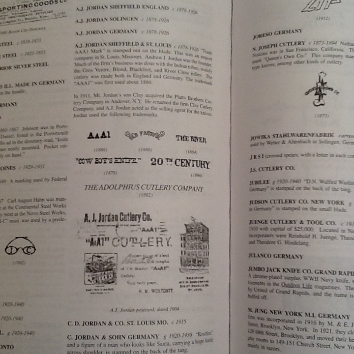

A.J. Jordan was an import company in St. Louis c 1878 - 1926. They imported cutlery made in England and Germany.
Recommend you acquire a copy of Goins Encyclopedia of Cutlery Markings. If you're going to be collecting, buying, or selling cutlery, especially collectables, this book is a must. I'm going to post a picture of the page listing A.J. Jordan so you can not only get an answer to your question, but also see the comprehensive nature of the info in Goins' book. You can purchase a copy through the Knife Magazine web site.http://www.knifeworld.com/featuredbooks.html
Also for your reference here's a link to a thread here on AAPK discussing other useful reference materials. viewtopic.php?f=2&t=42388&hilit=Remington+books
AAPK also has a very useful "search" function, and "Research" section (the link is in the header waaay up there at the top of the page). I used to be surprised at how much information is here in AAPK archived threads. I'm no longer surprised. ::tu::

I have been using Goins, and I have been looking at a lot of the information here. I try fairly hard to find info before asking to be "spoon fed".
It's the Irish in me. Independent till I die...
The knife I am asking about is NOT from "A.J." Jordan (the importer) but is it actually "A." Jordan. A German knife maker. I found one reference to him working between 1868, and 1888. Then another that listed him as active between 1898, and 1918, and listed his company as A. Jordan & Son. Perhaps the "son" is A.J. Jordan?
Both of these references were in off topic conversations so they were basically side notes to another conversation.
I did find one cutler living in New York City, and selling knives named A. Jordan that was just in between the dates I mentioned (1900 ish) but there is no mention of him producing/manufacturing knives in the short 5 year span of his business there. I have only a reference of him distributing another brand thru his shop.
Also what has me stumped is the image of the knife I linked is TOO pristine looking. The blades should have a much richer patina. The knife does appear to be 100+ years old in all ways but it's sort of a conundrum as to condition, and maker.
I realize having this info will not change the world but it might brighten up my world just a bit. ::tu::
