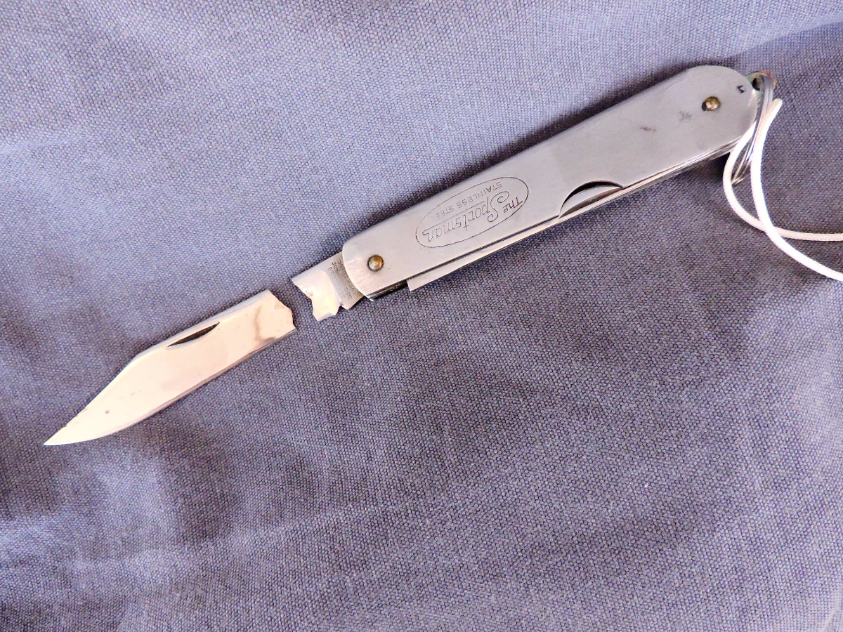

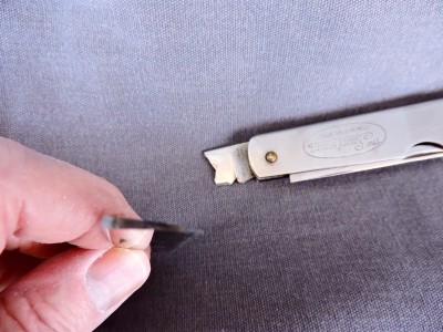

While fishing with my friend Adam we found a big snag of netting that had washed up and I was cutting out some lead core rope that Adam wanted and I had a surprising blade failure.
My nice old Schrade fishermans knife broke at the tang. In the poorly focused picture you can see that the blade was weak from the beginning. Held only at the spine and at the blade edge. A manufacturing error I assume.

Bad deal! wasn't properly tempered after heat treating, in other words it was left extremely hard and brittle. Just my guess. Terry

The discoloration on the blade looks almost as though it was heated up at some time in the past, that alone would ruin the temper. Definitely a bummer in any case for sure.

I couldn't tell from the image but it does look like heat discoloration.
Do you believe it is corrosion? As if the blade always had a fracture there?
Even IF it were a heat treat issue the color would have run all the way thru the fracture, and not end at the place where it finally failed. maybe...
Say the metal was brittle at the spine, and soft in the discolored area... The spine would break but the softer area would have more likely bent before breaking. I would have to believe it was corrosion on an overly hard blade. Meaning the fracture had already developed, and the spine along with a small portion of the blade edge (from the image) were all that were holding it. That makes sense.
It would not be the first time a viable "crack" was built into a piece of steel. I don't trust bridges for this very reason.
Now wouldn't finding another identical knife /parts knife be easier to get a blade from vs. welding, heat treating?

I have a schrade with a blade that is cracked in almost the same area where yours broke, it's an unused knife. I have no doubt it would break the same way with use. Rare manufacturing error I suppose, sorry that it happened to your knife.

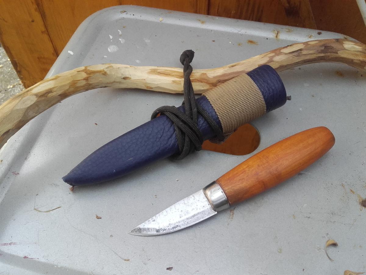

So sorry Joe, I snapped a trusty old Mora a few months ago so know this horrible feeling, I hope you can bring it back to life,I brought my Mora back with a few alterationa

Good save on that Mora.
