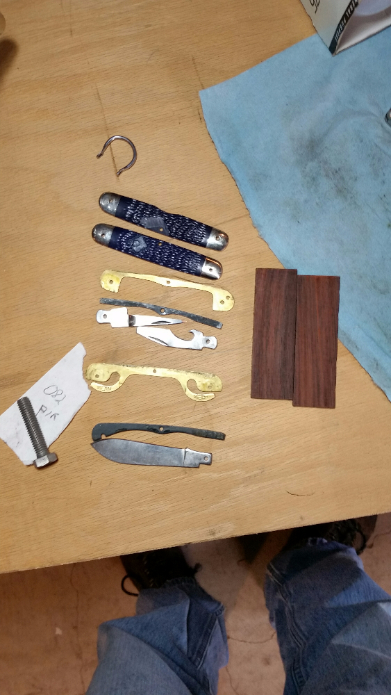

Got a minty old Camillus cub scout knife here that had the standard blue plastic handles. The shield was apparently too hot when it was inserted into the handle because melted plastic was smeared all over the top of it, and globbed on the sides. Cocobolo was the requested handle choice. Here are some WIP shots (as usual I forgot to take a before pic ::dang:: ) :

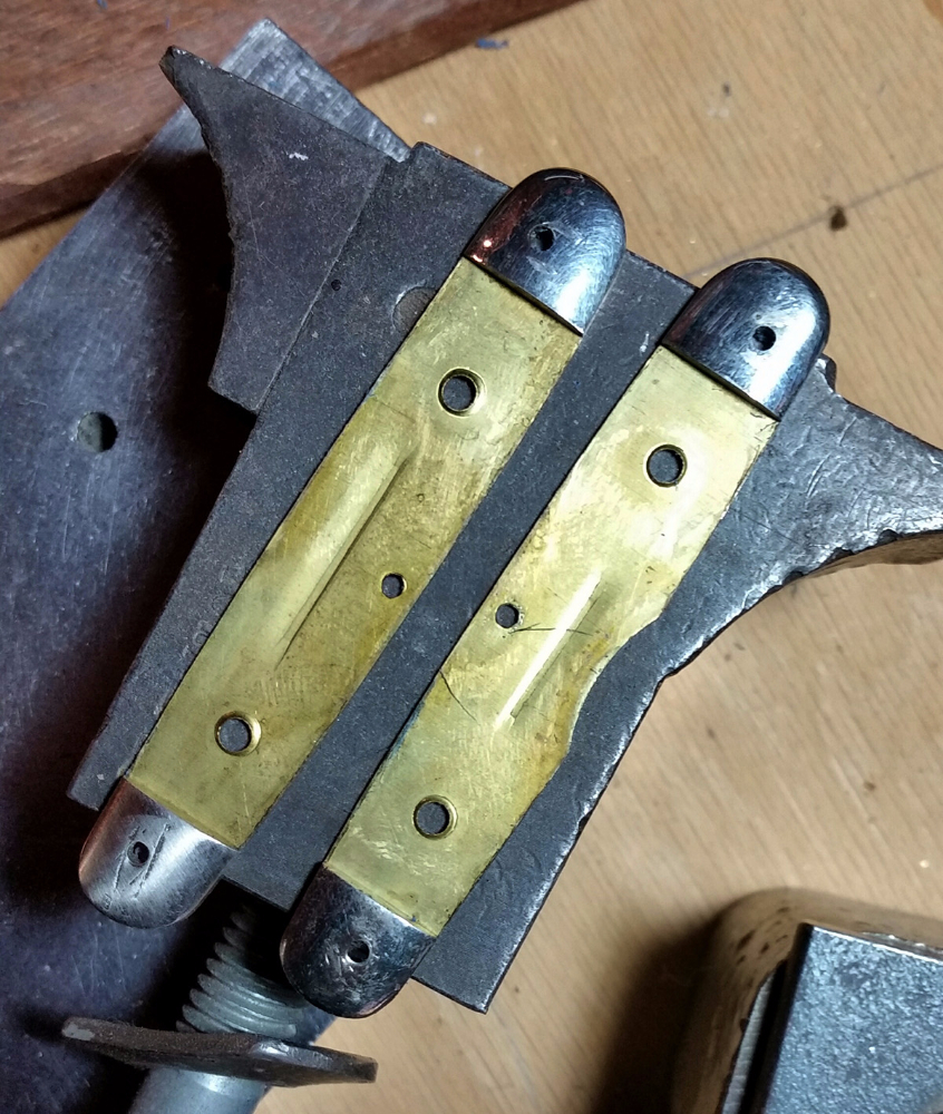

Here's the knife disassembled, forgot to crop the pic, glad I at least remembered how to take the knife apart lol!

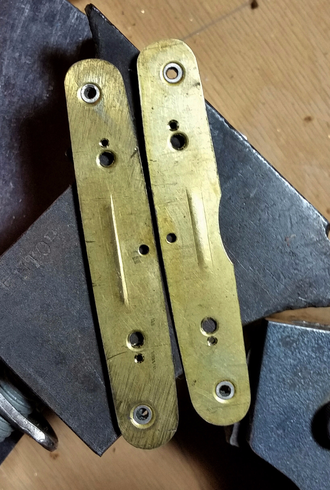

The pastic handles have two plastic tabs that are inserted through the holes in the liners and melted in place, kind of like a plastic rivet. The holes are WAY too big for standard cover pins, so I re-drilled some new holes as seen in the next pic:
Here we have the new cover holes, countersunk and ready to go

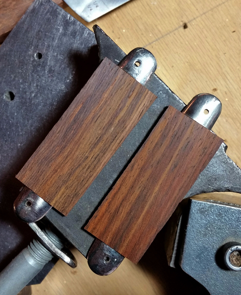

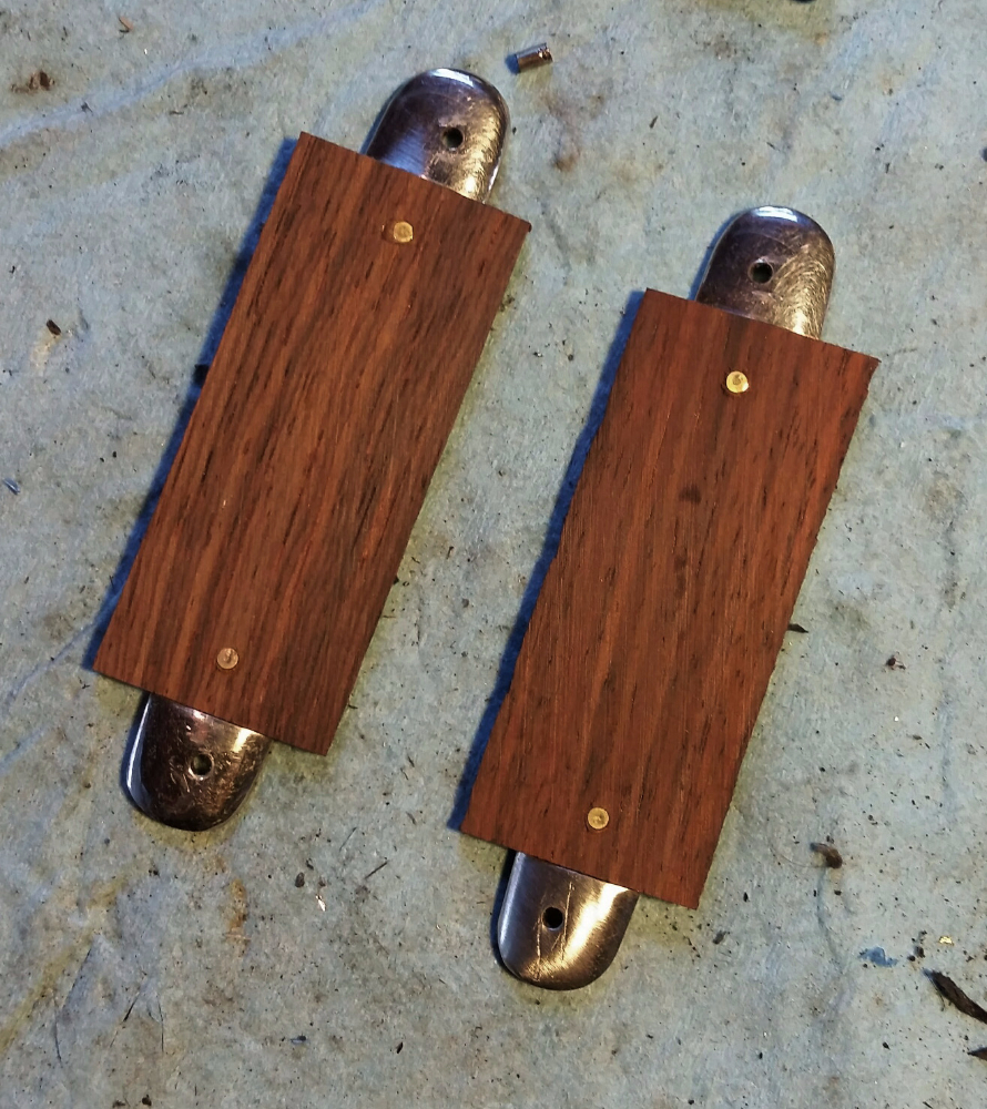

Handles are cut and fitted, ready for drilling

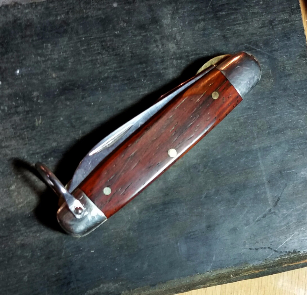

Handles are pinned on, now I have to trim them down a bit and finish the front edge
Sanded the pin heads off, front edge is finished, center holes are drilled

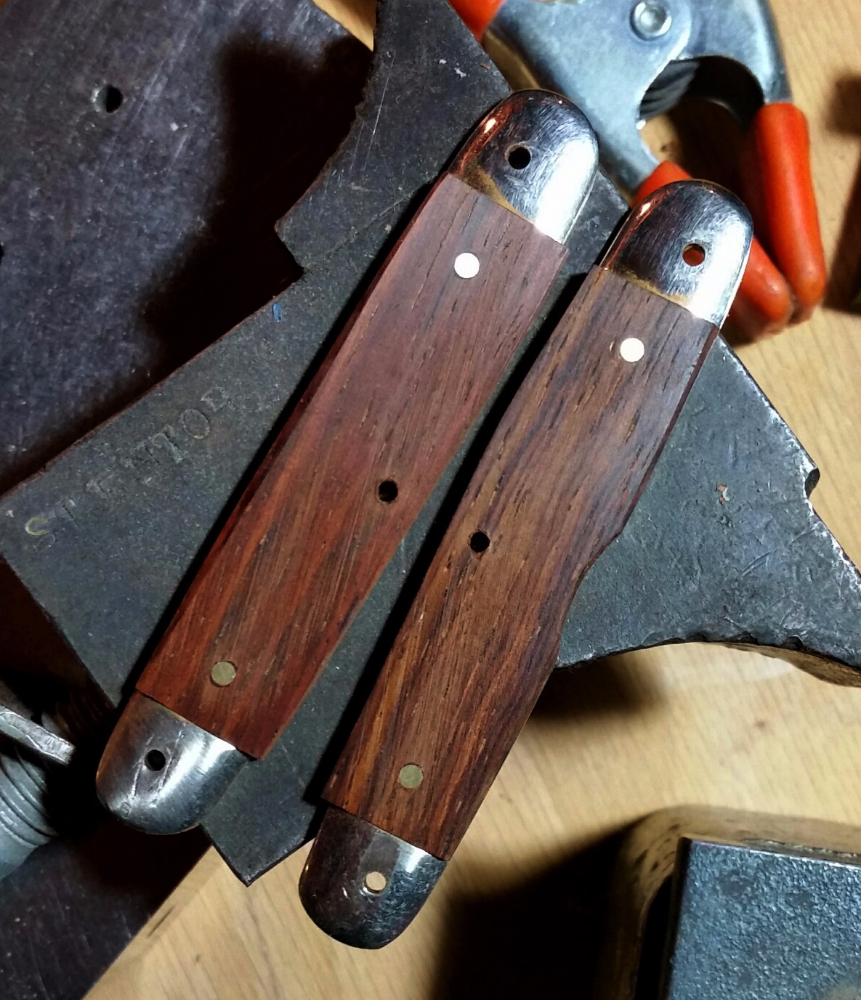

The unusual thing about this knife is that the bail pin also serves as the bolster pin. Once that's attached there's no wat to finish that end of the knife, so I had to glaze the bolsters and polish everything up on that side before assembly. Never did this before so hopefully it turns out OK!

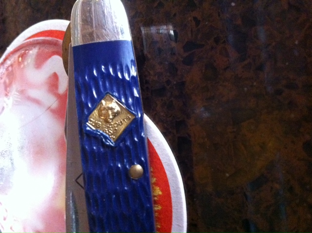

Here is a before pic of the sloppy shield.

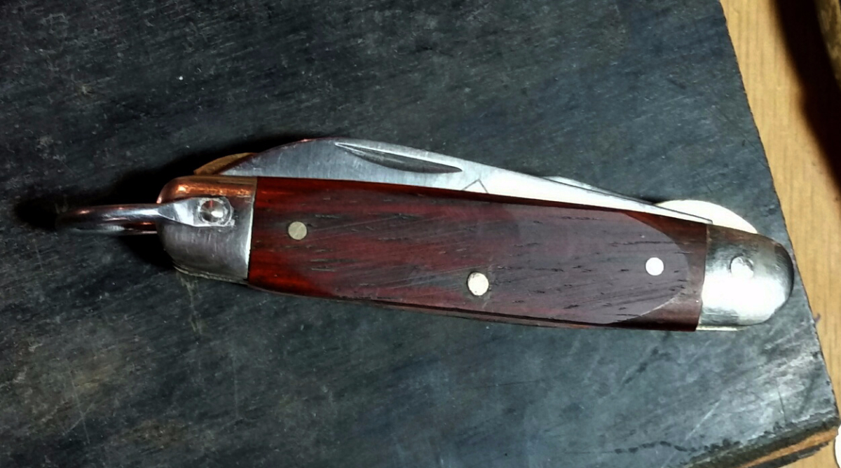

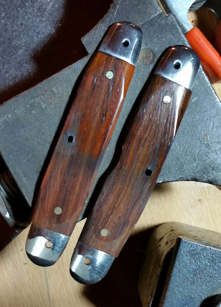

Got a bit further today:

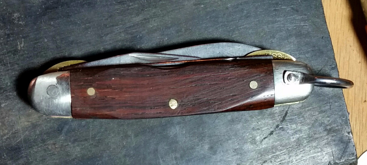

Got it together and pinned up/spun up.
Sanded everything down, glazed the other bolster side and immediately ran into problems. The bolsters in that side actually had a backwards slope, likely due to matching up with the factory handles. In order to be flush with the new handles I had to glaze down to that point, which cut into the handles deeper than the shackle side. This makes that flat center section totally uneven. Worse on the pile side. Now normally all you do is take a bit more off of the shackle side to even things up, but since the shackle is already attached that's impossible. Really not a big fan of this setup, I may just knock it apart 'cause it really bugs me.
