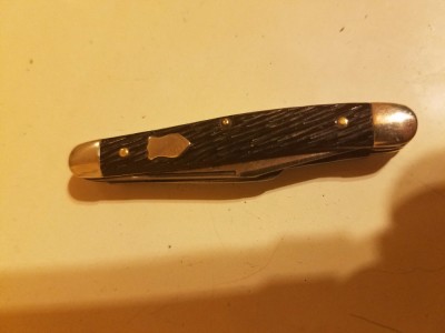

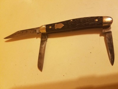

Anyone that can give this newbie any information on this nice little Schrade Walden I would be grateful. I'm not even sure if the pattern. It's a three blade under three inches long with hugged black Delrin handles and has the number 808 on it.

The 808 is the pattern (small stockman). Your example, if it has Delrin handles, was made from 1960/61 through mid 1973.

What tongueriver said is correct. It looks like this knife has "rough black" peachseed handles, so it should predate delrin handles by a little and appears to have pinned bolsters as opposed to swinden. It's probably older than 1960 and no older than 1947, but I really can't say for certain. I have quite a few of these little stockmans, I like them a lot. Does it have milled liners on the back?

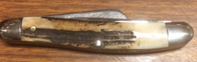

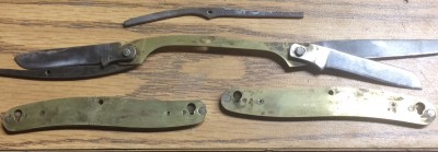

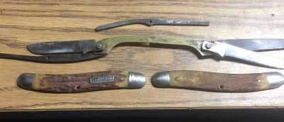

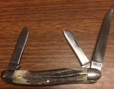

KJ I was like you about the Swinden system and not being able to tighten blade play. I have figured out that if you cut the center pin and take the knife apart and clean it good, put the knife back together. Most of the time you can take the play out of the blade. At least that has been the case with me so far. It is a little more work than tightening up a pin through the bolster knife but I have been happy with my results. In fact I just recently took apart a Craftsman medium stockman that the main blade had plenty of wobble, put new scales on, and when I put it back together it tightened right up. I will post a couple pictures.

That looks mighty fine to me, congratulations on a good job!

Those handles look great Ed.

Ed, I see that you do not drill out the Swinden system, and replace the pins (as many guys do).
Are you "tweaking" anything like hammering the liner flat or peening that keyed pin just a bit?
I'm asking because I have not taken one of these apart yet, and there are thousands of them around. Mechanically I would have to say that tweaking these just a bit would make for a solid/like new knife. Maybe better than new.
Nice choice on the scales by the way. I like that you stayed so similar to the original but still added some character.

Thanks Treefarmer, Keith, and Ken. As far as tweeking the system Ken I have not had to yet. I clean the pivot pins and between the blade tangs really well and clean the key hole. I have a tool like.....well it is a dentist pick. I take that and clean out the key whole. Then I flush with Gun Slick gun scrubber I am sure that it is like the Casey’s gun scrubber. I have had great results with the Gun Slick version. No adverse effects on any handle material yet. I know everyone or almost everyone uses Quick Release oil. I discovered Coon P it is a full synthetic lubricant that is sold through SMKW. After a good clean and flush with Gun Slick I put a drop of Coon P and it actually helps clean the joints. It pushes grime and dirt away from the joints. So I work the blades, wipe, repeat until the oil is almost clear. Then I blow it dry and put a final drop of oil in the joints. I hope that helps Ken.

Ed, did cleaning it as you have described get rid of the blade play ?

That's what I am wondering...kootenay joe wrote:Ed, did cleaning it as you have described get rid of the blade play ?
kj
I can see debris collecting on some portion of the system between moving parts, and off-setting something. Old oil or just plain dirt acting like a teeter totter effect...
Perhaps there is a set amount of spring or give built into the shell's key-way, and just cleaning it allows that action to work?

KJ and Ken yes the knife was tight as new when I put it back together. Great walk and talk. Zero wobble. So far every swinden knife I have taken apart ,after cleaning , when I reassembled them they where tight and nice. May I run into one that gives me problems....mmmm yeah probably but it has not happened yet. Knock on wood. Thanks guys.
