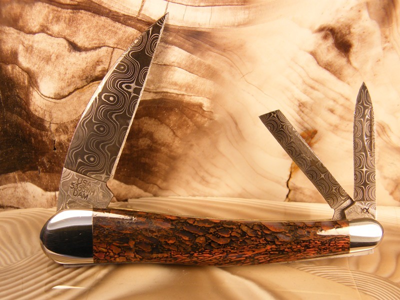

Drop dead gorgeous... I hope it is alright to post his image.

Great looking knife ,the link was very informative and cool to see guys for the interest and help.

Most of what I do daily is setting lines in repairs or new builds (boats). There are two ways to KNOW that your line is straight/uniform. First is by feel. You can feel things that the eye can not see.
Second method is reflected light.
Light does not lie when it come to flaws.
Looking at that knife in the image the light is dead even across the stone, and the bolsters. If there is a flaw in that knife, it certainly is NOT in the finish.

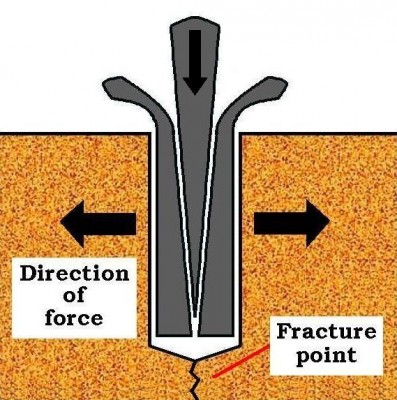

Stone is split or cut using feathers, and wedges, and peening a pin is virtually the same process.
There are softer stone samples to use but still... It's got to be on top of the list in difficulty.
