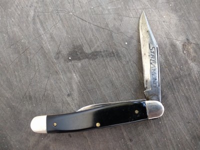

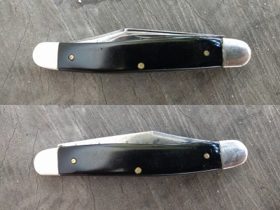

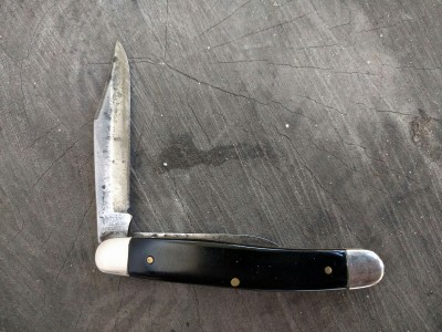

The only Streamline I have is a 4-line large serpentine jack under Camillus's Sword Brand, and it has smooth black handles but I do not believe them to be celluloid. I love the deep stamp on the master blade. Here it is, since we love pictures here:
The general rule is that any celluloid knife can gas out at any time, but the 70s-90s German cell knives are particularly prone to it from collective experience, while in most cases the older USA celluloid knives seem to be stable when kept under decent conditions. It's best to keep your cell knives stored away from the rest of your knives (or, in fact, anything you don't want near corrosive gases) just in case.

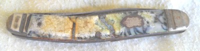

A picture is worth a thousand words.

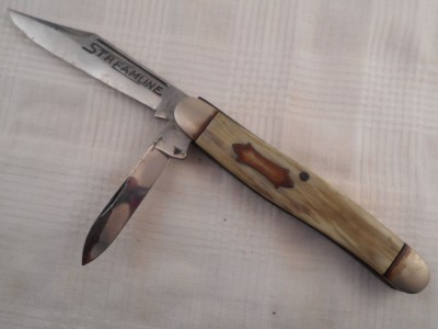

So this one on eBay is it any good? This is on EBay
m.ebay.com/itm/Camillus-Streamline-Two-Blade-Pocket-Knife-Sword-Blade-USA-VINTAGE/122425949095?hash=item1c8127bba7:g:j-QAAOSwhlZYseVB

Man Jerry, your pictures of off gassed knives are worth at least ten thousand words.

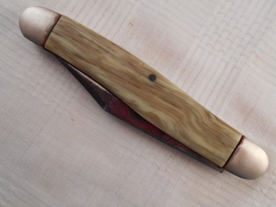

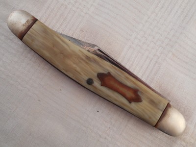

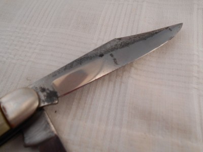

Judging from the discoloration of the cell, the corrosion on the shield and bolsters, and the start of that "line of rust" you can best see on the pile side of the master, I'd say that particular knife is either gassing or was stored near a gassing knife. It's not as severe as some of the scenarios pictured above, for sure, but there are definitely signs of gassing -- and they aren't always visible. If the liners get the worst of it, the knife could come apart during use. If that knife is gassing, I'd say make a very cheap offer and see if you can rescue the master blade. IMO for a parts knife it's not worth anywhere near $45 but I'll bet glennbad or Dale could make a seriously cool single-blade out of it.LesPaulGuitars wrote:So this one on eBay is it any good? This is on EBay
I"m starting to wonder if my Streamline was a rehandle. Did they make 'em in standard smooth black comp?
I have a saved search on eBay for Streamline and get several hits per week. All I've seen so far have those greenish/creamish Celluloid handles and at least 30%-50% of them have started gassing.

I bought mine completely unaware of that style cell or its reputation. Think I managed to get the best of all possible worlds even if it's a rehandle -- gassing on my wonderful ~75 year old knife won't be a concern and the knife is tight and feels right in hand. It's an excellent user and this information about the cell means it's only going to grow scarcer going forward.
But now of course I must hunt a cell Streamline down...

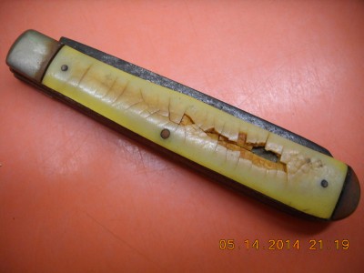

I grabbed some of the photos from that ebay listing for the forum -- I think everyone will agree it's time for those handles to come off (and perhaps some new liners).
